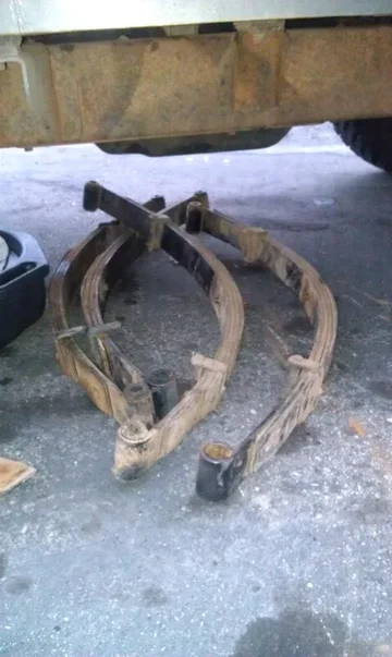

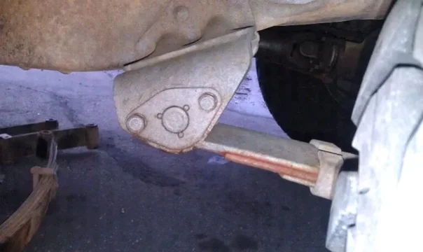

So all the bolts loosened up just fine should be real easy to swap springs. My partner I'm crime was singing too. Thanks Kurt for the U bolts I needed
Big Time!

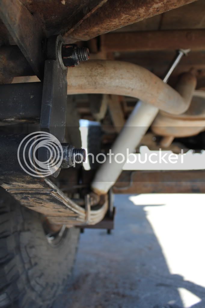

So now its time for some fun and hard work! I'm still missing a couple of nuts ha ha ha and need to clean up a shackle bolt so I can get a nut on there and I'll be ready to torque them down.

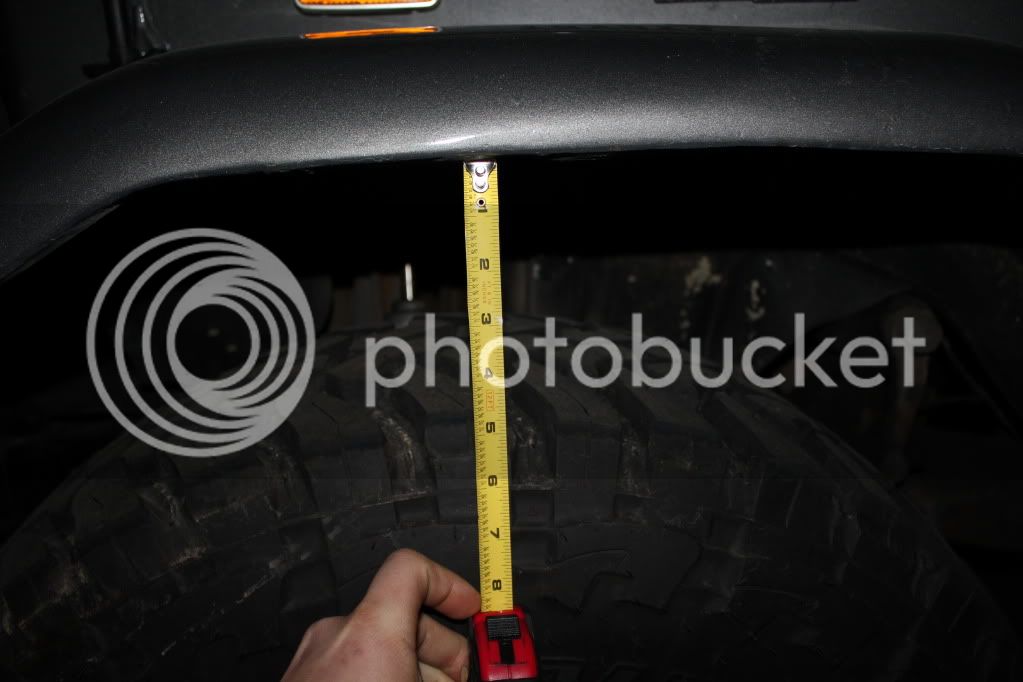

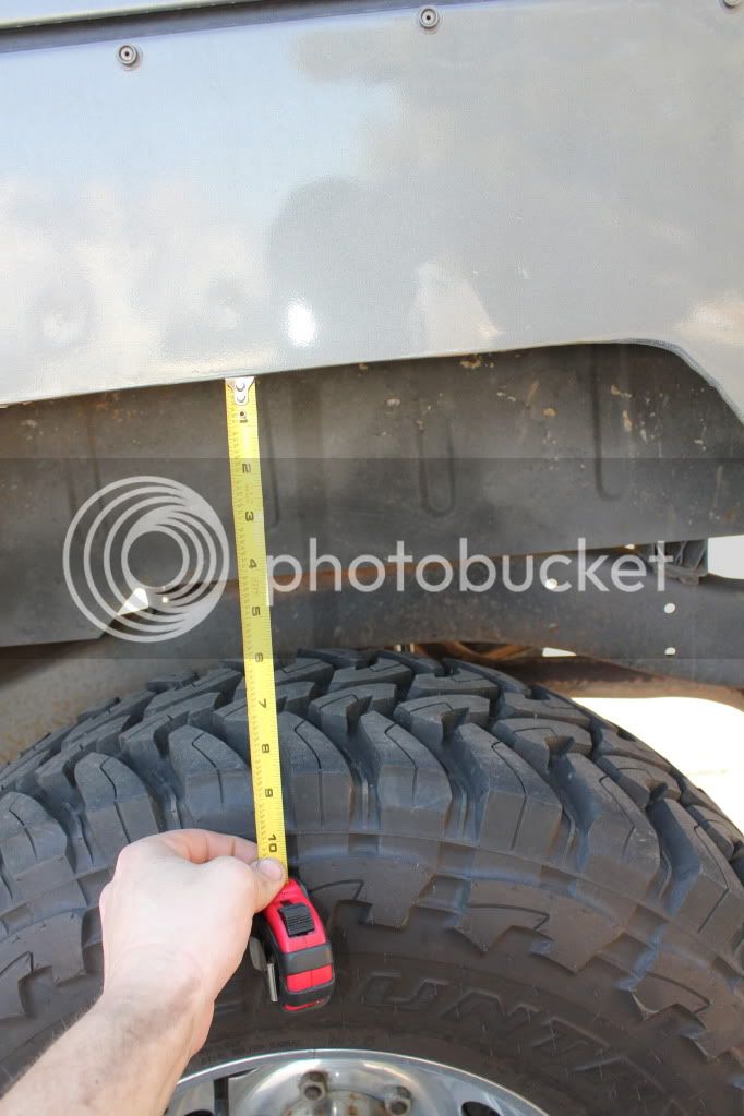

So here is a before and the measurements.
I had very little up travel. and my shocks were limiting me as they were for a 4 inch lift and I had just 2 inch shackles.

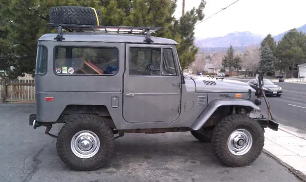

Now the after!
So much more travel and super flexy. Shackle angles are great too! Caster improved with the front as I went to stock shackles and kept the 1 inch longer confers out rear. I like the stance.
And now my family and support staff.
Total lift up front is 3 1/2 over stock and rear is 4 1/2. Super happy!
