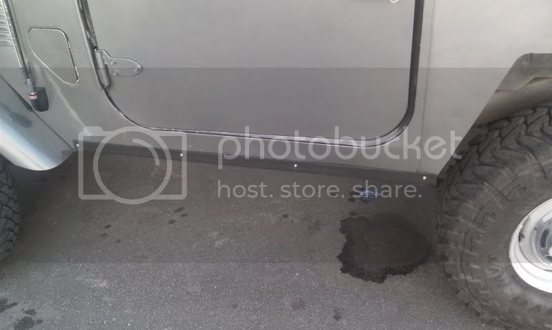

On a good note heres my sliders installed!
