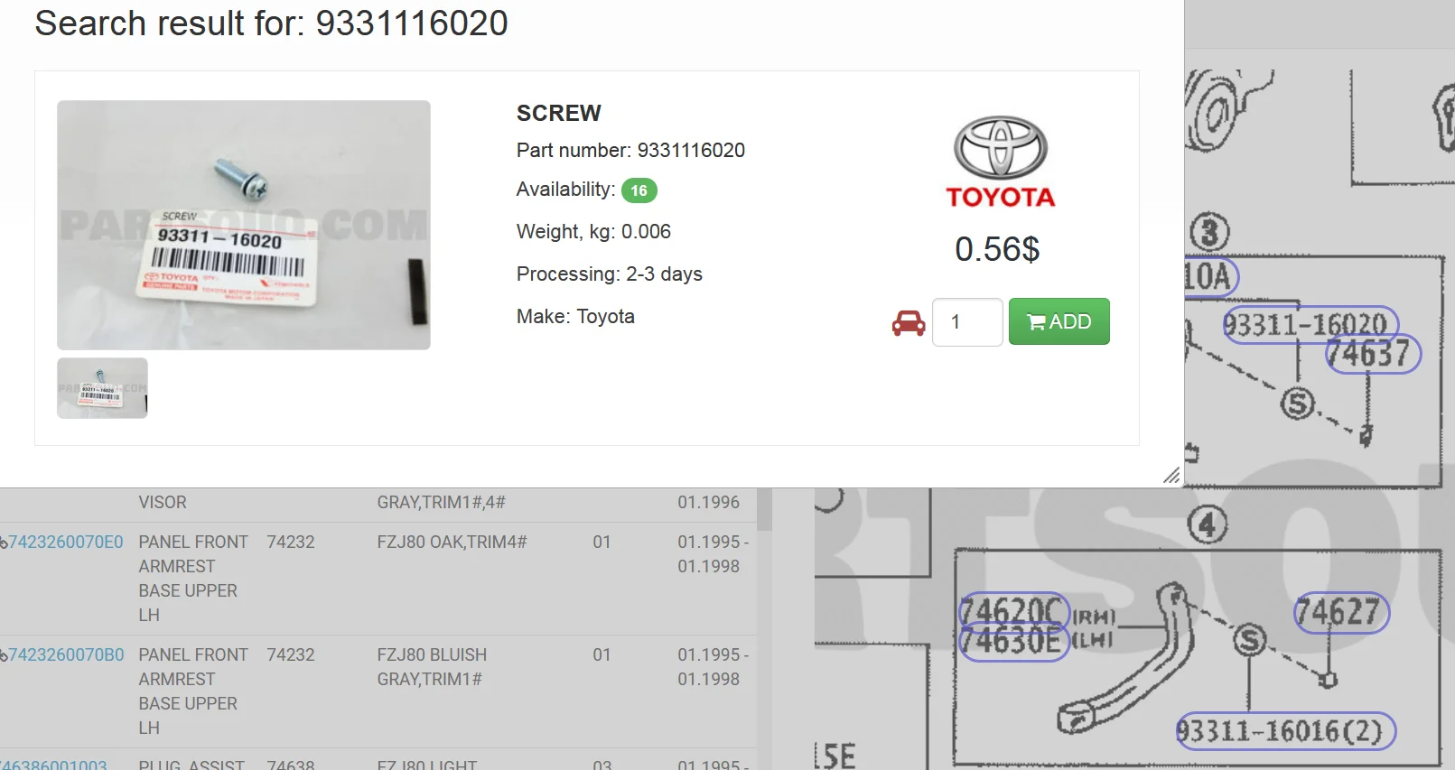

I managed to strip a grab handle bolt while troubleshooting a clogged sunroof drain tube. Anyone know the bolt size? I can always stare and compare or dive deep into the Partsouq bowels, but figured I'd ask just in case. :)

M6

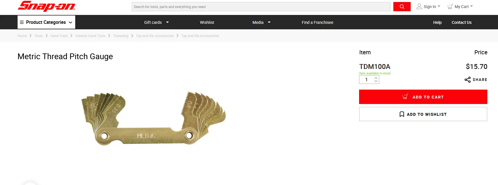

I'd recommend investing in a metric thread pitch gauge, they're very handy. I've had mine since I was an apprentice machinist and I use mine almost daily. I have this one, but any similar one will work just fine:
FWIW, I hate those screwdriver slotted screws in the grab handles, and every other load bearing application. The last two numbers in the part number are the length, in millmeters.

Excellent! I learned something today, and it's only 8:30. :) Definitely will pick up that thread pitch gauge.
