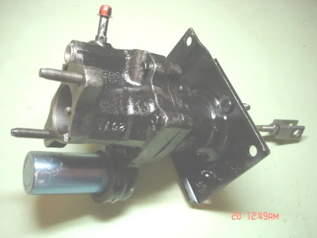

Haven't bought them yet - gotta do one mod at a time ;p I sent off my hydroboost unit to Vanco last week, so he should be finishing up soon :bounce2: Next big purchase will be the hydro steering system from PSC, then the knuckles will be last. I got my panhard brackets cut out & will be posting pics of it mounted soon.......

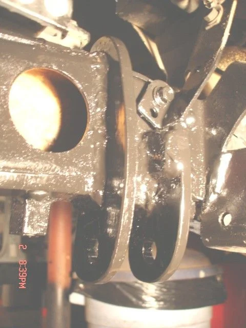

Panhard Mount Done:
I tried to use as much bracket to frame contact as possible, even took both brackets thru the frame & welded from the backside. This should do it ;p

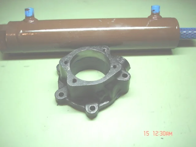

I've know I've been slackin on the 40 but full throttle on the :pig: I've knocked the first 3 items off the list so gimme a break :flipoff2: ;p I have sloooowly been accumulating the rest of the parts for my brakes & steering. Now I just gotta plan some time for the install. I got the Vanco hydroboost unit, PSC ram & had a machine shop bore out the speedo housing for a stock dbl. seal. Don't know when I'll get back on this, but I do plan on wheelin' late summer or fall :rolleyes:

My hi-flow P/S pump & PSC steering gear arrived so it's looks like I'll be :wrench: soon. I'll have an AGR Super BoxII steering gear & pump for sale if anyone's interested - good for tires up to 35" :doh: Next up will be the $ix $hooter knuckle$$$$

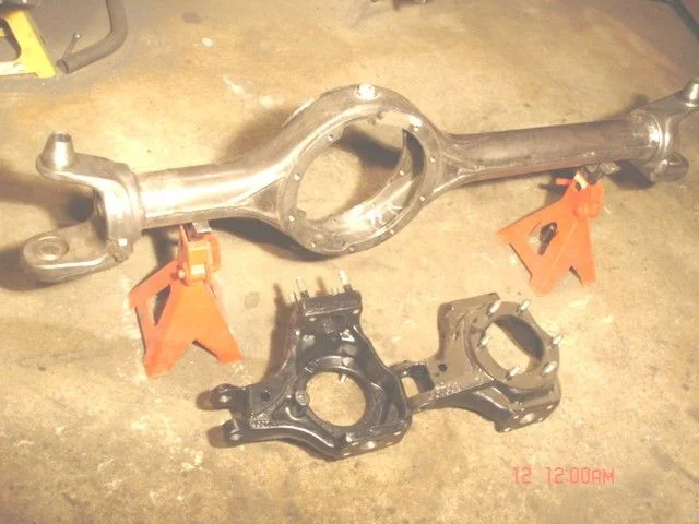

Nutha Hybrid Front Axle

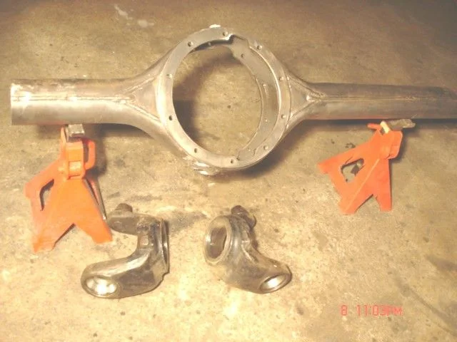

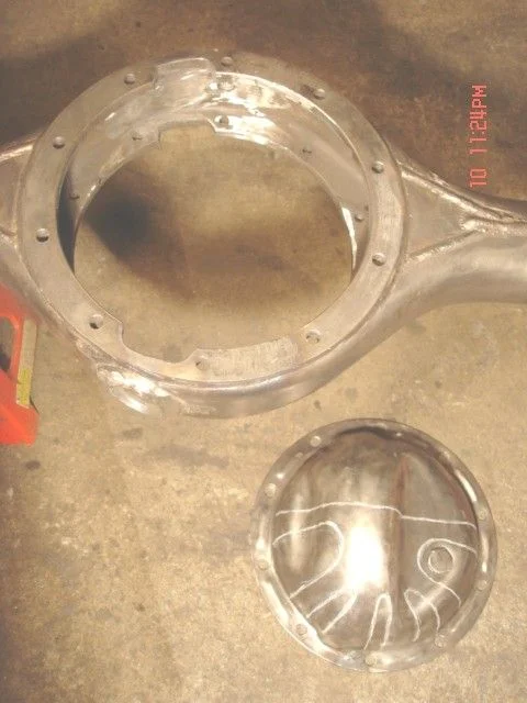

I decided to bypass the :pig: today & give some luvin to my 40 ;p I picked up this REAR 40 housing from Mister Larry Downey last night & just had to get awn it. Got the ends cut off, relocated the diff drain to the bottom, patched that hole, & located a housing vent @ the top. Next, I'll relocate new slots where the ring gear passes thru the housing, on the opposite side, & patch the old slots. Then, I'll grind the ends a little to press on the Ebay D60 inner C's. After that, I'll reinforce the top & bottom housing w/ 2 X 4 X 3/16" wall square tube cut in half. I'm building this hybrid almost exactly as the one I fabbed for my :pig: Right now I'm not sure if I wanna go 35 spline cuz that means $$$. I'll reuse my RD02 ARB w/ 4:88's. The diff cover will be reinforced, similar to the Dynatrac style cover. I'll go w/ 4340 shafts so I don't lose any strength compared to the 30 spline Longs I'll be selling later.
Is the rear axle the same width as the front? Don't you want to go wider then just stock width if you were using spacers before?

Chuck,
This is a minor point in such a project, but how did you clean up the housing to raw metal so quick?

That was the easy part - 4" dia. knotted wire brush on a grinder. Blowing out the stuck center pin w/ my plasma & trying to salvage all 20 studs was :bang: <Bill Murray Voice> I think the Cruiser Gods were teaching me a little bit of a lesson not to merge LC stuff w/ Dana parts :doh:

I trimmed the outer housing ends to fit the inner C's. I paid a machine shop to turn down the ends on the one I built for the :pig: Money wasted :doh: It was pretty easy - 15 min. of grinding & whack 'em on. I set them w/ my angle finder, turned up the welder way high & burned 'em in. The D60 knuckles I'm using below are modified to run dbl. shear 3/4" cromo heims:
