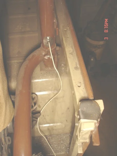

I finished up the brakes & clutch bleeding. I realized I needed an overhead interior light, so I found one & fabbed a bracket to install it to the rear of the cage. I ran the wiring thru the tube & also made some caps for the area, at the rear of the door jamb, that the hardtop poles slide into. I discovered some standing water inside the cage when I was drilling for the lower wire exit spot, so I drilled up from the bottom to drain it all out. That black water was nasty :eek:

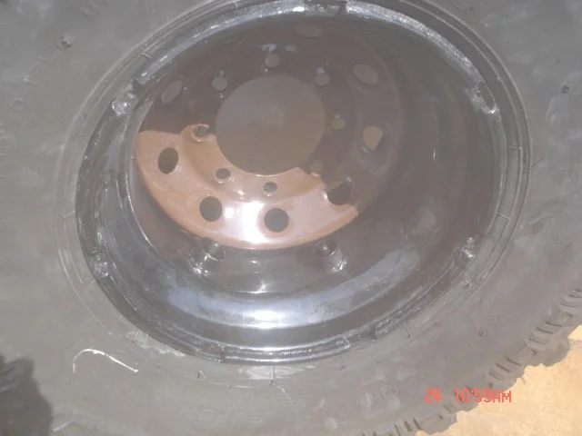

I finally bought a set of used Staun beadlocks. I prepped the wheels (drilled & chamfered access holes) & dropped them off at 4 Wheel Parts so they can finish the install. Hydro hoses, lockouts, & custom inner axle shafts should wrap up this rebuild. Driveway pics to follow....:hillbilly:
I picked up my wheels today w/ the Stauns installed :bounce: I'll be buying some 3000 psi reuseable fittings & hose for my hydro lines this week. That way I can custom make them to length & make my own trail repair if needed.

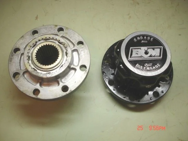

A couple other items I needed to take care of was adding a flex hose to the exhaust. I didn't think I'd need one but after having my gasket crack at the header collector, I figured that was the cause, so I installed one. Second thing was the locking hubs. Since Superwinch discontinued the locking hubs I use, I thought I'd better have a backup set for the :pig: So, I removed the Superwinch hubs & picked up 2 new sets of Selectro hubs. I got them for a :smokin: deal. They just have another name on them.
