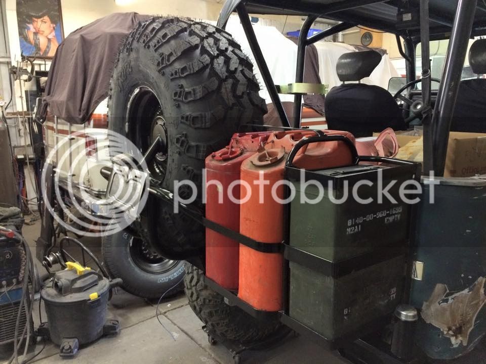

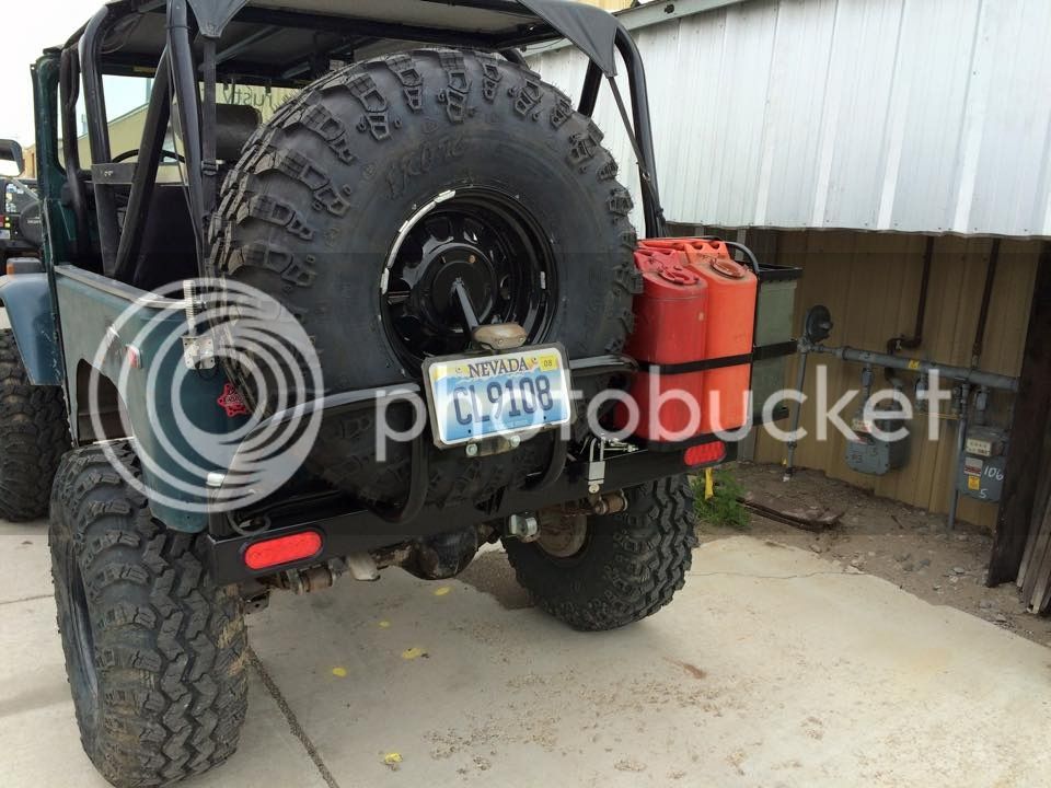

Progress today, Dr Smash had time to work my tire carrier in.
This is the same guy that did the bumper/swingouts for my FJ60.
Beat the bejebsus out of that bumper. Can't wait to see the bumper he builds for Ol Rusty
This guy is super creative and pretty much everything he does is a one off built specifically for you. I am so glad I didn't buy a production unit that would have looked like almost everything else out there.
I really like that swingout design as well. Basket to hold the tire up while you line up the lugs. That's a damn good idea.
Looks like there's a stopper on it too resting against the bumper in the closed position for additional support if it gets bumped. That would be a great place to mount the license plate or a something. It could act as a minor slider coming off big steps.
No lugs, a single spin on center nut, like a desert racer. The swing outs lock with one padlock and nothing can come out when they are closed. The center post on the tire extends far enough that even if someone removed the nut they couldn't get the tire past the post with the swing out locked.
The licence plate will be mounted inside the spare. It is the OEM holder with light, Eric dug that I wanted to use that. There are a couple of HMW plastic pads that act as anti wiggle mounts. Similar to the system he used on my FJ60. The draw latch compresses the guides against the HMW plastic. The 60 set up never rattled.
