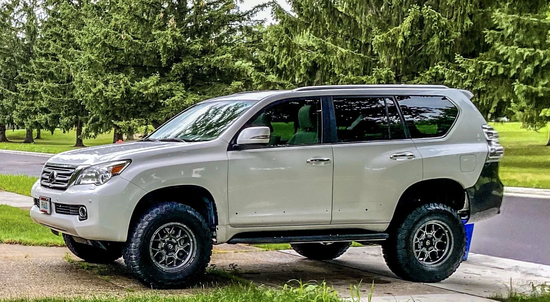

Did you do a straight axle swap up front on your 4R? Or is it a body lift? That thing is massively high!
Also, about the "SURF" on the side? Do you surf the great lakes? I've heard about it and even seen some video, but I don't think it can ever get as good as my back yard. (San Clemente):D
2" Body lift couple with the Toytec Boss up front. I need to downsize on my rear springs.
Haha! I'm just big on JDM and sourced a lot of parts to mimic a Japanese model Surf. And no I haven't had a chance to surf the Great Lakes yet lol!

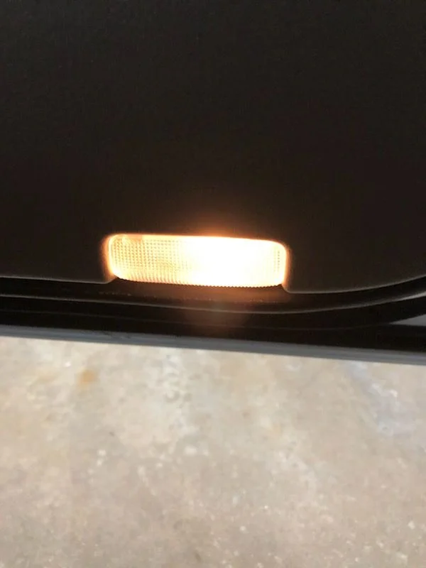

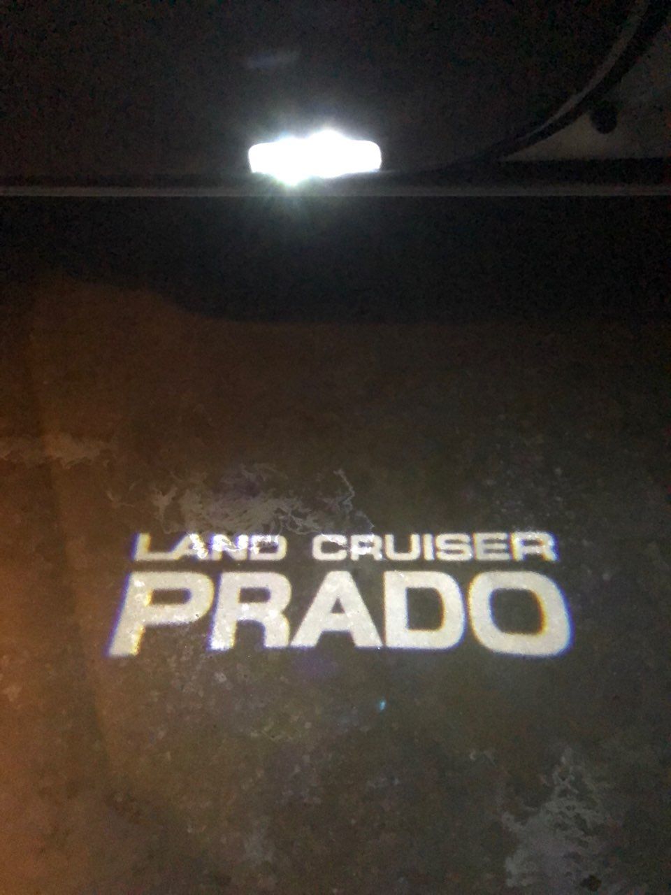

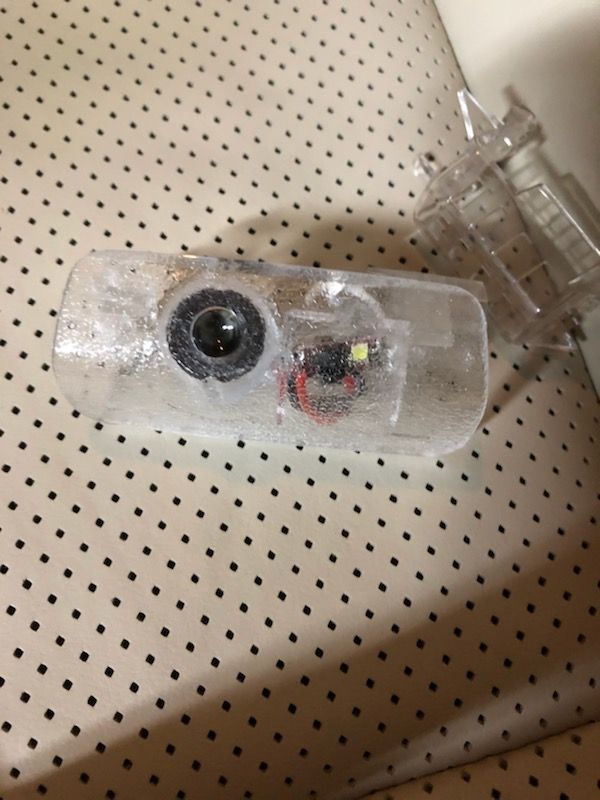

Prado Insignia lights:
Broke out the dremel and heater and started with my door lights. So I purchased a set of Prado insignia lights off of Yahoo Japan. Not sure why but they weren't a direct plug and play but using the dremel I was able to remove a piece of the plastic housing and install without issue.

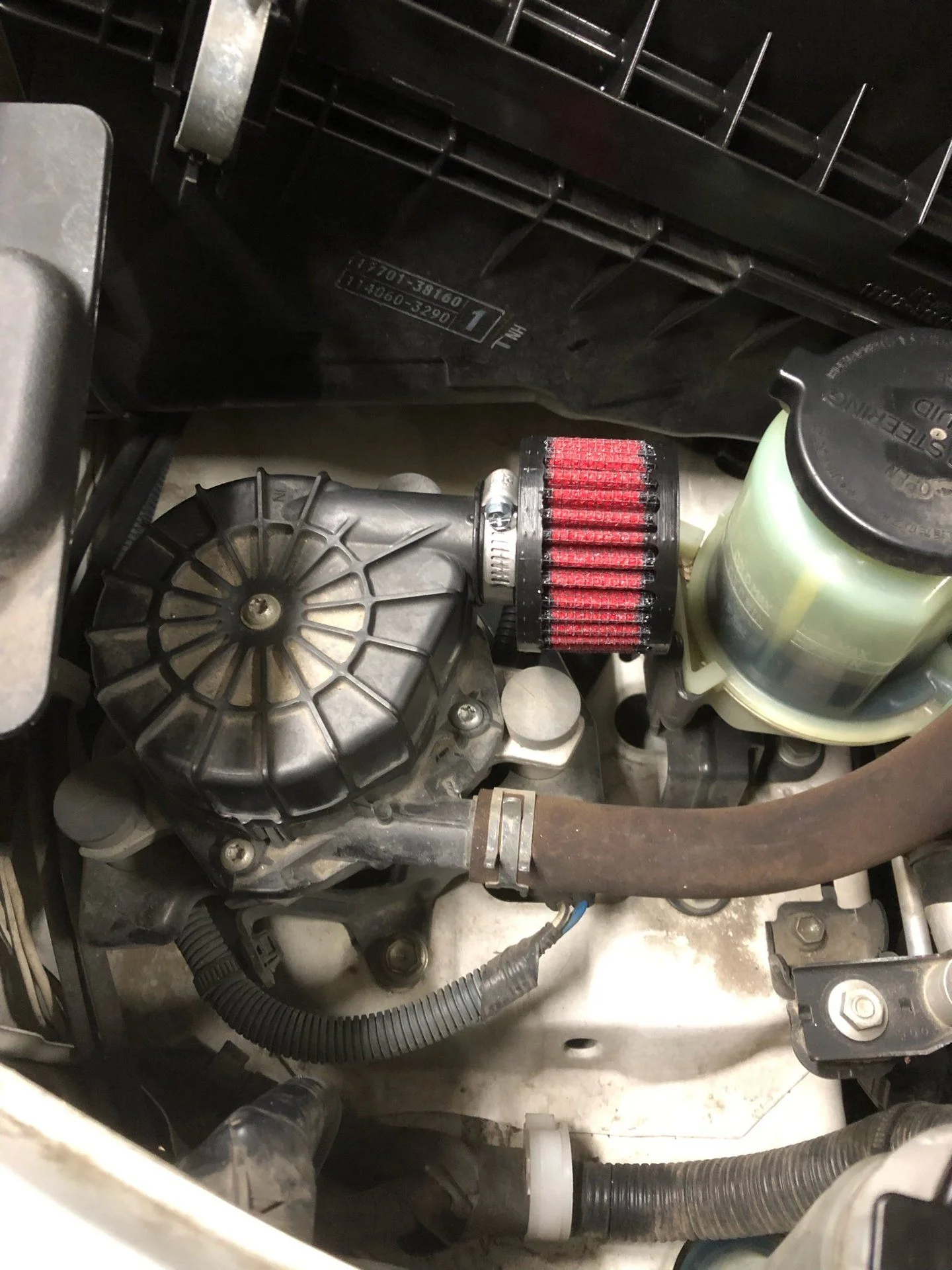

What is the top picture of with the air filter? is that the in cabin fan and filter, seat cooler fan?
What does that fan go to?
Thanks! Curious why there is a secondary air intake, especially since I have a snorkel. I'll have to check under my hood and see if I still have that. On this rig, I had someone else install the snorkel. I wonder if there can be water intrusion through that secondary intake?
Maybe I need an second snorkel! :rofl:
Haha!
:rofl: all joking aside I have read that some have ducted the secondary air injection intake into the airbox to keep water from getting into the pump. If you think about it the pump is only running upon startup and shut down of the vehicle. So if you aren't planning on starting while its submerged you should be good. I have done the filter mod just to take the risk out of it getting the media sucked into the intake. A buddy who has a 2011 and he just had one of his valves on the manifolds crap out on him and it put him into limp mode. This really bothers me... I would hate to be in the back country and have the system fail and disable the 4wd system and put the truck in limp. I have been talking with Hewitt and they should have a 2013-2014 option available for the SAIS bypass and pump removal system.
HitchCrack
Thanks for the info HitchCrack! I will probably never submerge my rig to a depth where that would be able suck water. At least I would never do it intentionally! :crybaby:

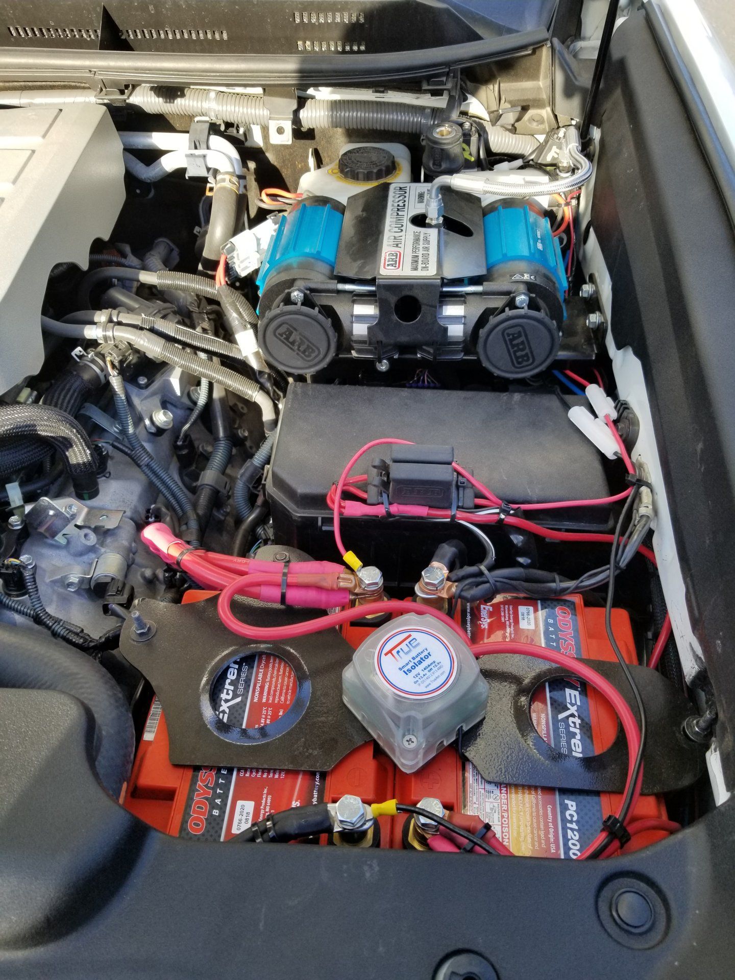

Going a wee bit off post, since I was not able to find a dual battery case/bracket/?? for our GX's, I had Eric Hansen at YotaMasters fab one. He said it took about 3 tries for them to get it right but it looks good! Although I can only use the Odyssey PC1200 batteries, but those have been my battery of choice for my last three overland rigs anyways.
Looks good R2M, I am hoping to get two of the 34R-PC1500T. The Amp hours for each of your batteries is 42Ahr which gives you a total of 84Ahr for both if you were pulling off them at the same time. On the batteries I am wanting to use a single battery gives me 68Ahr each for a total of 136Ahr. Thats quite a difference. I am glad you were able to find a solution there are no drop in ready kits out there in the market right now.
