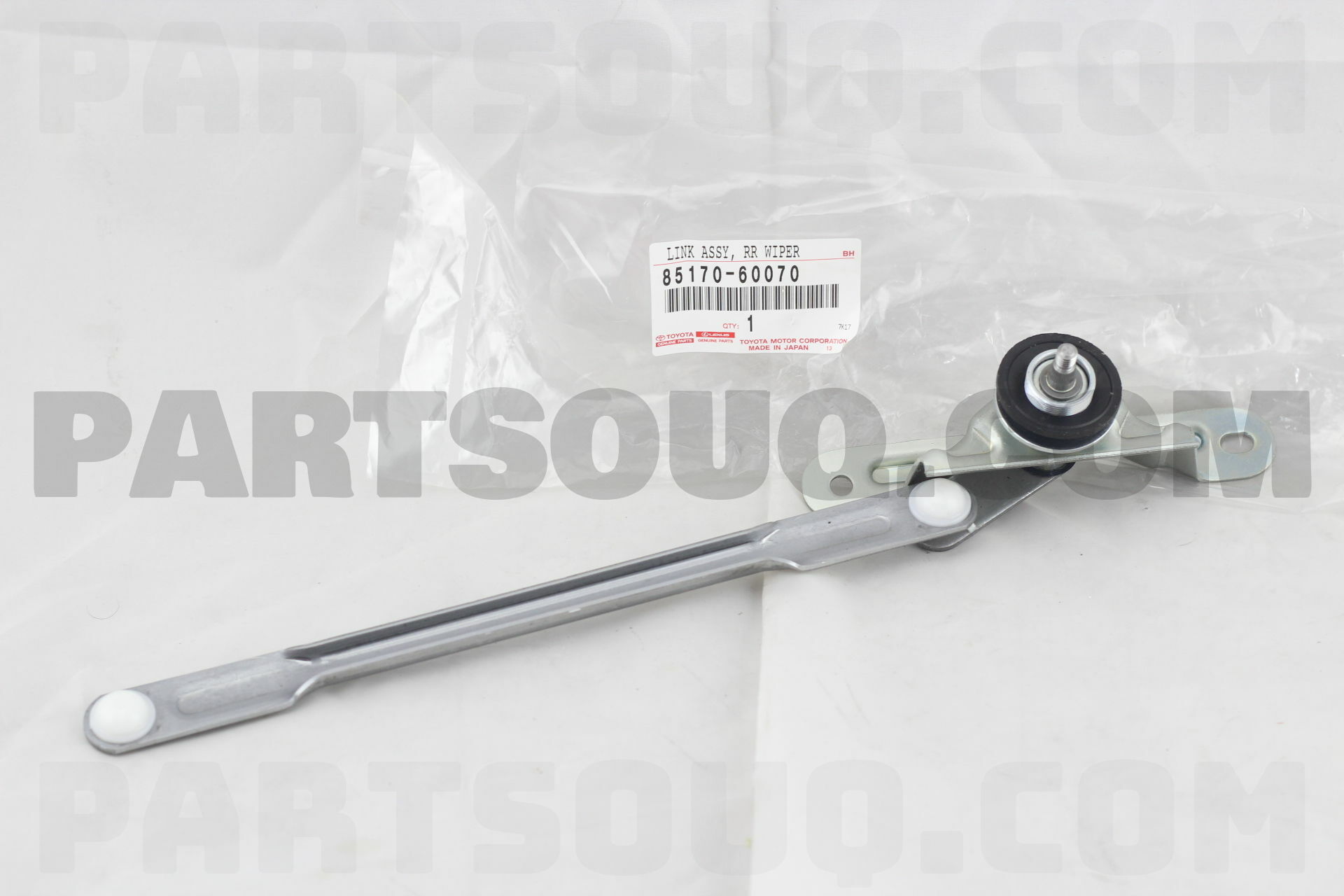

still can't figure mine out,works with hatch up not down..........
That sounds like a broken wire. The common droopy wiper is caused by a worn bushing allowing the linkage arm to fall down onto the steel pin. Annoyingly, you can't buy a new bushing from Toyota, but I think the whole linkage is around $50. Part 85170-60070.
You can try removing the wiper arm and reinstalling it in the proper place. It takes two minutes and worked like a charm on mine.
