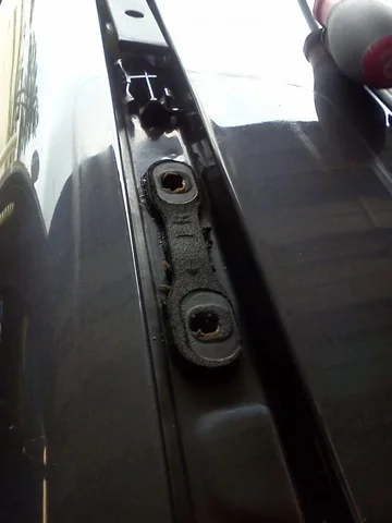

Here are the rubber seals that were under the stock roof rack. To me the directions were not clear whether or not you should remove these but in my eyes it made since to remove them.

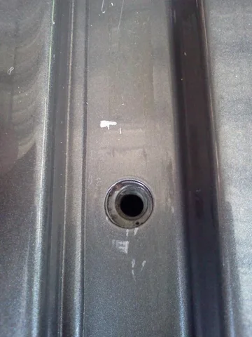

Once removed, I cleaned the epoxy/glue off the best I could, particularly at where the new seals were going. I wasn't sure what I could use to remove the glue without jeopardizing the paint so I just used soap and water with a lot of elbow grease.

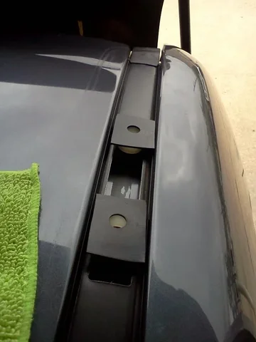

After cleaning it the best I could, I re-installed the gutter trim. Then I put down the first rubber seal as the directions indicate.
Followed by the plastic spacers.
And then another rubber seal.

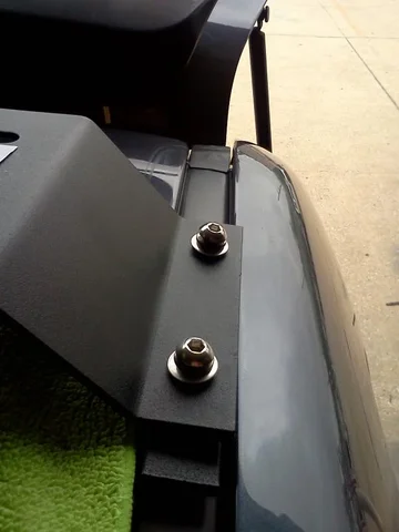

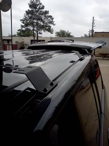

Next carefully set the rack on the mounts and bolt it down.
The final step is to install the wind shield and enjoy.
