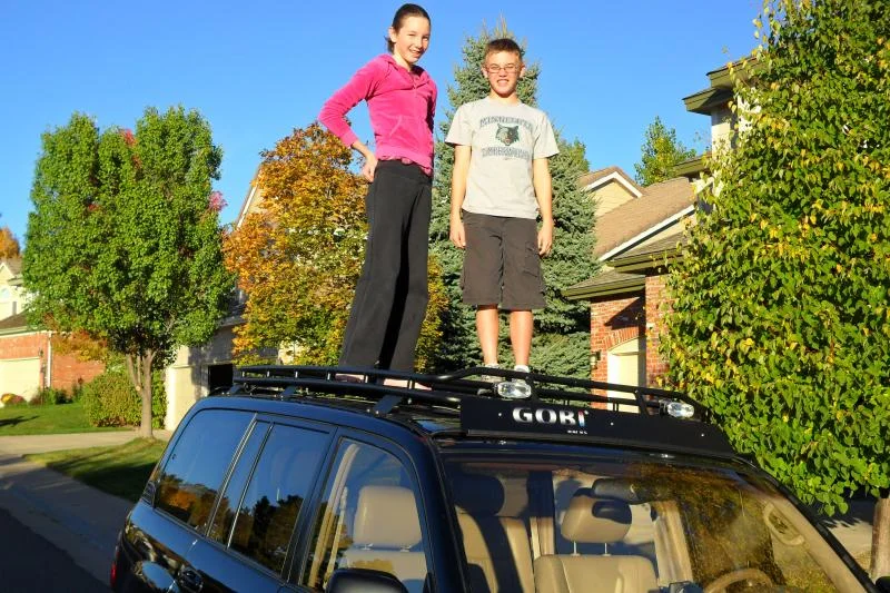

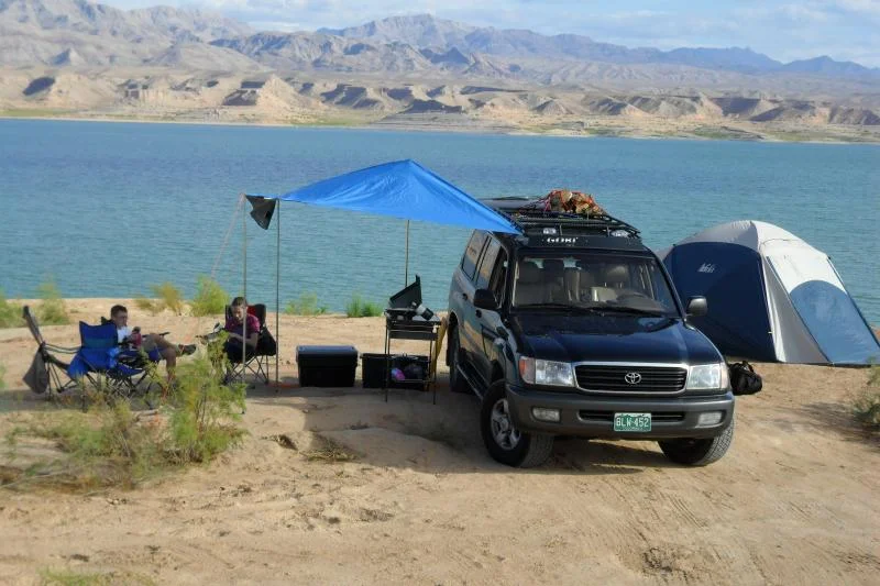

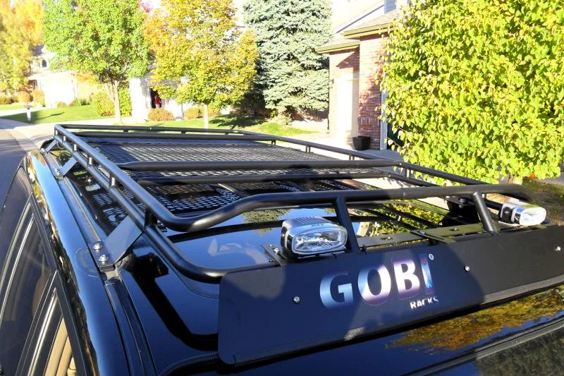

    I wanted to share with you some photos of my new roof rack designed and built by GOBI. Paul Badillo, the owner, is great to work with and builds a very high quality product. While not totally complete yet, he got this new prototype built for my 100 series, in time for me to take it on a 2,800 mile road trip from Denver, through UT, NV, CA, AZ, NM and back with my kids last week. Yet to be added is the removable 3rd section that will go above the sun roof, so I can load it up for camping trips, or keep it off when I am just driving around town, as well a ladder, and 2 more low profile lights for the front and two in the back.

    That is very nice! I really like the profile and the ability to swap in and out the section over the sun-roof!
    Very nice! Any ideas on the weight capacity? (I know, I know - 2 kids at approx. 65 lbs each...)

    Retail Cost is about $1200 for the rack, the PIAA lights were extra and all in the lights alone will be about $780 installed by Paul. The wind noise with the sun roof closed is nil, but there's a small bit of noise when the sun roof is open at 55 mph, not bad at 35 to 40 mph.
    There''s also a couple of attachments I am going to pick up for a high lift jack and shovel mounts, as well as a quick/adjustable triangle pieces for tie downs on the rack. The rack is rated at 600 pounds, but Paul warned of hauling more than 300 due to the tip factor at high speeds with that much weight up there. I threw my camping table, 4 chairs, firewood and a 5 gallon water jug up there, which is not a lot of weight all in, but it stacked and racked well, and traveled beautifully!

    The other thing I forgot to mention is that Paul uses stainless steel tubes, that are the same size as Yakima's so any "toy" attachments can be easily made, like bikes, skis, kayaks, etc.

    looks like it sits 1-2" higher then the center of the crossbars on a OEM rack.

    At the highest point on my vehicle with the new rack is 6' 4" off the ground. I just have standard/stock tires and no lift on my crusier for now.
    The wiring for the lights to be installed on the rear of the rack, run thru the tubes to the front. Then there are two wire harnesses that run down each rain gutter along the windshield into the hood to the battery. I have them hooked up to my second battery I had installed in August, that also powers my fridge. I will try to get some pics later today or over the weekend for you guys.
