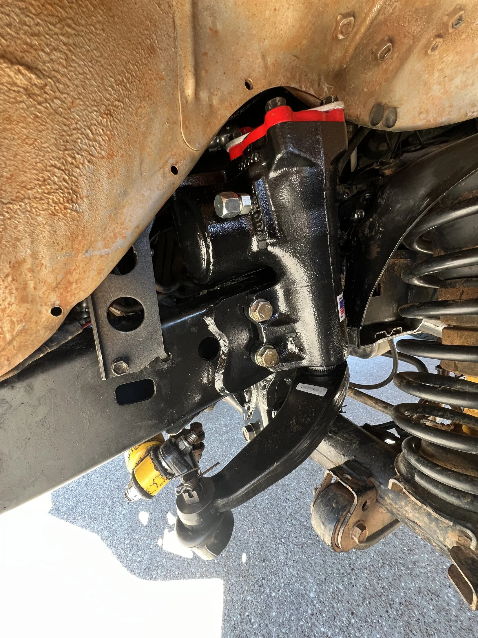

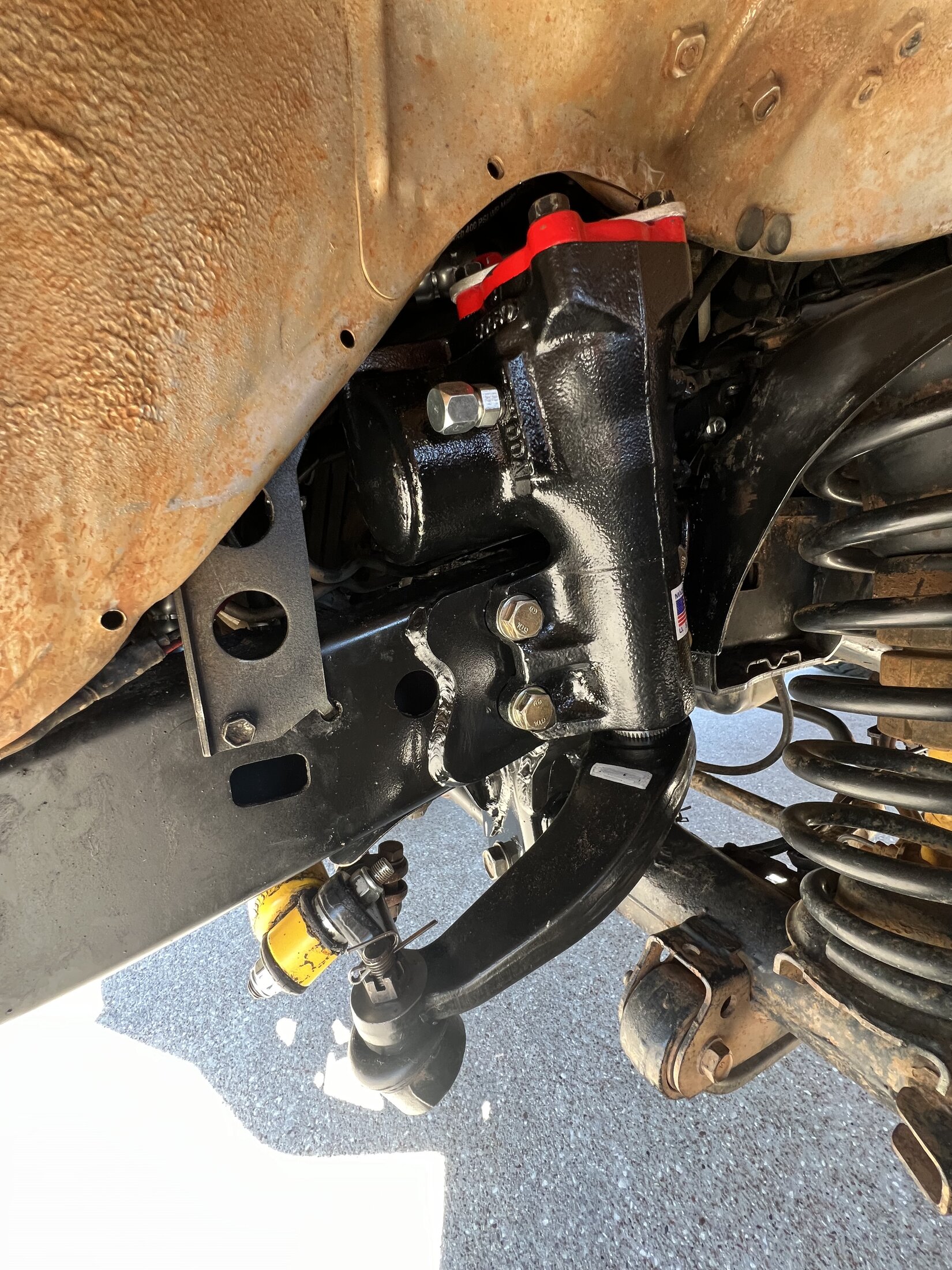

Well... I ended up biting the bullet on a redhead box. As much as I wanted to get a new one from japan I wasnt sure my box would hold together long enough for it to come in. I can say that so far I have been impressed with redhead's service. Fingers crossed that I dont have issues with it. I redid the entire PS system over the weekend as well as the Delta VS frame supports and the gearbox. I have basically 0 mechanical knowledge and I took this on primarily by myself. Once you start getting it taken apart you realize its not that complicated and reassembly is pretty straight forward. I had to buy $100 in tools but probably saved myself a grand at least. Definitely would recommend anybody on the fence about doing it themself to go ahead and try it. Thanks everyone for all the tips and knowledge in this thread.
I sent my box up the road to RedHead 3 or four years ago. It came came back with the 105 shaft and ported like yours. I’ve had zero issues with it and don't expect to. They do millions of steering gears; two people post complaints and that triggers others into fearfulness of buying their product. Rather silly in my opinion.
Did you do that brace welding yourself? It looks top notch….
I'm glad to hear yours is has been solid. And I completely agree with you on the bad apples theory.
Thanks for the compliment, I didn't do the welding myself. I have a buddy that welds for a living that I was able to call in. He doesn't do automotive stuff but I get to convince him otherwise occasionally.
@97HM I was just gonna say, "no mechanical experience" my ass! I OWN a structural steel fab shop and that's a good a weld as I've seen my best guys do! Very nice work. Now you make me think I could do this, lol. What was the turn around time from Readhead? And the $1M question...does the steering feel brand new? I'm still leaning towards getting a brand new box and keeping my 145K old box on the shelf.
Okay, here is a dumb question...if I'm not rock crawling, are the Delta reinforcement brackets do anything for regular drive quality? I'm assuming they will prevent cracks when the front wheels are twisted like a pretzel. Just debating whether I should do this upgrade while I've got the steering box off.
