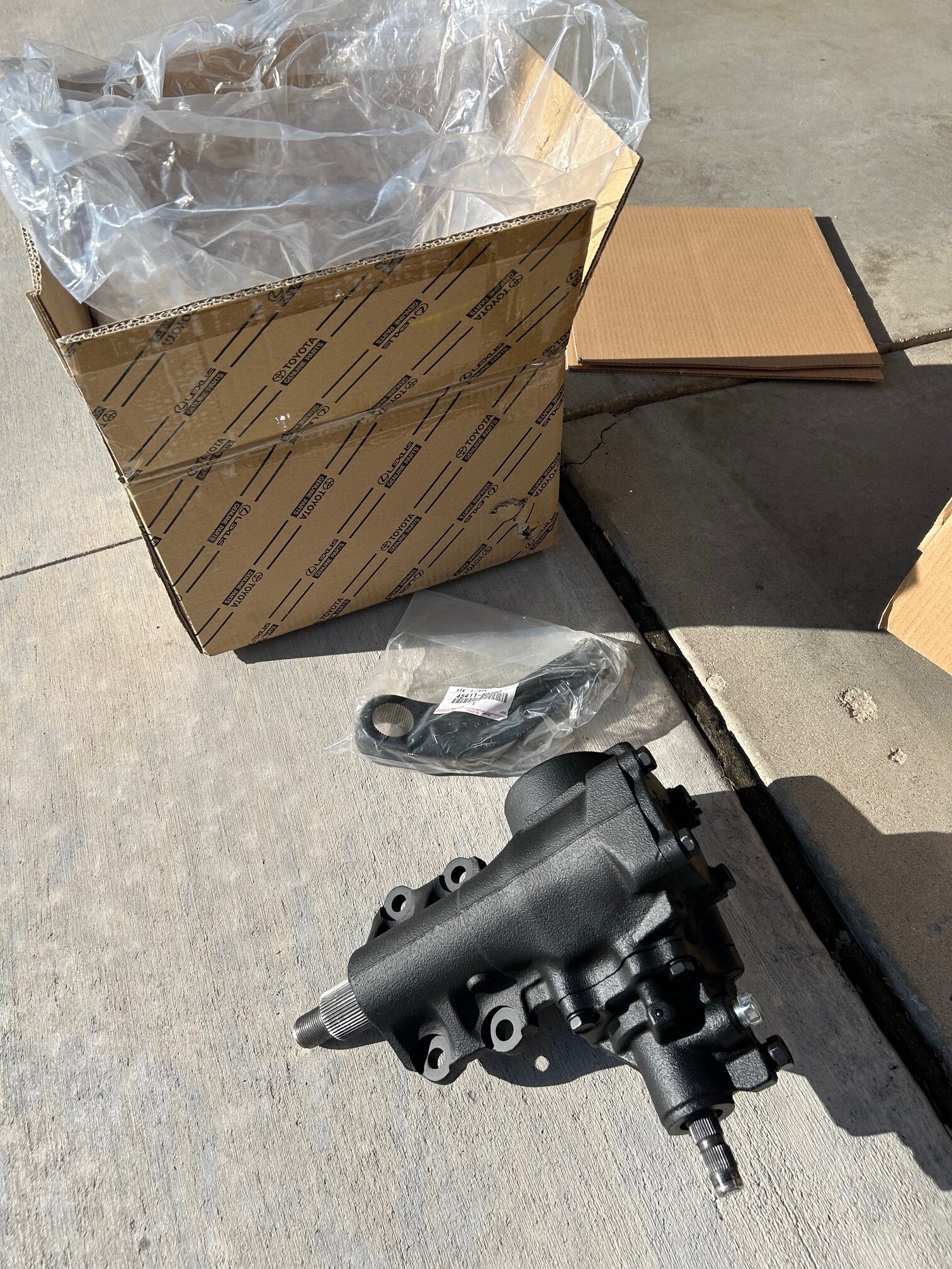

Redhead was very solid with communication and everything all around. I had an extra steering box core to send them to save myself the core charge. They had a few on the shelf ready to send out when mine got there and was verified good. The day after receiving my core my new one was on the way. I got all upgrades+tapped. It only took 3-4 days to get to me in tx. The steering does indeed feel amazing. Before, I could turn my wheel wildly left to right while driving and still go straight, not to mention the fluid leaks... Now the steering feels tight and i feel like i certainly have more control.
I have seen a lot of people here say that the frame crack is not an IF thing but a WHEN. I personally haven't seen the crack but i have limited experience around other 80s. My 80 is going in an all out crawler direction so I called upon my welding buddy so that i will hopefully never have to deal with it again. Seeing as how you have a fab shop at your disposal, I would certainly recommend knocking it out while your there. The welding to be done on the inside frame area is tight though, I picked up a puller set so i could remove all the steering arms and stabilizer to open up as much space as possible. It also helped a bunch that I had removed every single other component of the PS system for replacing.(besides the paperclip)
shipping was a little crazy! Impex was quoting around $25 for shipping, PartsQue was over $200
Impex will end up close to that - the initial shipping quote is a generic rate, then you get hit up for shelf weight, then you get hit up when they actually measure it. Exchange rate was so good when I bought mine in late June that I was ~$1,360 all in including $43 of duties that FedEx billed.
Dubai Wednesday my doorstep in CO Friday. There she is:

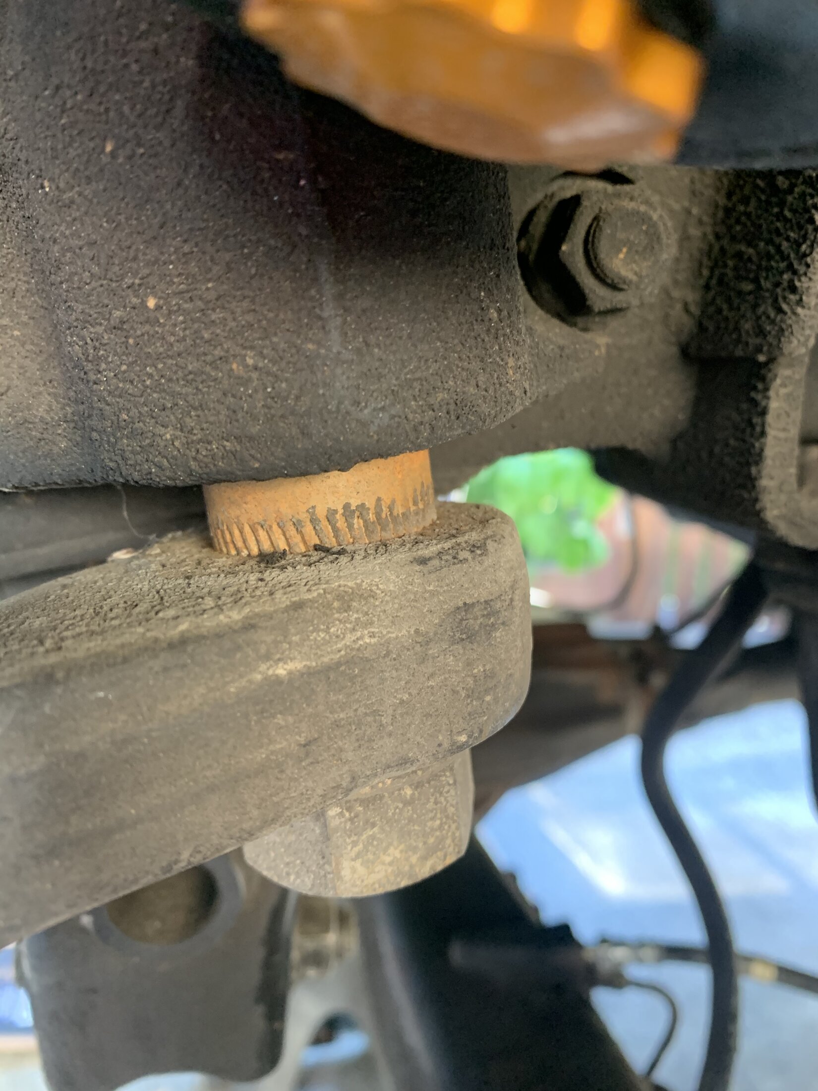

My 80 was hit by a drunk driver while parked. The DS front tire took a lot of the hit and pushed the wheels hard driver side. So hard it bent the drag link pretty badly. Looking at my sector shaft I see what appears to be "twist" in the exposed threads. I fear I'm in for a new box, or at least a 105 upgrade. Can anyone offer opinion based on this pic?
It looks bent, if you pull the pitman arm down a bit you will see it better. This was bent at Pismo Beach in the sand dunes, hit a rut. Also check panhard and bushings for irregularities. Yours looks way more bent.

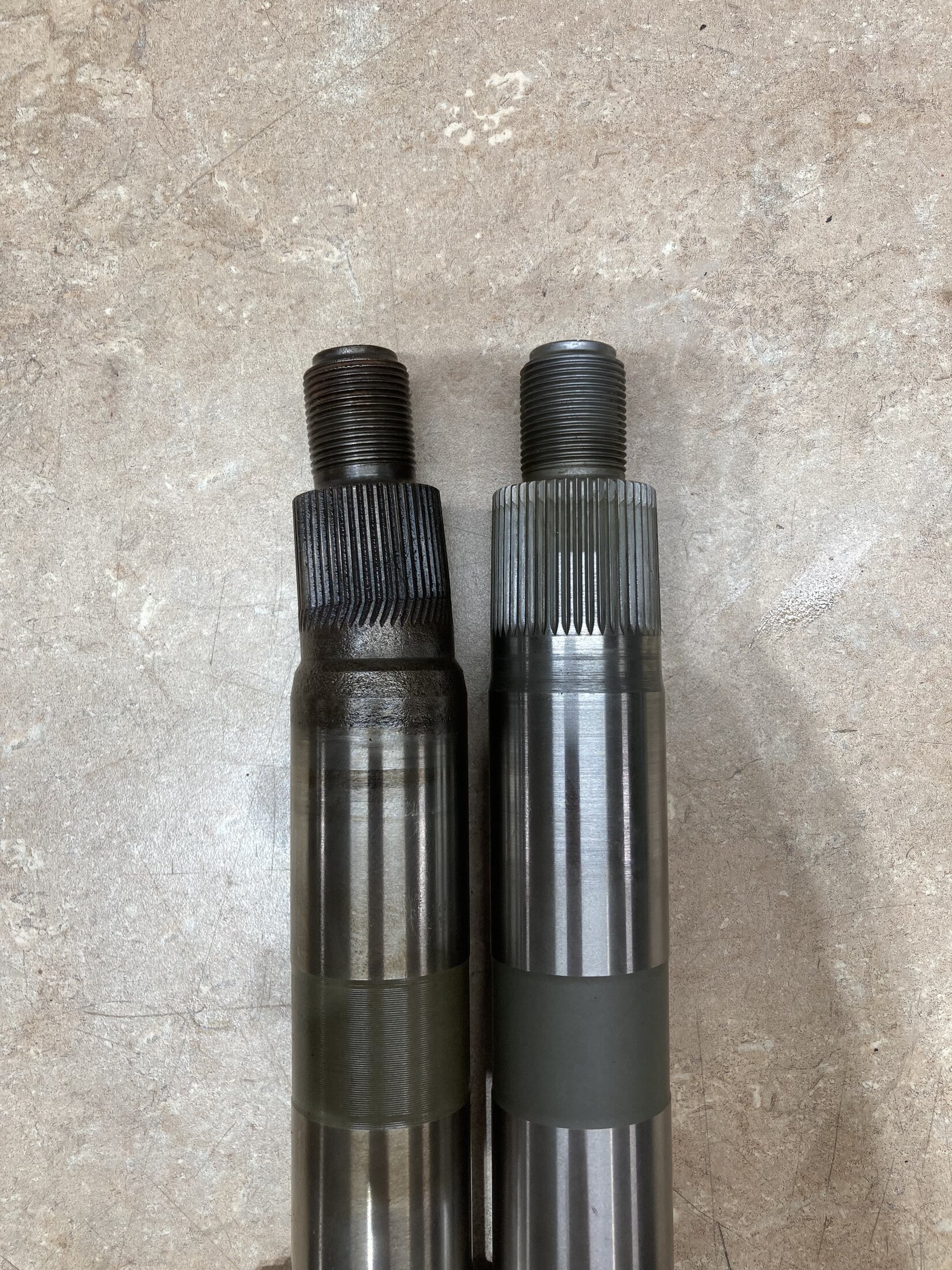

Posted this pic a few times before, but my factory sector shaft came out with twisted splines and also bent. Pitman arm had to be torched off after I broke a puller.
I’d advise not driving it, especially if it took the hit you say it did, until the whole steering system is looked over and checked thoroughly. Sector shaft shears and you’re F’d.

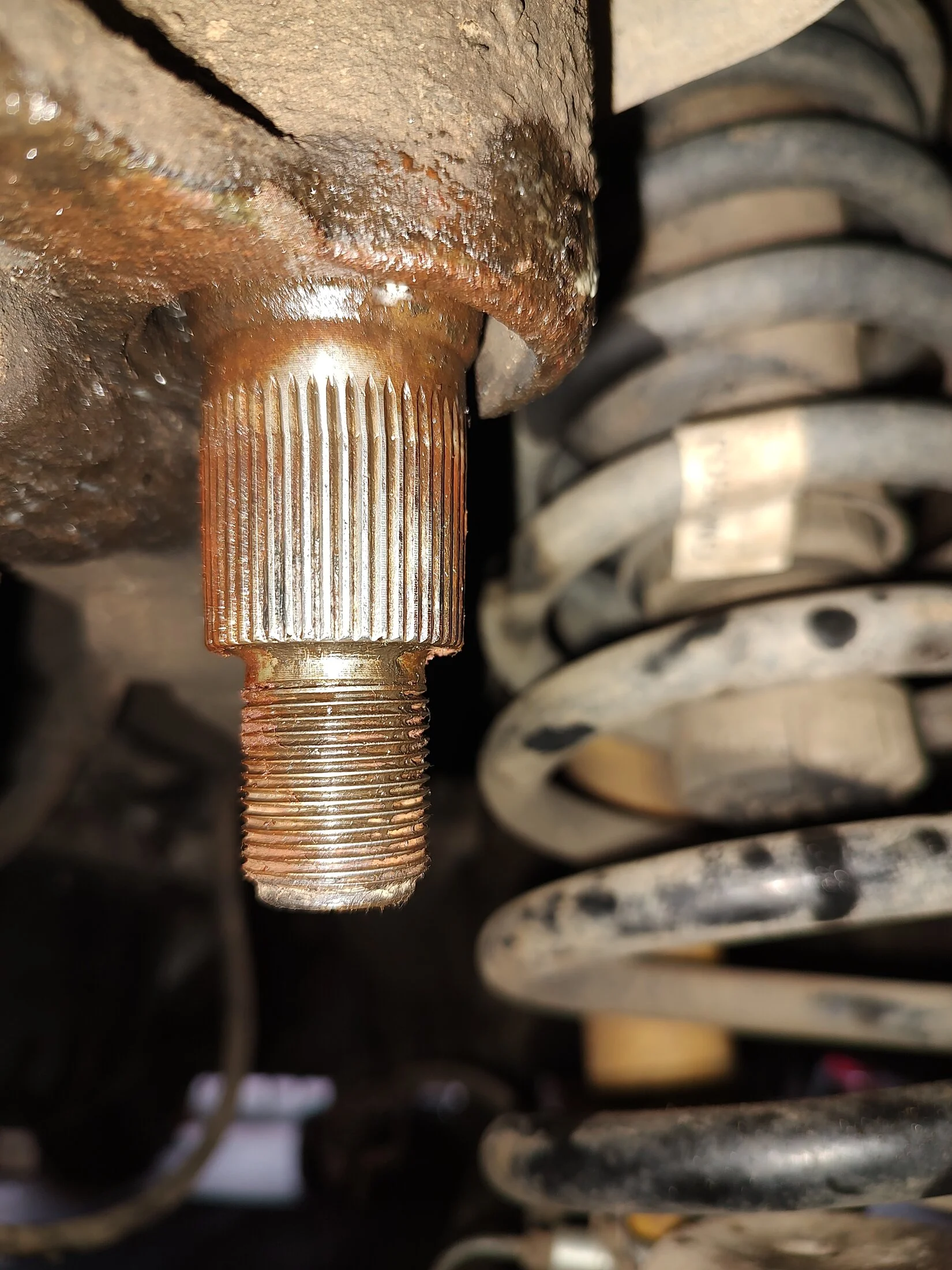

Does anyone know the diameters at the splines of the old and upgraded sector shafts offhand? I know my 80 has been through some fairly significant reconstructive work and I'm pretty sure the box was replaced at some point. It's unlikely, but there's a chance I have an upgraded 105 shaft already. I'd like to take a quick caliper measurement, just to be sure.
You could see there's a quite a difference. Do you have a picture of your sector shaft. The splines and the shaft are almost the same diameter on a 105. There is a step on the original 80 shaft.
Yeah, it looks like there's just a tiny transition step on the 105 shaft (based on the pic Saito posted). I haven't really looked at mine, it's just something that's on my list of things to do eventually - figured if someone knew the diameters offhand, it would eliminate guesswork entirely.
