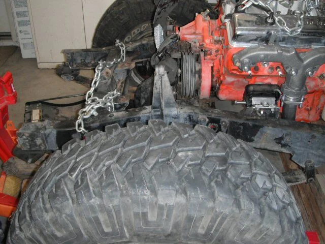

I'm not blaming the box location either. At least it's distance from the cross member. I think the major culprit is the notch taken out of the lower flange of the cross member to clear the steering u-joint. That major crack propagates from the corner of that notch directly to the rivet hole.
I think your spot on. All the cracks on my old crossmember started around the hole the PO(I call him Butch R) cut in it w/o any sleeving of the hole, which eventually screwed up the frame horn the box was attached to.

Started extending the frame for my SOA spring hangers. In the process, I decided to to get rid of the remaining pieces of the previous hangers on the outside of the frame.
Luckily I managed to not obliterate the frame VIN in the process. One digit has a bit of weld left on it, but it's legible.

So to explain the frame extensions a little. I put a question out there in this thread SOA geometry thread With some debate there I'm going with keeping the previously installed shackle hangers and putting the original spring hangers in front. With the springs and some weight on stock springs the eye to eye measurement looked about right with hangers off the front of the frame a little. See the pic below.
Anyone else have an opinion on going this route?

A buddy of mine did that on his FJ40 when doing the SOA swap. Frame extensions up front and using stock fixed-end brackets worked real well.

Traditional? I guess. I'm no purist obviously. I guess I'm a bit of "if it works don't fix it" type of guy. The stock shackles on my rig have performed flawlessly for nearly 35 years. 17 of those with me beating the crap out of them. I would reuse the ones I have if I had to. One is slightly bent and another has a loose pin. My fixed end pins have some junky threads from being banged into the spring eyes to many times.
I want as short of a shckle as possible so stock is the choice. And, I preferr the OEM design where you can't over tighten the nuts and crush/pinch the spring bushings. Unlike the aftermarket H-bar style.

Last weekend was a bust for garage time with Mothers day, band practice and the kids hockey.:p So today I snuck in some Saturday time for a change. Got a new to me, previously modified cross member for the cost of a road trip to Tucson. Thanks AZOKIE! :cheers: Someone made a mess out of one of the radiator mounts, but I've got spares now. I may not even need them anyway, we'll see. And now I finally got a call back for a Scout PS box core for a reasonable price. I'm picking it up to give that option another look. Would need to find an unmolested cross member for that route. Decisions, decisions.
New frame part
Made a custom SST for locating the spring hangers center distance. Spring pins screwed to a piece of flat stock at just the right spacing. 1070mm from my FSM chassis section. About 42-1/8", which seems to differ slightly from other info I've seen. 42-3/8" was the number given in my original shackle reversal kit. I've read 42-1/2" elsewhere. I'm going with the Toyota numbers.
