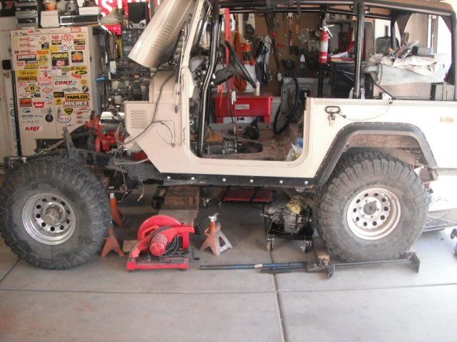

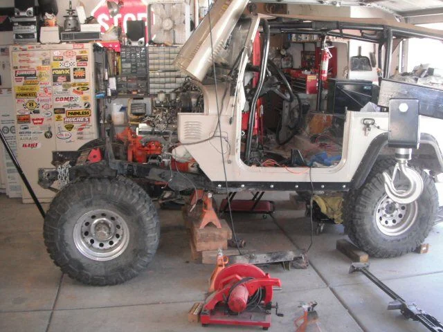

So with the 1st test fit of some stock springs on top with my new set up tacked in place. :eek: Holy wheelie Batman!
I know I'm missing some weight right now, but wow.
Just to see what would happen I put the trans and xfer in the tub, plopped the fenders and other misc pieces up front and it dropped about 3/4". :p

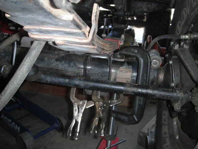

My springs in the rear run nearly flat. and it turns out that those have one less leaf than the these in the front. So next I guess I'll be pulling a leaf (or two) out of the front.
Put together, take apart, put together, take apart......
I'm pretty sure that the front spring pack was intended to have an extra leaf over the rear to support the weight of the F/2F. I'm sure you could find it somewhere on MUD with some searching.

I meant that I think the front leaf pack has one more leaf in it than the rear leaf pack has, at least from the factory. I think the front pack has 9 leaves, the rear has 8 leaves, or something like that. I'm probably wrong though.

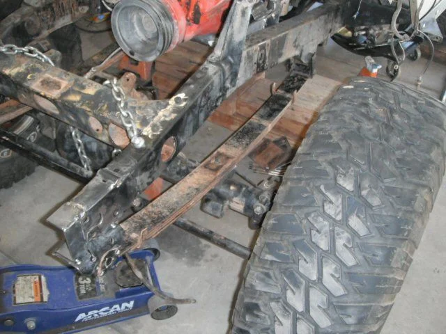

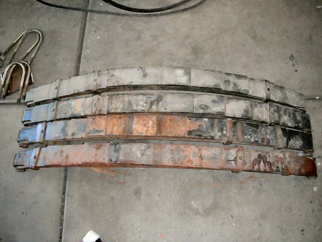

Anyway, got them stocker springs from Woods (Tanks!) And set out to put in a pair of rears on the front....now it's an inch higher than before:doh:. These must be in much better shape the other sets I have.
So, I went at a pair of fronts and took out the 3 shortest leafs and put those in. 2 inches lower and a more acceptable shackle angle. I think I'm in the ball park now once all the missing weight is put back.

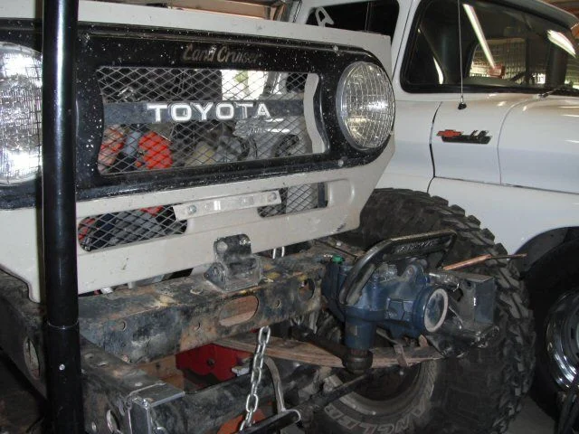

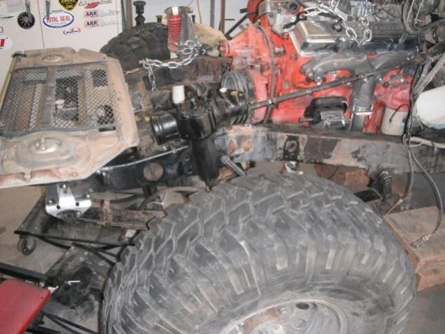

Some more trial fitting. Took the plasma to my free previously whacked cross member to make some room to tuck in the steering box more. .....And I took out a bit more than necessary :doh: Oh well, if I go with this config I'll cover it up with an escutcheon plate. Looks like it would work out pretty well with the oringal mounting plate reused. Had to remove a corner of it to clear the spring hanger.
Put the bib back on to ponder where the hoses would go too.
Scout box is looking better all the time ;p
Time to start thinking about high steer arms too.

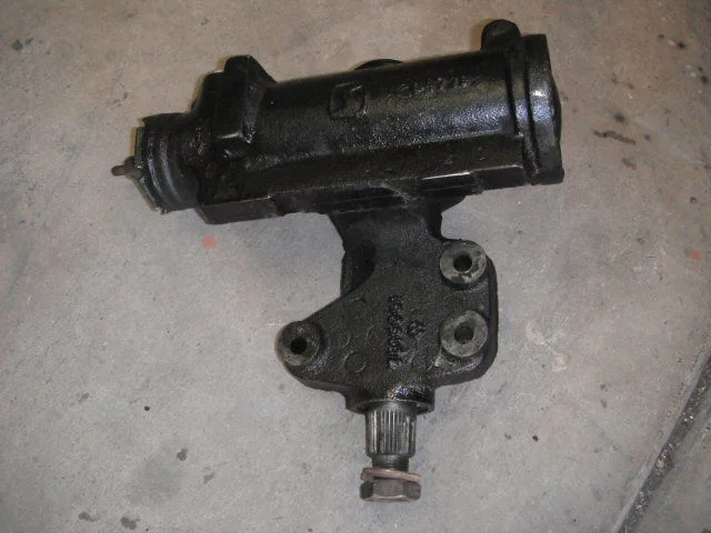

Scout box in the house..

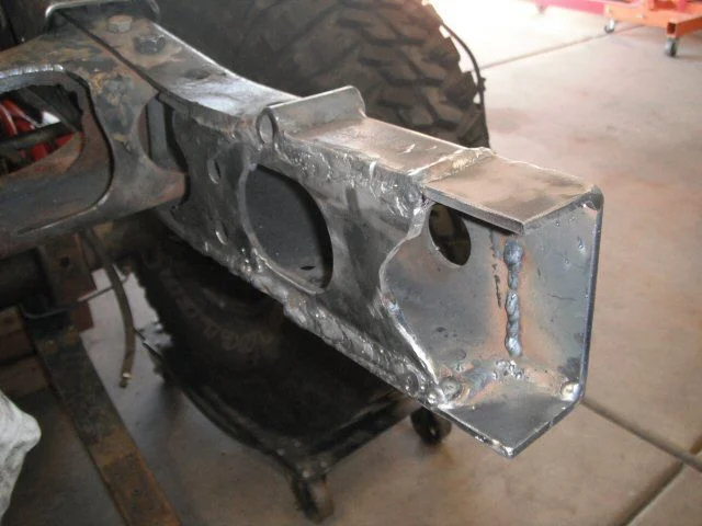

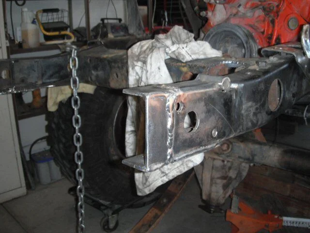

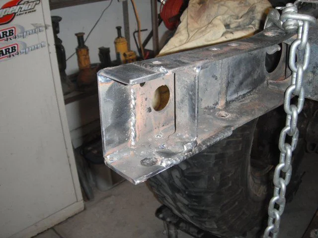

Final welding on the frame extensions done. The inside areas will be boxed once the front cross member replacement is complete.
Not the prettiest, but effective I think. :hillbilly:
Vertical and upside down welding sucks :bang:

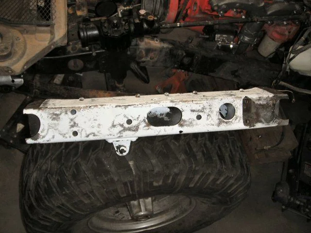

The beginnings of the Scout box mock up.....trying to figure out what sheet metal trimming will be needed. Looking like this is the way to go, plus I now have a non hacked front cross member to install with this setup. It needs to get dipped because it has a curious black over white paint job. Some paint stripper and a pressure wash took most of the black off, but the white is dug in good.
Who paints their frame white? :rolleyes:
