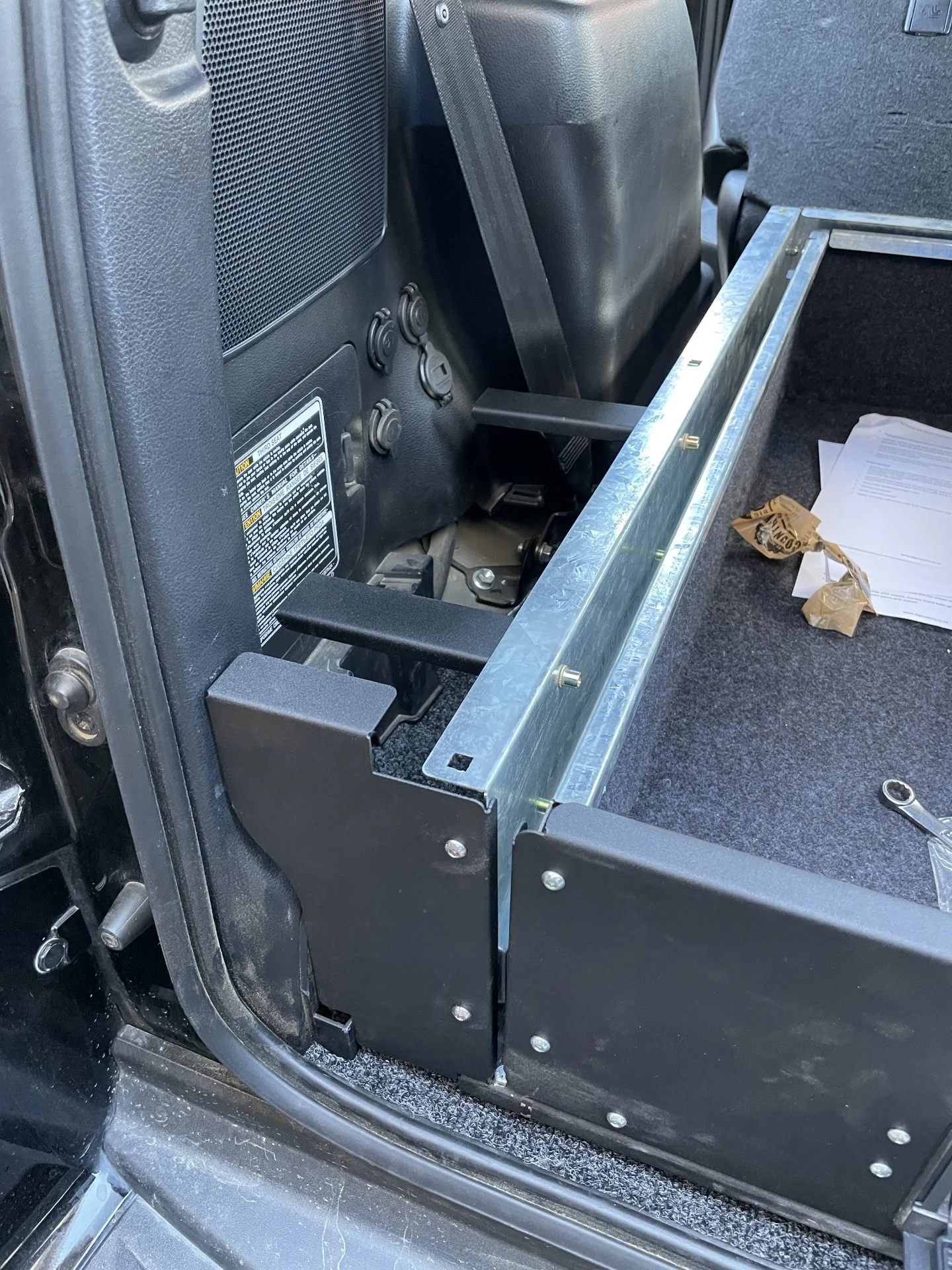

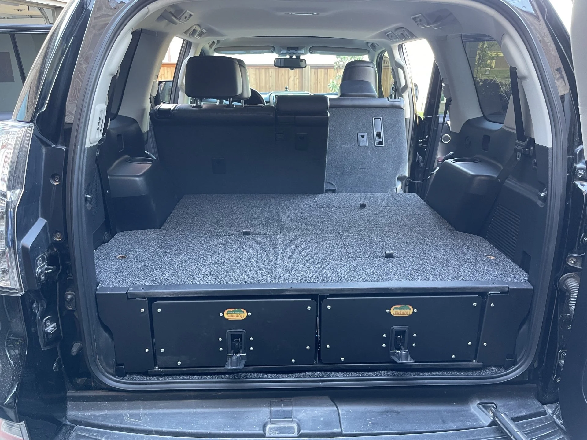

Installed my Rugged Bound drawers today. Fantastic quality and pretty easy install.

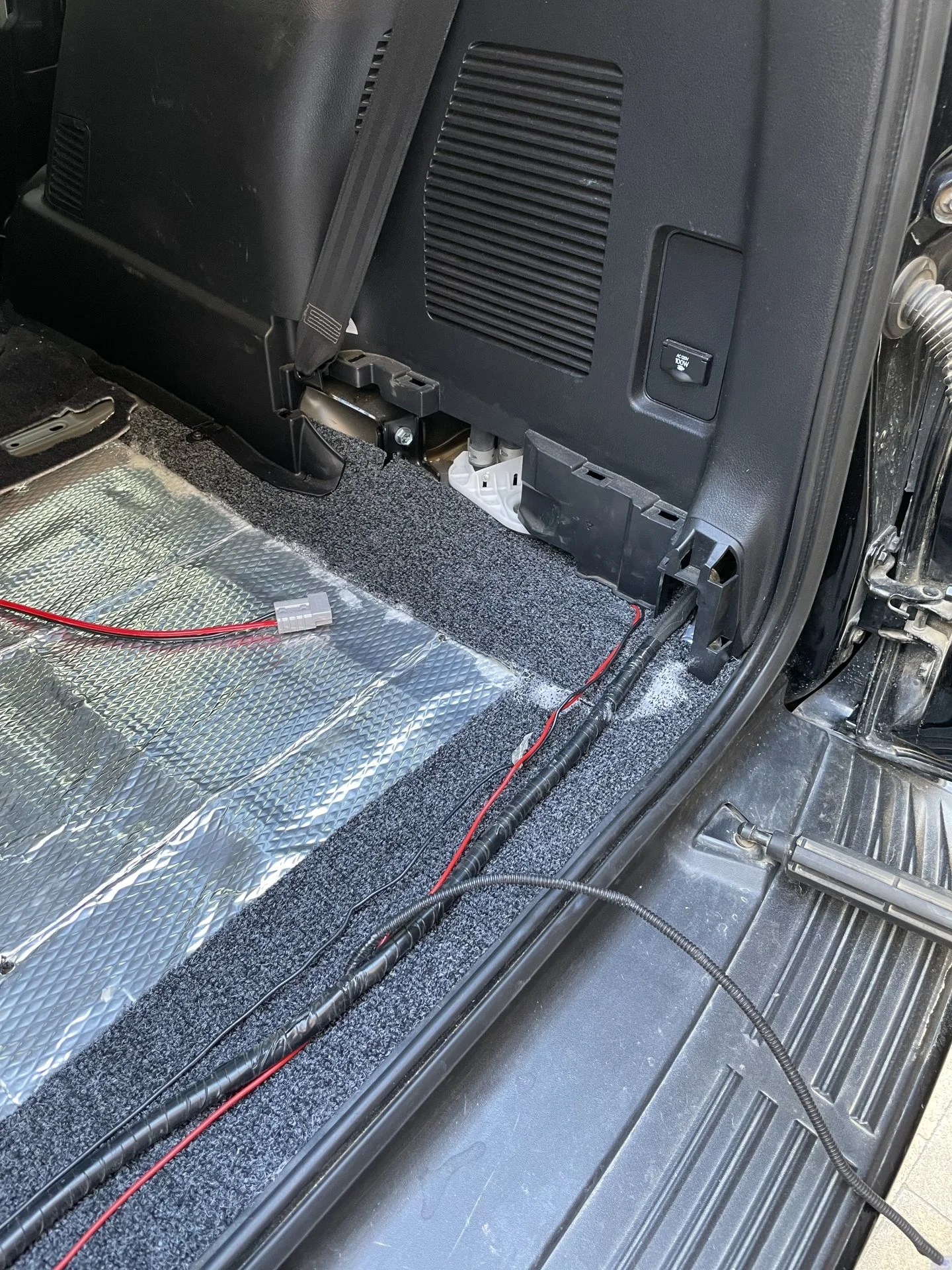

Haven’t put the battery in yet - will get to that this weekend.
What will the battery run?
The drawers look nice. Are there dividers for those drawers. Thinking of items shifting while you are moving.

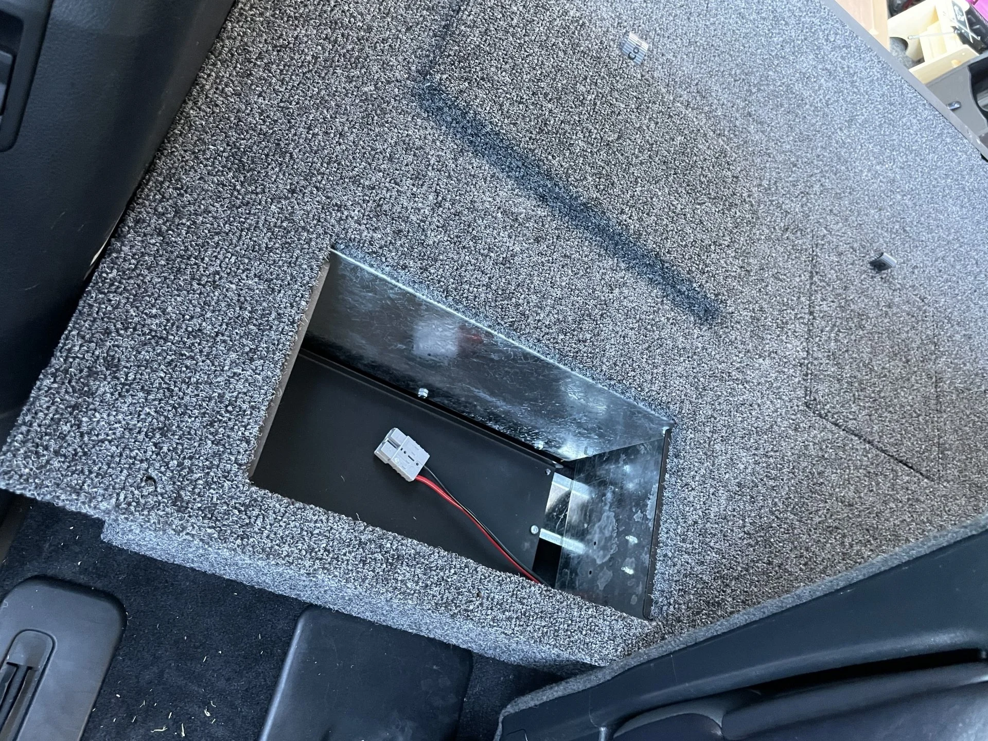

Rugged Bound worked with me to design the battery hole and the two access panels so I can get into the drawers without opening them.
I wanted the access holes because when my trailer is connected I can’t open the barn door all the way, and I wanted to still be able to get things in and out of the drawers.
They made several versions of CAD drawings until we settled on what you see here - great process and easy to work with.
Probably took about two or three hours to bolt it all in - and I’ll spend another two or three getting the battery wired, fused, and the DCDC charger mounted like I want it.
Over all, this is one of the best drawer systems I’ve seen. Solid, uses original seat mount bolts / holes and the drawers are very sturdy.

Some questions on the drawer: The battery hatch is a standard add-on option to these drawers, Giovanni simply had to choose between driver or passenger side. It shortens one drawer.
The additional two hatches were custom add-ons for Giovanni. We try to keep custom items to a minimum as it increases the manufacturing floor process but these were very reasonable and easy to do modifications as the main drawer did not have to be changed. For Giovanni's use case these mods made complete sense so we were happy to make this happen for him and it turned out great!

The 2nd row seat is unaffected by this system. Full recline still works - that was a requirement for me as well.

I removed the 3rd row seats completely, and this draw setup bolts in using the same mounting holes/bolts that the 3rd row used.
This is reversible, but definitely not an "on the fly" change. I could remove the drawer system and reinstall the 3rd row seats - I'd estimate that to be a 1 - 2 hour task.
