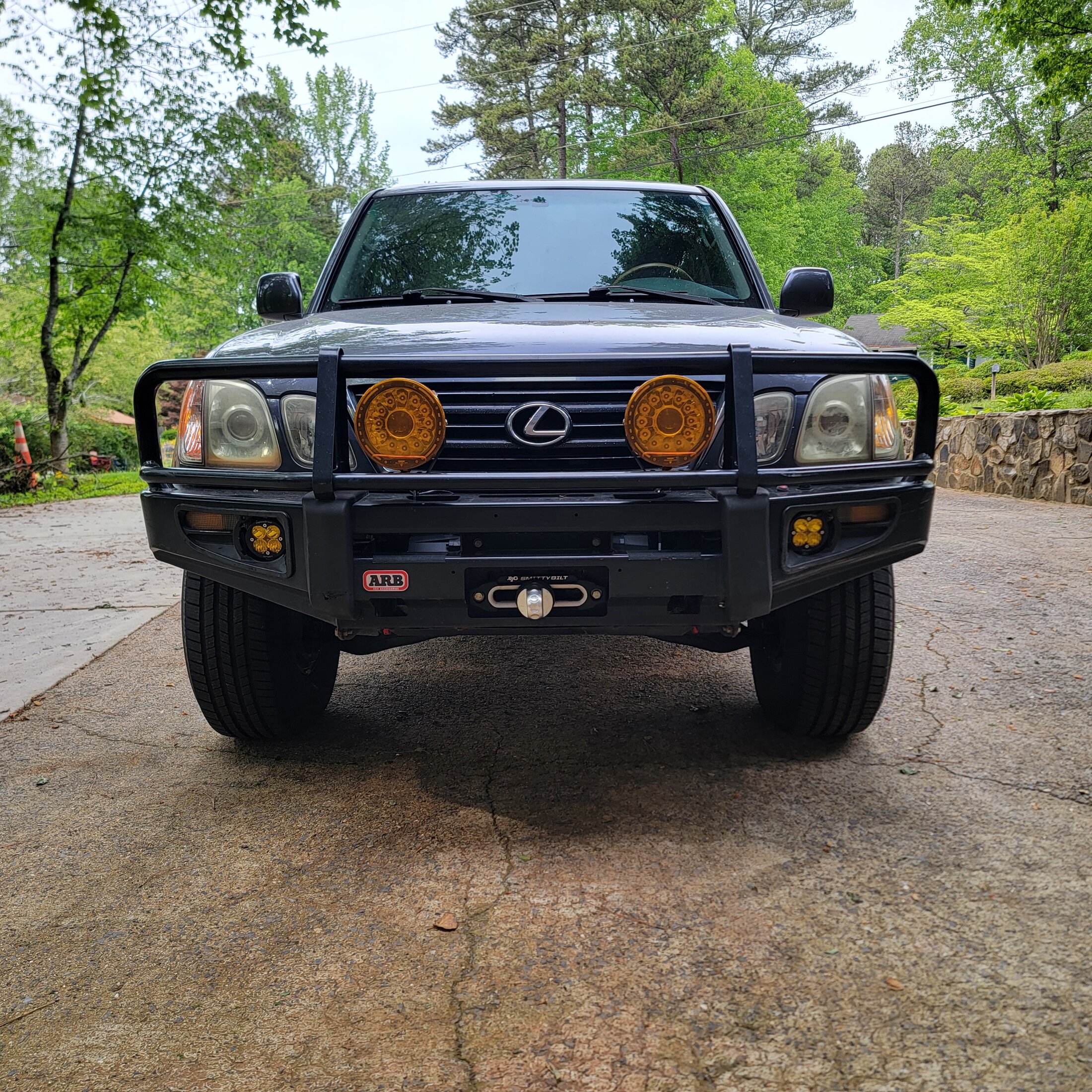

When I made it home from alignment the other day, my passenger side fog light was dangling out of the bumper. Crap. Not the end of the world though as one of the lights was actually dead, so I hadn't used fogs in a while.
I ordered a set of Baja Designs Squadron R Sport, in the driving/ combo yellow flavor. Yesterday I pulled the ARB fog light buckets and installed. Instead of rigging it myself like I'd done with the old lights, I ordered a pair of 3d printed brackets from eBay to easily install my 3.5 lights.
While I had the buckets out, I disassembled the ARB turn signal lights and cleaned years of mud out of them. Now there's a visible light, AND it's amber.
I also got sick of my filthy headlights, so took them out, baked and removed the lenses and cleaned the lenses and shrouds with hot soapy water. Sanded the lenses from 800-2000 grit.
This was super cool. After 20 years of wet sanding and buffing headlights, I consider myself to be pretty good with the process. I ordered a headlight Vapor cleaner from Amazon for like $30. It heats up a little cup of solvent, the vapors of which effectively melt the surface of the plastic, making them perfectly clear instead of needing to buff after sanding. This was literally like magic to me.
I also aimed the big lights after finishing the fogs.
