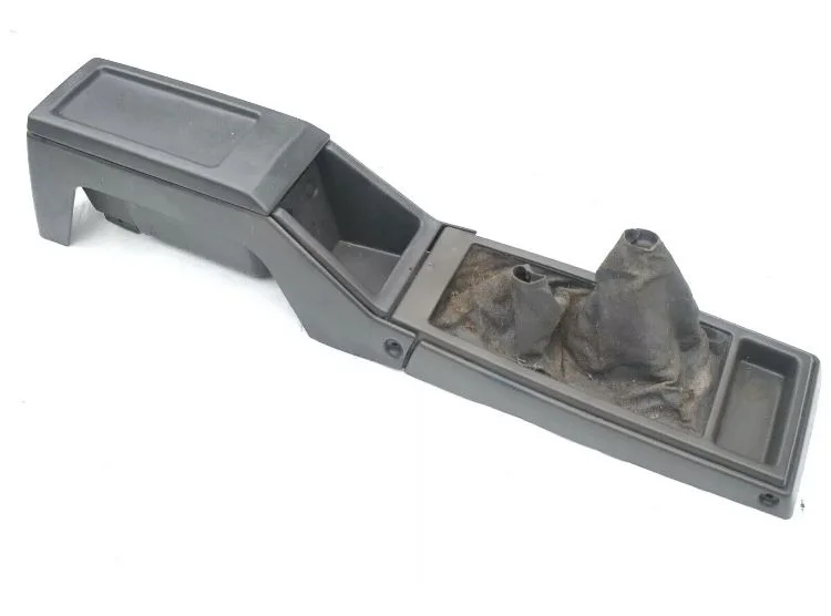

I had an '87 x-tra cab 4WD 5 speed manual truck that had that exact console on the LEFT
I know this thread is long dead but just for completeness, the gray one on the left is exactly the one that came with my 89 4Runner SR5 4wd V6 5-speed.

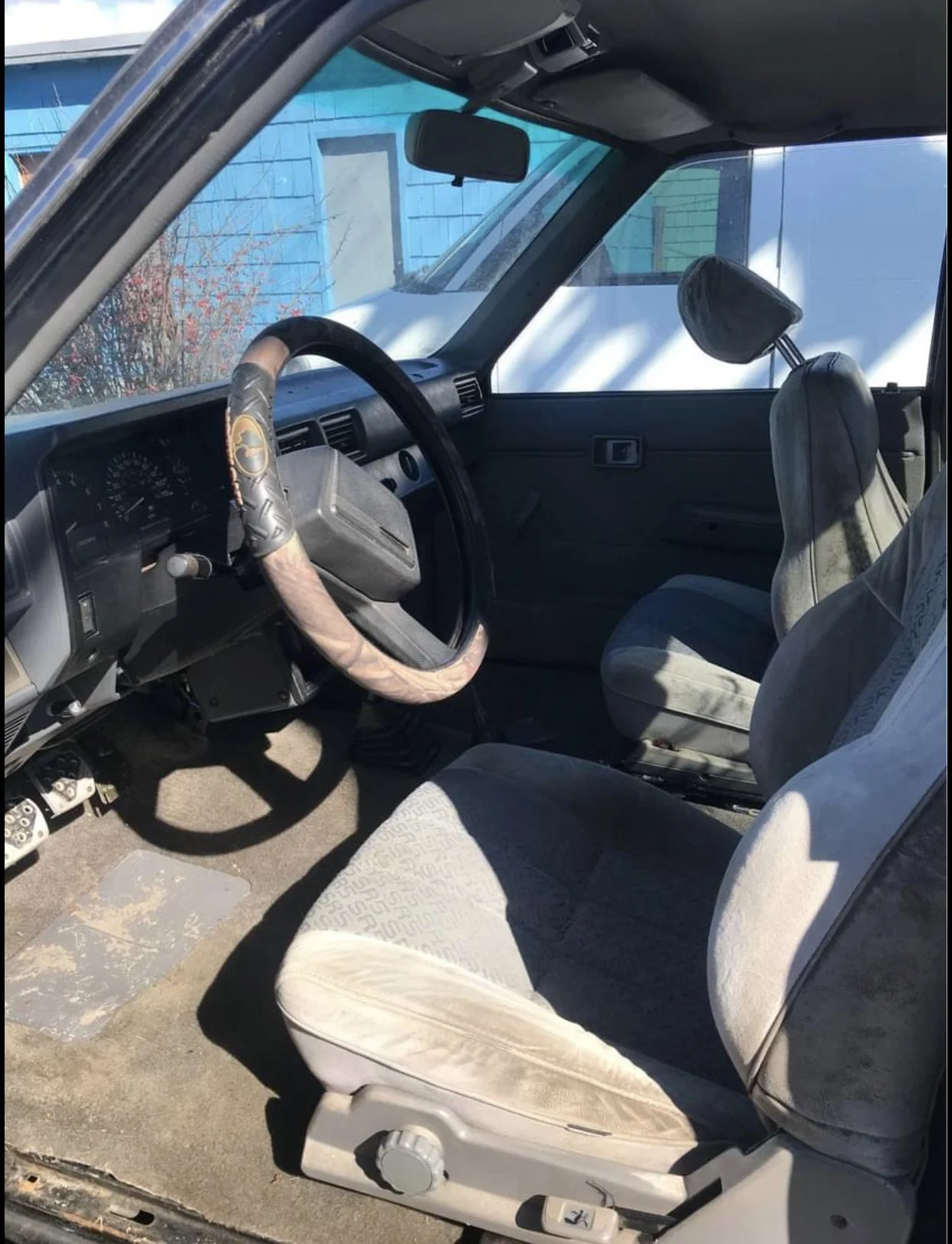

Reviving this one. Anyone seen an 86 SR5 Xtra Cab without a center console?
Are those the original seats? Those are the fancy SR5 seats that many people hunt for. The bench seat is a torture device, very uncomfortable. So I'm surprised there's no center console in your truck, I thought all the SR5 trims got consoles.
The consoles with heater controls in the back are for 4Runners. There's generally 2 types of consoles, short and tall. The short one only has a single plastic lid over a thin compartment. The high consoles have a padded armrest, and 2 stacked compartments. Start looking though eBay or junkyards, you might get lucky and find one, but they are getting very rare. The plastic gets very brittle with age and sometimes they will just literally fall apart. There are no longer available from Toyota.
4rnnr has the double stacker and as KLF mentions, it is getting brittle. Patch had the single stack. Other than maybe the added arm rest height I think that I'd prefer one 1/2 way betweeen them and with only one storage area.

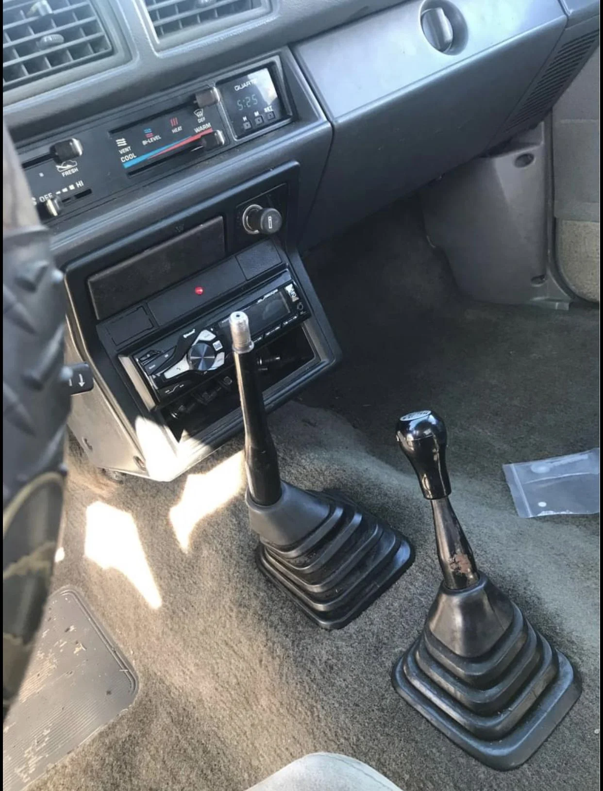

I had pretty much given up on trying to keep my console in good condition, and I went through several of the pieces that surround the shifters, they just cracked to pieces. Then when I swapped over to the R151F turbo tranny, it was impossible to find that uber-rare part. I had plans to make a surround with sheetmetal and fiberglass, then install a Tuffy behind it. Now it's @yotadude520 's problem :p

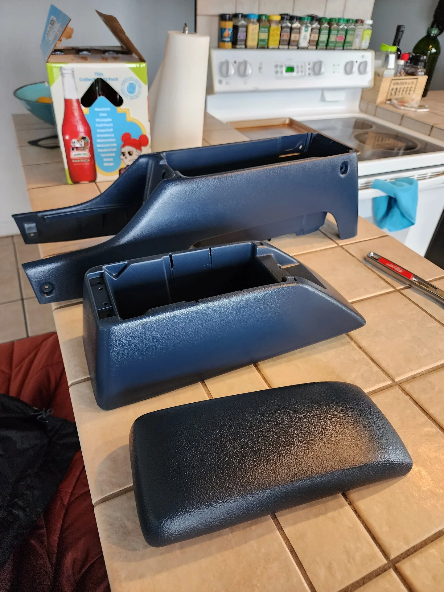

Based on your descriptions this should work, yea? Do the sections go together with some sort of Christmas tree clip? Sorry about all the questions but this is all new to me.

Based on your descriptions this should work, yea? Do the sections go together with some sort of Christmas tree clip? Sorry about all the questions but this is all new to me. View attachment 2613981
That should technically fit, but you will need some brackets that are normally spot welded to the floor pan: one in the very front, one in the middle at the joint, and one under the storage area. You should have a W-series tranny, which has room in front for that little cubby tray. The problem I had when I switched to the R151F is the shifters are about 2" further forward, so the cubby had to go.
Patch was an '84 with a G trans. No front cubby like that, but that is close to what it had otherwise. The whole shifter boot opening was shifted fwd and it had a blank area between the rear of the opening and the aft portion of the console. IT was big enough for some switches, but I never wanted to cut it there.

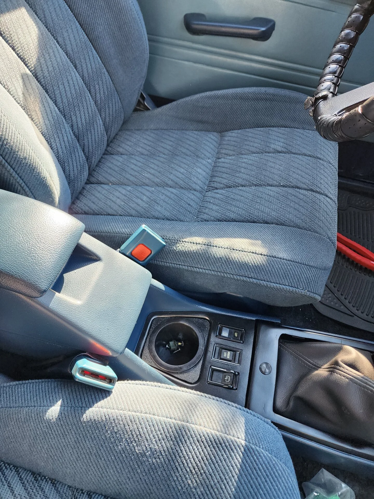

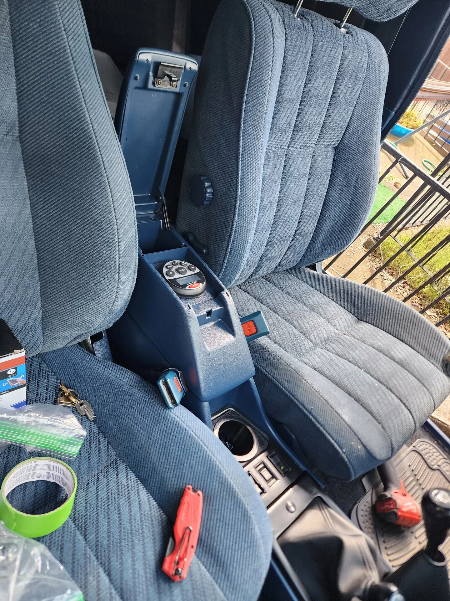

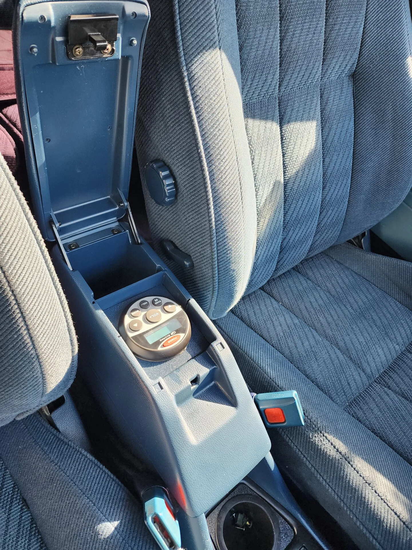

I know this is an old thread but on Sunday in picking up the top stack and pad for 86 4runner. A while back I picked up a 92 runner double stack that I fit into my 4runner. Does anyone know the width of the upper portion? I modded a round bluetooth radio to fit inside the upper portion but I really want the oem look of the 1st gen console so I will be doing the process all over and want to know if it will fit. If successful I will be posting the console for sale here before I post on ebay.
