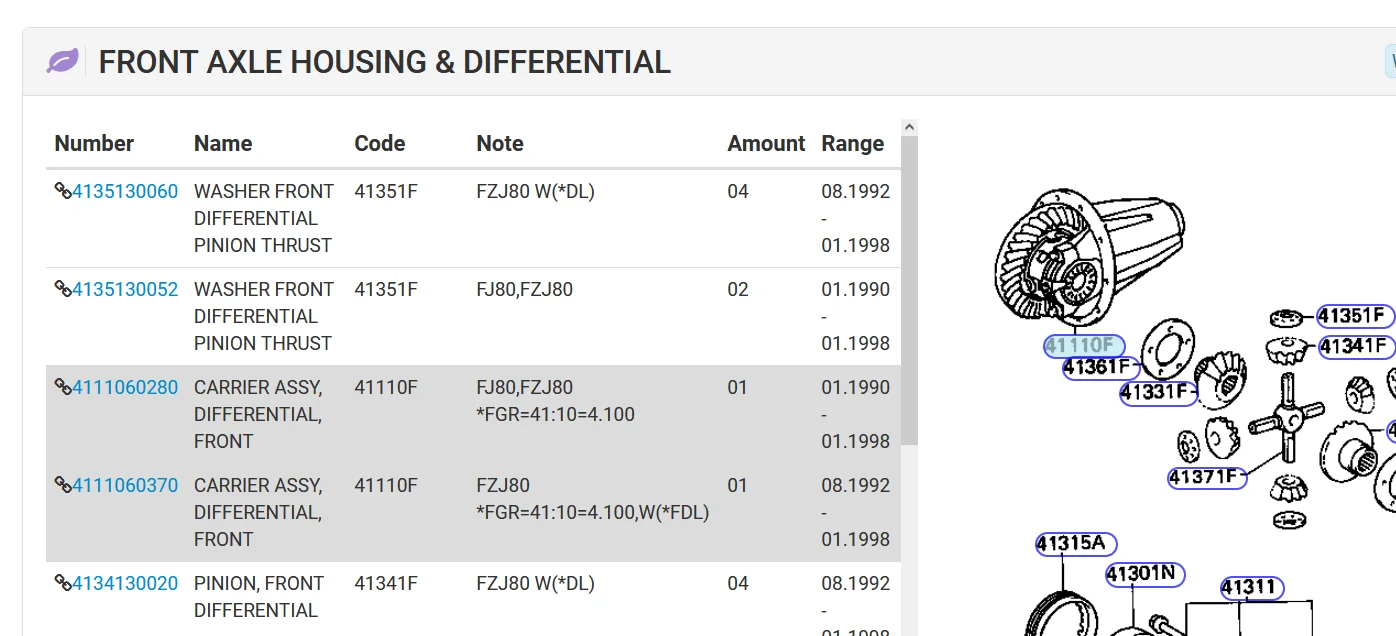

Currently i am in a situation my front differential started howling / TLC 80 /and a new crown and pinion gears are needed. The question is are those gears interchangeable between a diff with or without locker.
OEM gears for diff with locker are discontinued so i cannot order, but i can order crown and pinion gears for diff without locker... Part numbers are different but many claim that the part is exactly the same and will fit on my diff with locker... Any ideas will be appreciated... Those parts are costly, so i want to avoid ordering in mistake.
Thank you
Shortly - can i take pinion and crown from diff without locker and install them on a diff with locker?
The gearset is the same in both differential configurations.

Malleus, thank you for the fast reply hopefully you confirm.. I still cannot understand why is such a hassle ordering those parts. I am located in eastern Europe and the part guys i am using claim that part numbers are different and are unshure in ordering... Also my rig is with 41 teeth on crown 11 on pinion /3.7 gear ratio / and it seems it is the hardest to find as many people like to regear manuals to 3.7 to achieve greater highway speeds.
Are there any aftermarket options? Nitrogear are not producing 3.7 gear ratio
Are you looking for front or rear diff c&p?
Yukon has the rear c&p here:
They do not appear to have a front, 8" reverse 3.70.

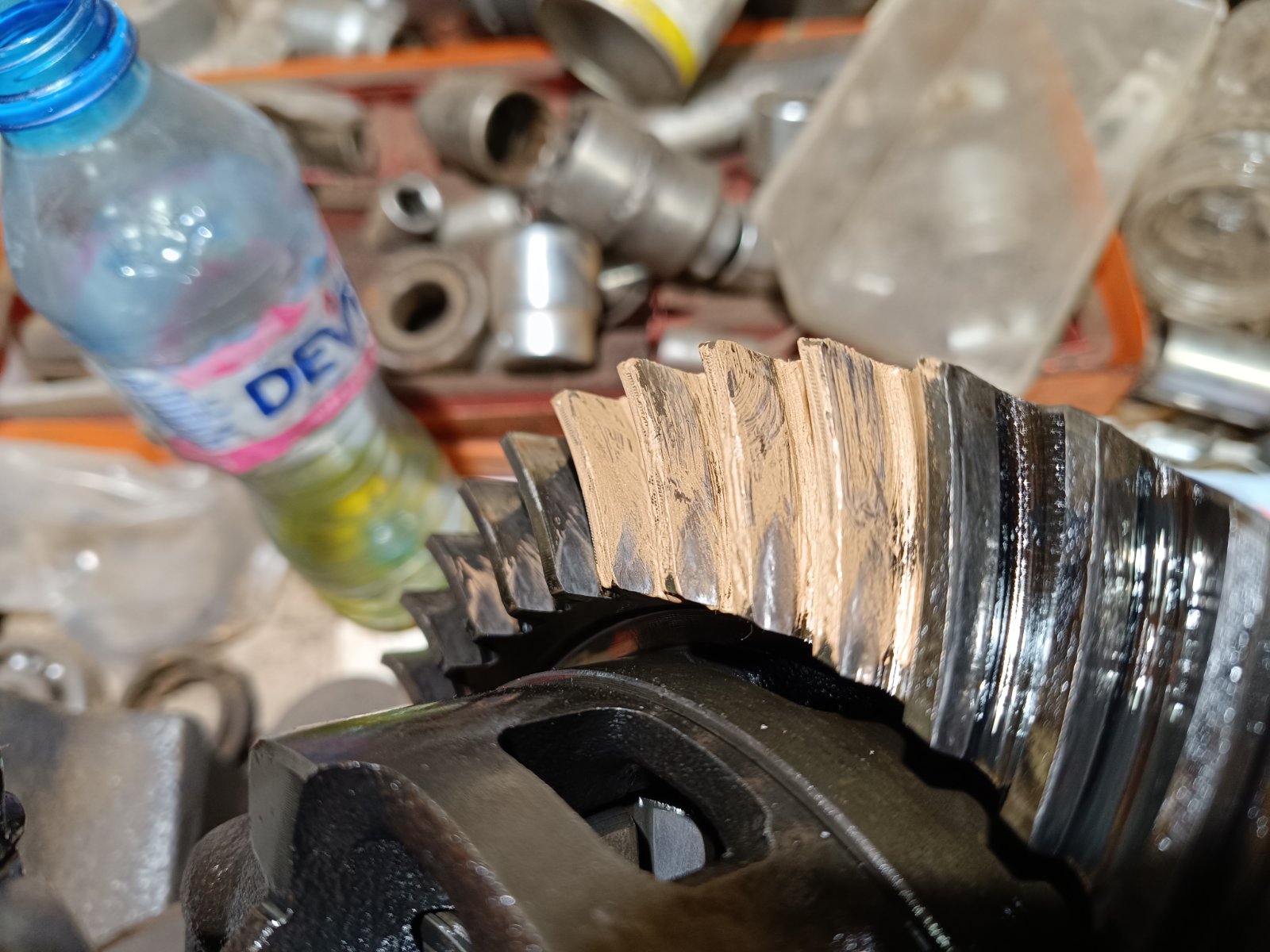

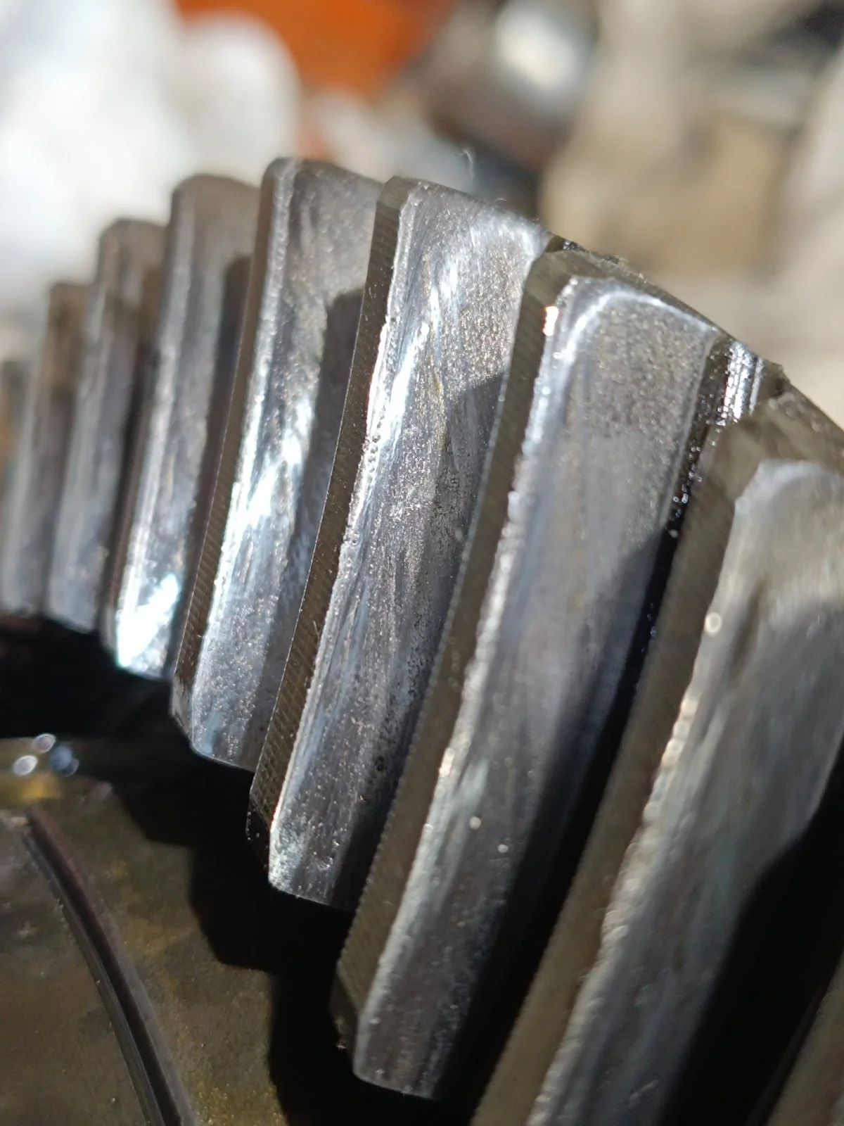

Unfortunately is the front.. This is the contact pattern of mine, and I get noise at high speed when i get off the gas and the speed of the wheels match engine speed. Mechanic claims it is not dangerous and it wont break but i am a different story.. Just can't stand when something is not working correctly
That pattern sucks. He's wrong and you're correct. That is an explosion waiting to happen.
You can reset the gear pattern by moving the pinion, but the ring gear is pretty much gone. Even if you get a good pattern, that gearset is going to whine until it fails.

If I couldn't find a new gearset, I would at least properly set up and shim the pinion to get a good pattern on those teeth to at least prevent overloading the teeth. It may whine, but not "explode".

Yes, we have already tried sorting out the contact pattern, now is more in the middle-ish position but gears are still whining... so in my opinion it was pointless. My rig is 4.2 turbo diesel, manual transmition triple locked.. It seems i am lucky with those gears.. The hardest to find..
My understanding is the only difference is the install kit.
Ring & pinyon are the same.
Just order the correct install kit 😉

Ok, sooo ... Terrain tamer has these listed on their site.
3.70 in 37/10 and 3.72 in 41/11. The 3.72 are stated as:
LandcruiserFJ801/1990-3F Petrol41201-69157TTFront3.70:1
LandcruiserFJ801/1990-3F Petrol41201-69226TTFront3.72:1
That is exactly what i need 41/11 obly problem is that im located in eastern europe.. I'll do a research on importing fees. Thank you
