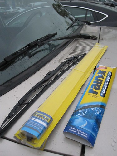

Rain Season Preperation - WIPERS!
Yes, it's that time again and yes, we do get a little rain in Southern California... hehehhe Either way, it's the yearly time to replace the wipers. I went with Toyota-Factory wipers last year. This year I am going with RAIN-X wipers. They are a scratch cheaper than factory and seem just as good so far. New wipers are always great when they are "FRESHYS!":)

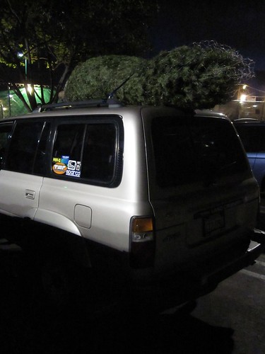

Xmass tree time!!!
Picked up the Christmas tree last weekend with the ADV80:
We went to the good'ol Home Depot to get our Christmas tree again this year.

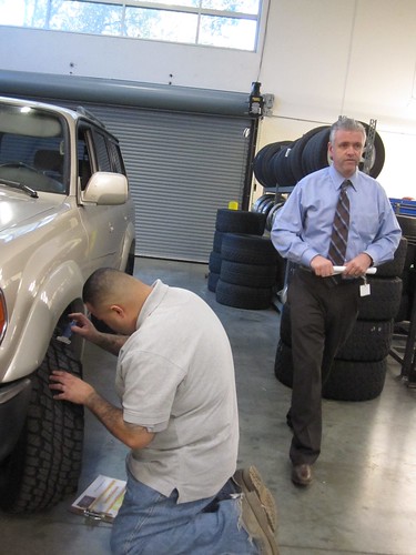

On the 15FWY looking at Mt. Baldy and heading to the Falken Tires Co. located in Fontana, Ca. Today I will be doing some tire evaluation as I approach the 5-month / 4,000-mile mark for these tires. Falken wants to see how these High Country tires have been wearing under the ADV80 on daily freeway driving and my weekend adventures.
Marcel Perez is teching the tires and Mark Richter is my buddy from long ago and works in Marketing for Falken.
I've been a good driver... practicing my best "old man" driving as I want to see how many miles I can get out of these tires and also, with a 3FE engine... there is no "FAST" in the ADV80.
While the wheels look cool, these big tires would just slow my ADV80 to a super-crawl... and that would be on the freeway.

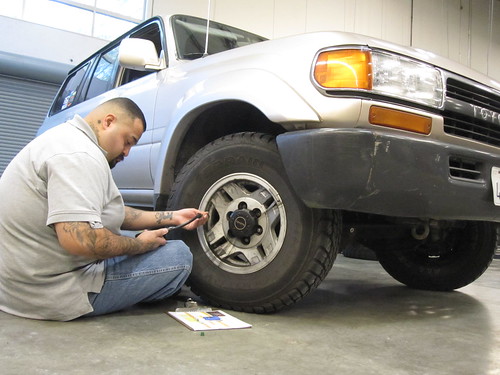

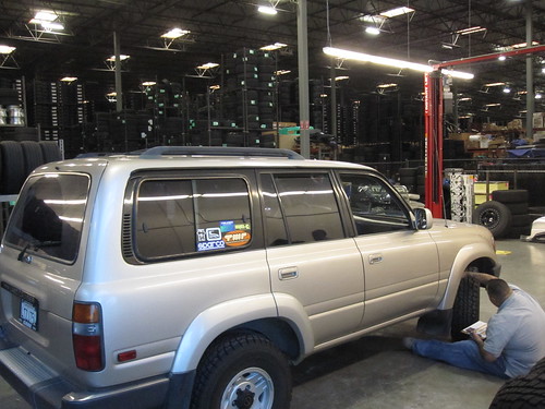

Marcel checks the current tire pressures and regulates for tread depth measuring.

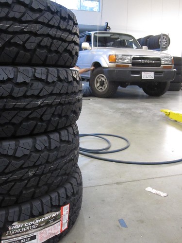

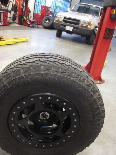

A new set of High Country's awaiting mounting and my ADV80 getting checked out.

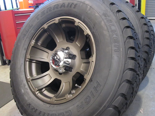

There are a couple of tires here.
My buddy Nick who also works for Falken just picked up a TLC, but word is he is giving it to his wife and its getting these nice bronze wheels mounted to some High Country's.

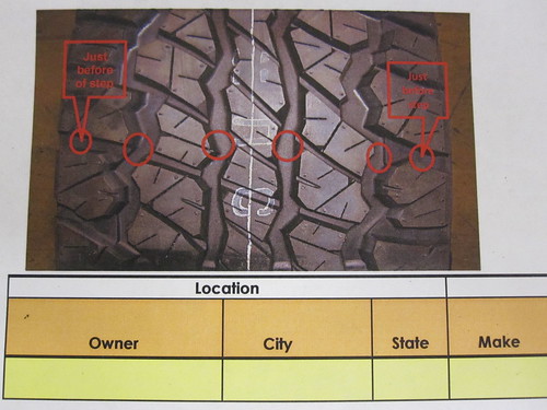

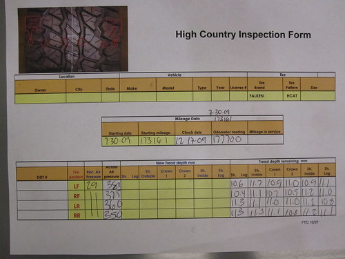

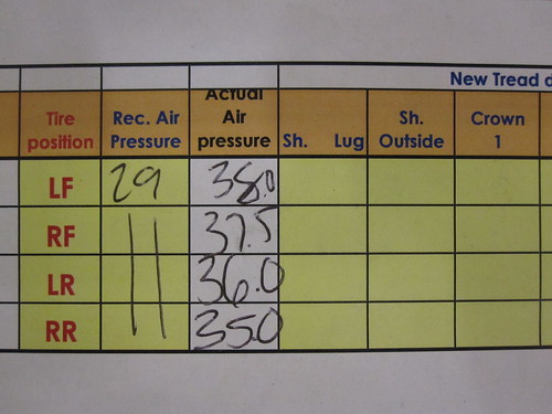

The High Country Inspection Form.
The location of spots to be measured for thread depth across the face of the tire.
The range in air pressure from 38psi to 35psi could be due to cooling as I just drove there. Marcel gets everything regulated down to 29psi.

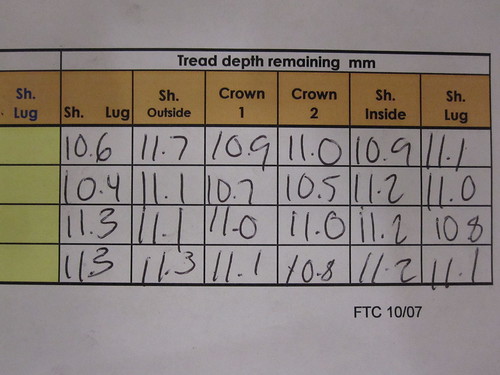

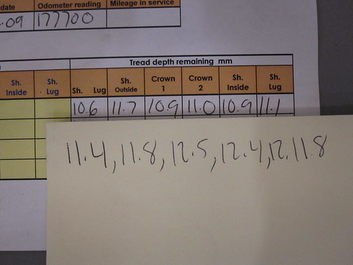

The numbers don't lie...

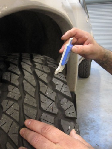

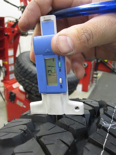

Marcel shows he his little handy thread depth gauge and collects the stock thread depths on a set of news tires so I have a cross comparison.
The bottom row of numbers on the card shows the factory / stock thread depths. The above row shows my LF-tire with approximately 4,000-miles logged.
Per Marcel, I have been "babyin" these tires as the tread wear results are great! I'm stoked with the results but I am more stoked with the performance with these tires as they are great for what I am doing with my light-weight weekend adventures. :steer:

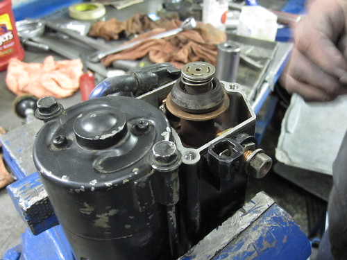

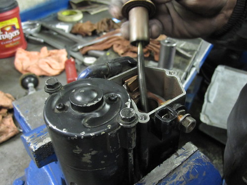

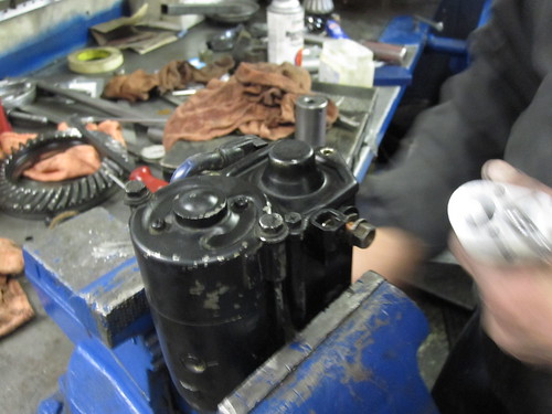

Top Tech Jay is about to pop off the back cover to asses the situation.

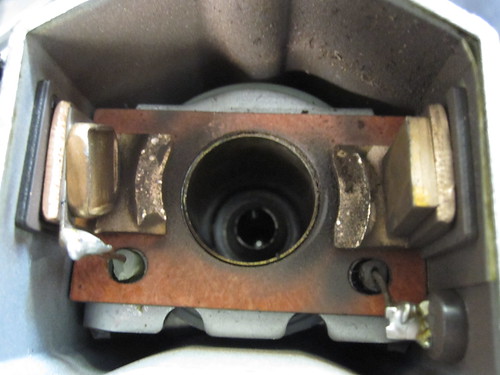

Backplate off and sorting the issues.
While worn, Jay said it still has life in the contacts and should not be the cause in the situation.

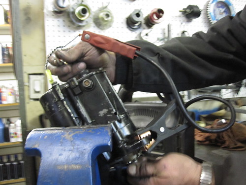

Jay wants to conduct the bench test and see if it is working and if what the issue is - if any.

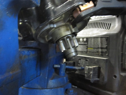

So with the "juice" applied, it is engaging the starter shaft to extend outward, but the motor is not actually turning the starter. Bad starter.

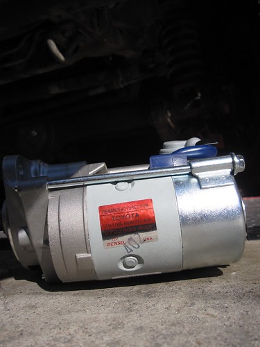

Yes, it's time to start fresh and insist on GENUINE PARTS for the ADV80! So Eric of Yota Masters gets me sorted with his local Toyota dealer to get me in So, next day I'm out to dealer to pick up a new starter, exchange my core and be on my way!a starter for Saturday delivery and that I can pick up as the Yota Crew would be in the desert. Fair enough for me!

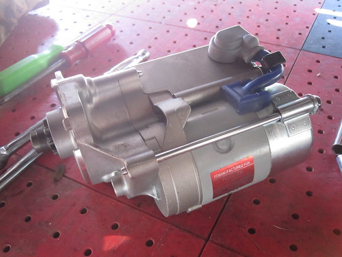

So, next day I'm out to dealer to pick up a new "factory-freshy-re-built" starter, exchange my core and be on my way!

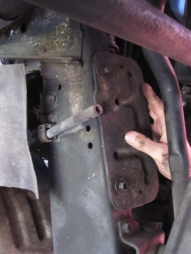

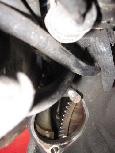

That is where the starter has to go back into...

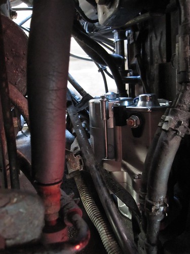

Time for me to get back down in the floor... Starter ready to be mounted back in from the underside of the truck.
Wrestle the starter into position and get it bolted down and wires re-attached. Should be ready for action.
Put the splash-plate back into place.
My ADV80 is now happy now that it has a freshy-starter!:)

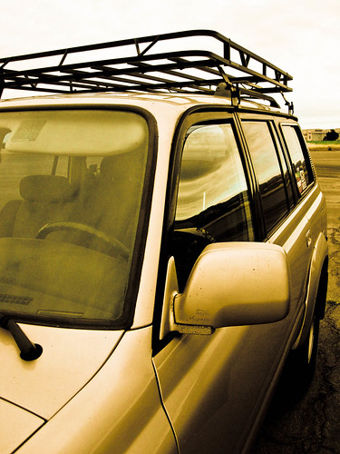

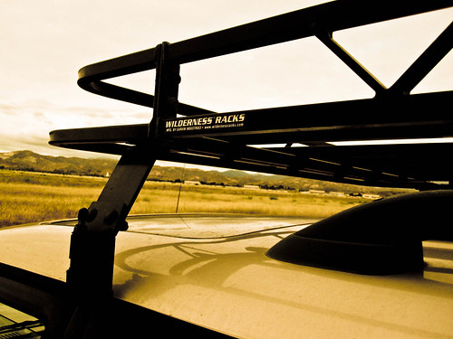

Added Roof Rack - Wilderness Racks
I have had this roof rack for some time now.. It has been hanging for way too long in the garage - holding up a bunch of junk and was time to move junk out!
I have yet to remove the factory racks. I will be getting some shorter replacement bolts and remove the racks and replace the screws with shorter screws, but I have to take out a couple of stock bolts and find out what the thread pitch is, so that is more time searching... hey "bolt guys!" Any "short bolt kits" available?!
Now I just need to get out and make use of the rack! Work Work Work!!!

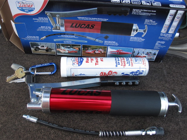

So, did I listen to the thread and buy the "BEST?" No, I bought on impulse. I was at Home Depot picking up some stuff while setting up our booth at XGAMES LA. Saw the grease gun, recognize Lucas, say the "Lifetime Warranty" on the box and thought what the heck! I just need to get it and get some grease into my drive shafts.
Lucas Grease Gun $24 Dead Presidents @ Home Depot. Tube of Lucas Grease was extra.
