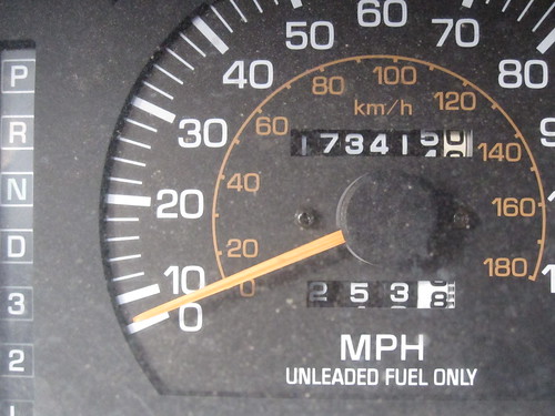

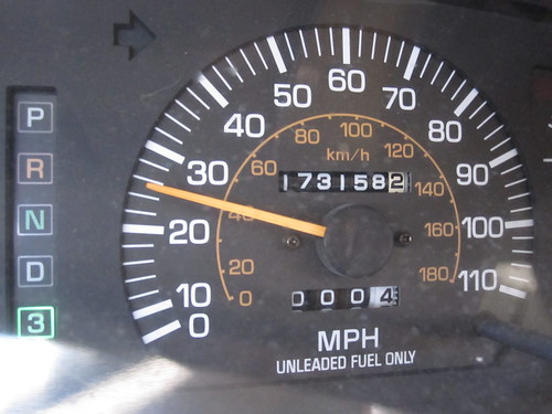

Speedometer cable replaced
WOW!!! UCBerzerkeley is crushin' my spirit! OK, I get it, GET BACK TO WORK HERE - DO WORK SON!!! I'm on it!!!

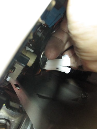

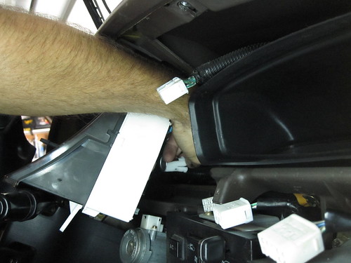

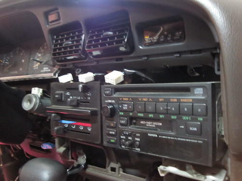

While my speedometer is not been metering I now have incentive to get it fixed! SO, off into the dash I go!
Getting to the gauge cluster behind the steering column can be a bit of a task and several dash plate pieces have to come off in order to get to where you want to be - behind the gauges, just to even check if the speedometer cable is connected or broke or both.
This is where the speedo-cable hooks directly into the back of the gauge cluster.
While I disconnected the speedo-cable at the bottom on the transmission side after checking the gear drive inside the tranny, I clamped the speedo-cable with a clamp and twisted the cable at the top to see if the speedo-cable was broke and SURE'NUFF!!! BROKE!!! Luckily I had ordered everything speedo-cable related from CABE Toyota so I just replaced the whole cable.
Toyota's are beef eaters! Sorry UCBerzerk... If it ain't fun, it's not worth it!
This is a happy sight!!! Speedometer is metering!!! Now I can get on with some test evaluations...

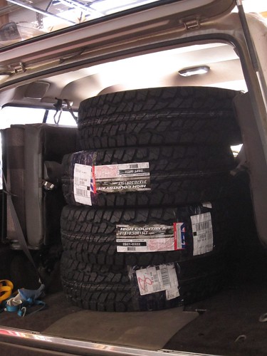

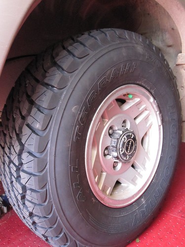

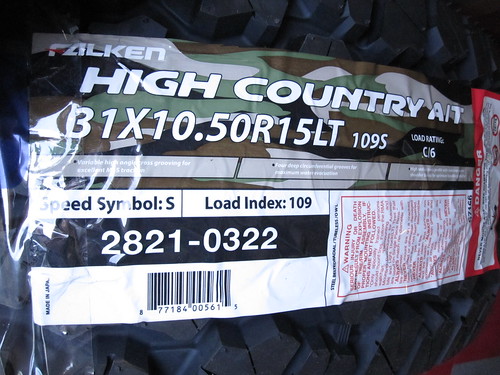

Falken High Country Tires are on the ADV80!!!

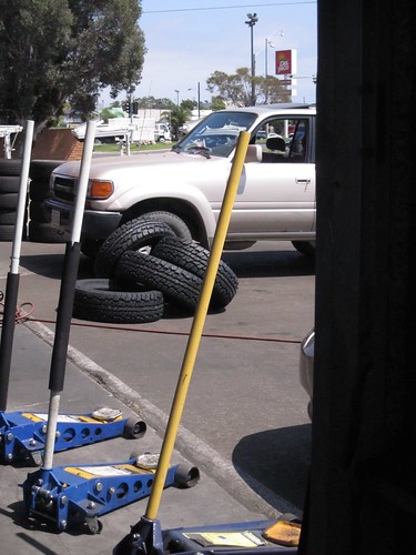

I FINALLY loaded up the tires and when to have them mounted! Finally, as I finally got my speedometer working again!!! Had to replace the whole cable!
ALLEN TIRE CO. [Costa Mesa] is the place I have done all my tire work as they where the only guys in Orange County that knew how to mount Michelin Rally Tires properly. It's not easy and they knew how, so I have stuck with them as they do great work. Funny, this is the place where I spotted the Land Cruiser for sale, of which I bought!
Falken Tires installed at mileage: 173,161

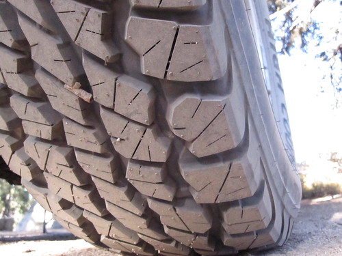

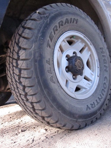

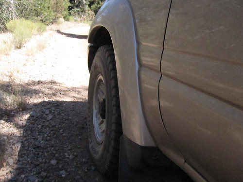

The Falken High Country's are already at home in the dirt!!! As soon as we hit dirt on Middle Control Road off the HWY38, even my girls noticed the difference in the ride on the new tires and they commented on how "NICE" these felt on the dirt road. They do ride very "nice" in the dirt and gravel!
The Falken High Country's ride "normal" and quite on the tarmac road up here, but in the dirt is where they have a more noticeable difference in ride. Soft but firm is the best thing that comes to mind... The Falken High Country is a more aggressive tread design with wider siping and larger tread blocks than most original equipment tires. These puppies walked up the 1N54 easy as well. Not that this is a "crawling" road, but I do deem this a very suitable ADVENTURE TIRE and perfect for my adventures!
The Falken High Country's while at first have a "mild all terrain" look, upon closer inspection, do have larger blocks on the outter-edge's and large negative spacing thus making room for rugged terrain traction suitable for mountain conditions. It's not a mud-terrain and they are not rock crawling tires, but again - very suited for my overland vehicle-dependent expeditions and mini-adventure travels.

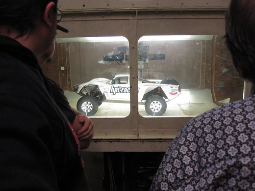

Wind Tunnel Testing at SDSU:
Students at SDSU doing some wind tunnel testing with our HPI RACING Baja 5T, custom built by ScottG of PROTECTA.

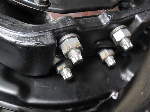

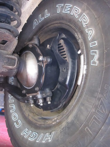

Front axle is rebuilt!!!
So Yota Masters wasted no time at all on getting my front axle knuckles rebuilt! In one day and out the next and it was only a two day deal due to other issues such as the oil pan gasket replacement, brake job and a couple of tie rod ends not participating in the removal process.
A little discovered hick-up along the way:
Passenger side Steering Knuckle had 12-1.25 thread pitch studs rammed into the factory 12-1.50 thread location. Yota Masters drilled out the messed up threads and inserted Timeserts and replaced the studs back to factory spec threaded studs.

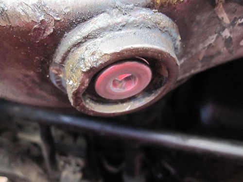

While servicing the axle:
A 10mm Allen Plug to replace the lower hanging factory plug for the drive shaft pumpkin. My stock plug bolts had been chewed up so bad by the previous owner, it took Yota Masters some muscle and chiseling talent to get the stock drain plug out.
DPD: Dead-$-President-$-Damage
Front axle knuckles rebuilt by Yota Masters $450 [labor]
I provided the rebuild kit that I got from Cabe Toyota with my TLC member discount.
Drill/tap Timeserts $127.50 [parts/labor]
So, the front axle is all nice and rebuilt!

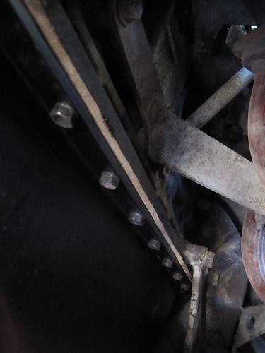

Next to sort in the front end department is to replace the Tie Rods Ends. Yota Masters attempted to replace the the Tie Rods Ends, but they are seized into the tube ends. A new Tie Rod is $300 from Toyota and our salvage yard had nothing on hand, so I have some unfinished business here and these need to be replace very soon!

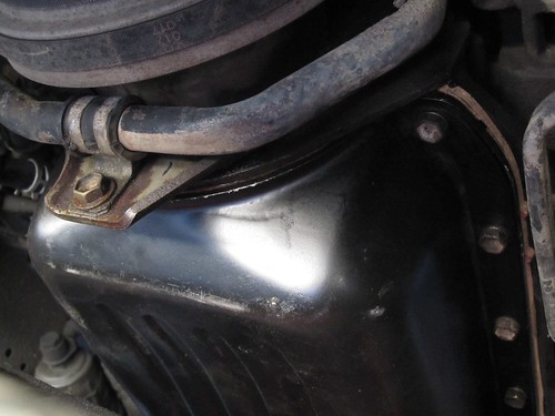

Oil Pan Gasket replaced $127 [labor]
I provided the gasket from Cabe Toyota - TLC Member discount.
New oil pan gasket!!! YEA! My truck is not leaking oil everywhere! I can park in friends driveways, I can change my parking location at work and will not be embarrassed by the dead dinosaurs I've been leaving on the surface wherever the ADV80 had stopped.
