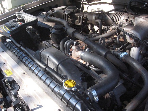

Laguna Viejo Auto Service gave the call on Friday and said come get it!!! $2,550+ dollars for a bunch of hoses, water pump, pulleys, brackets and a new radiator and I am ready and out the door!!! The decision was made to just change, I think 8-9 of the 14-total coolant system hoses that will need be changed. I went in thinking is was going to be like $600.00 so the budget got ambushed!
Pop in the rig and drove home - nineteen miles one way from the shop to my house.

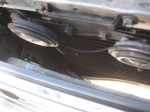

Popped open the hood to show the wife the spiffy new radiator and hoses and such.

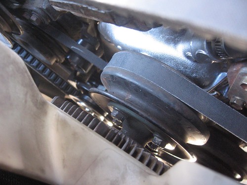

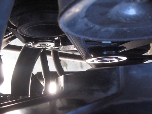

new water pump and belts.

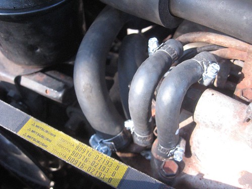

New hoses.
Got some new pulleys, some new belts.

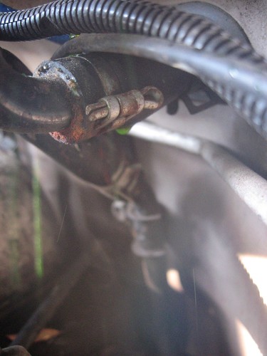

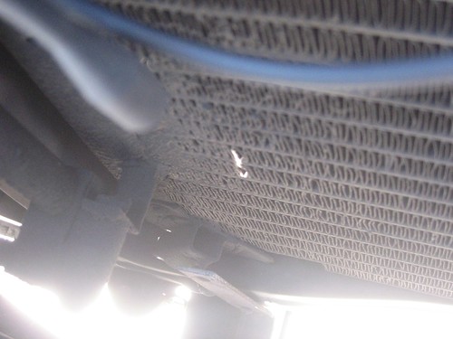

Telling the wife we have some more hoses to change and that the shop showed me why the A/C might not be cooling.
Tell tell sign of why the A/C is not working - See how the dirt is caking up on the condenser... All that is going to be another very expensive expense...

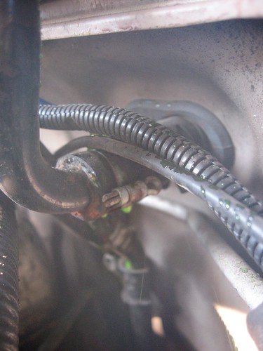

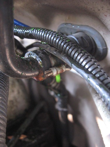

As we are talking, we here a HHHHHIIIIIIISSSSSSSSS...
and a drip drip drip drip drip drip drip drip drip...
and some steam..
The next culprits to ooze the anti-freeze and make that funky smell that is no good to smell...
burning radiator fluid dripping onto the header tubes below.
Seems the little rubber tube that goes into the firewall just decided it was jealous of all the new hoses moving in and he wants to move out. Best way I know to get kicked off the team!
These old dawgs are "FIRED!!!" said in my best Donald Trump impression. Now if I could just impersonate his Black AMEX!!!
YEA, I'm WAY UPSET!!! Just trying to maintain "cool" hahahha as I knew I would be getting into some mess!
Well I got my 91 with new hoses and radiator but blew a head gasket, so it could be worse.... That hose is just 5/8 heater hose. Just get a piece and 2 clamps and for less than $5 it's fixed. Mine was leaking too.

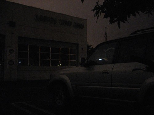

Saturday - no wheelin!!!
Friday night I could not sleep just thinking about the fact that I would not be wheelin' with the kids on SATURDAY and the FACT that I just spent a BUNCH OF MONEY and it's still not FIXED!!! And it's a weekend I am NOT WORKING so I was looking very forward to wheelin'...
So, I get up way too early, made some coffee, threw the bicycle in ADV80 and made the 19-mile trip down to the shop and dropped it off. Laguna Viejo Auto Service will not be able to touch it until next week, but at least I do not have to look at it all weekend and have it pee'ing anti-freeze all over my town-home associations driveway...
I wanted to get some peddling in anyhow so I thought I would just drop the truck off and peddle back as the shop is located just off Crown valley Parkway and the 5FWY. I would peddle down Crown Valley to PCH and back up to my house in Costa Mesa. The ride was well worth it - RELAXING and got my mind off it for a bit. Called the wife early and asked if she and the kids wanted to meet for breakfast before she had to go to work. Food is always good to take the mind off things!
