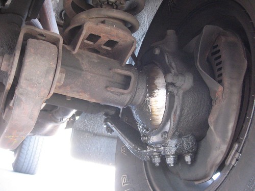

Going to be fixing this soon!!!
And now I have this newly added feature to fix as well:
So, parts are ordered and getting ready - MENTALLY!

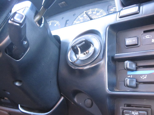

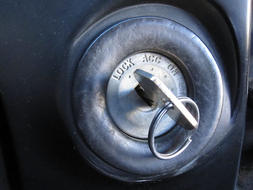

Ignition switch sticking
Well, I guess it's bound to happen at some point..
Wife called all giddy to tell me that my new tires showed up at the house!!! After work... get in the truck, insert key and NO GO!!!
I wiggled it and after about 15-minutes of fiddling with it, I'm over it! But I got new tires!
I wonder if I can get new keys from Toyota based on my VIN#?
I wiggled it and after about 15-minutes of fiddling with it, I'm over it! But I got new tires! I'm going out of town on business for a week, so we will see what happens when I get back.
I am pretty sure you can get the keys from Toyota.

FWIW I thought my key was sticking but it turned out that the shifter doesn't always seat completely forward into Park. Pushing it a little towards the front of the truck and then turning the key has always worked.
New FACTORY Key for Toyota Land Cruiser FJ80
Got my new key in the mail last week while away on business.
The old key, of which was a copy, just wore out. Called my buddies over at Cabe Toyota in Long Beach where able to use my VIN# and proof of ownership.
THANK YOU ROGER MAGANA of CABE TOYOTA!!!
IT WORKS!!!
AND FLAWLESSLY EVERY TIME! Yes, this has fixed my issue that just seemed to "all of a sudden" start happening a couple of weeks ago and to the point where I could not drive the truck home from work.
