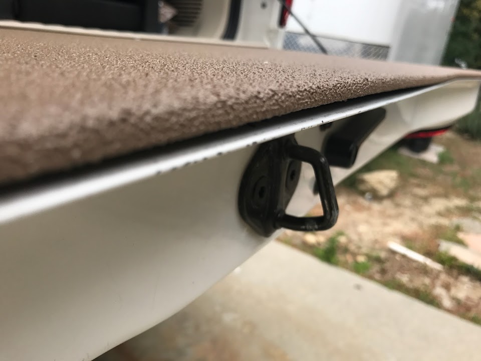

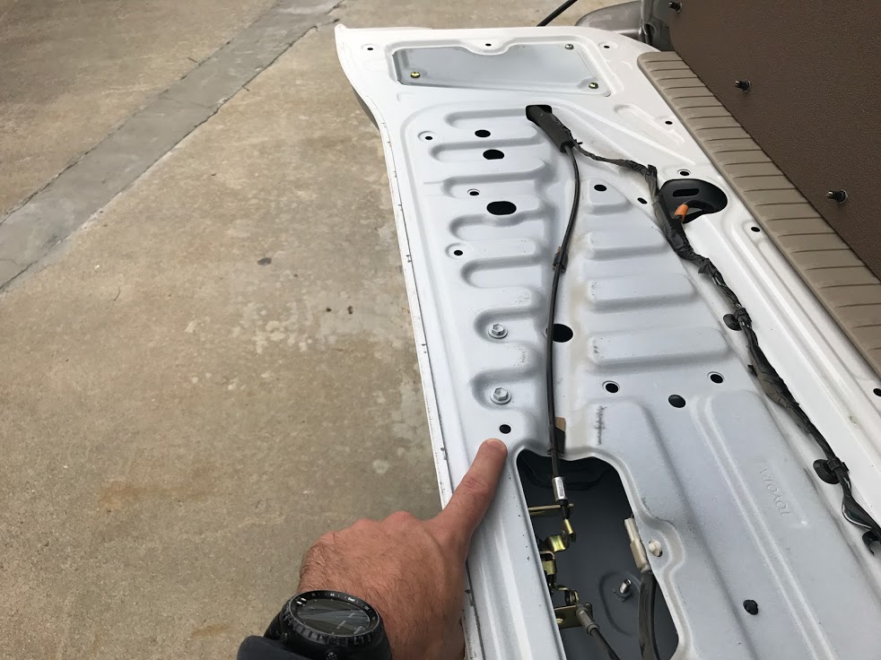

@TrekboxX I just got my tan line-x and it looks great. I'm installing it and the front middle of the cover would not go flush. I looked and its the only hole in the tailgate that is not recessed. Any advice? I tried not running the two washers on that hole and its still not flush like the rest of the cover.

Don't put washers on that hole.
Upon installing mine I noticed that the lip of my tailgate is a wee bit bent in a couple spots. That might explain some variation the gap.
As you did and as advised, I skipped the washers on the center upper hole.

Sorry guys- I don't recall the center hole not being recessed- I'll change the instructions for future orders. The washers are only there to keep the well nut down in the recess so it bulges at the correct spot.

As mentioned in my post its still not flush without the washers due to the lip of the well nut. I might try cutting that off. Am I missing something or did this get missed in production? The tailgate is completely straight. Thanks!
I would not cut the lip off the well nut. If it spins in won't work, and the rubber lip keeps it from spinning.
I had to put quite a bit of pressure on the panel to hold it down while tightening the nuts. Maybe try again?

All of the holes in my tailgate were recessed. However, I only needed to add 1 washer to each of the well nuts instead of 2 to get my cover to sit completely flush.
