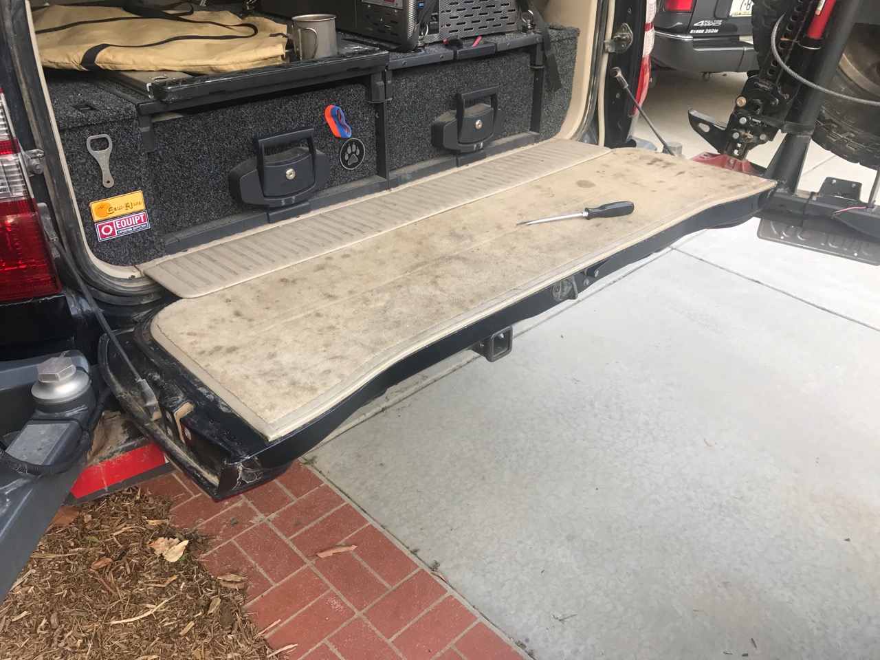

Installed mine this weekend in about 10 minutes, probably less. Here's how things went.
Step 1: Pry up the original stained and nasty tailgate cover. All the tools required for removal are pictured; Bottle opener, cup filled with your favorite beverage, and a screwdriver (screwdriver optional).

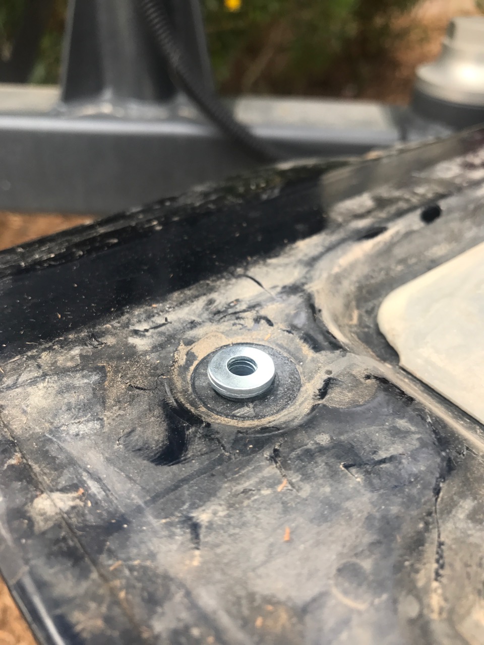

Step 2: Drop the rubber pieces with the threads into the 16 holes and stack 2 washers on top of each. Most people might wipe the dust off the tailgate.

Looks great! Yes, that will work on the install, but if you attach the well nuts, screws, and washers to the tailgate cover first (only just snug) you will avoid the occasional issue of the well nut spinning and not gripping the screw, which requires taking the whole thing off again.
