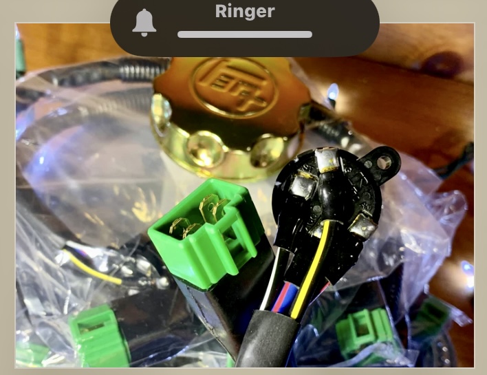

Below is a example tech image of a Elec key switch
Is this the sealed unit you cleaned and Lubed ?

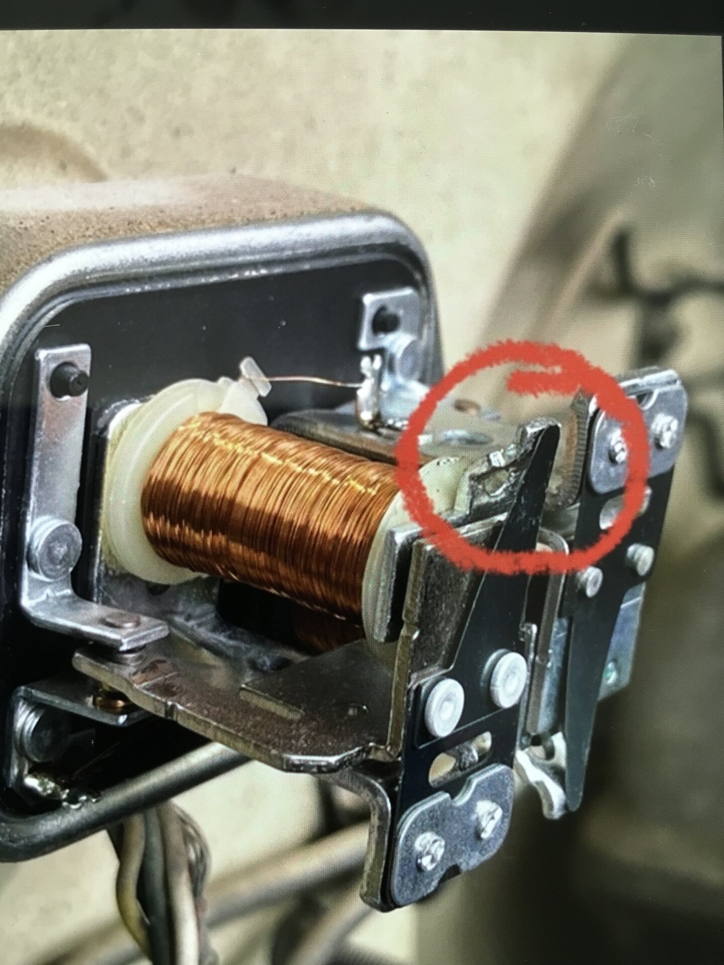

Lastly how and what and why did you adjust your voltage regulator ?
Old old Toyotas did have a little flat head theaded rod you could tweek
I have not seen one in 20$ years ,?

Hi Matt,
Those ignition switch units look slightly different, I’ll try to take a pic when I get a chance.
The adjustment I made in the voltage regulator was to the gap in the photo below, kept bending the arm on the left to the right until it would keep voltage up to 14v before switching back down.
Seems to have done the trick!
Hi Matt,

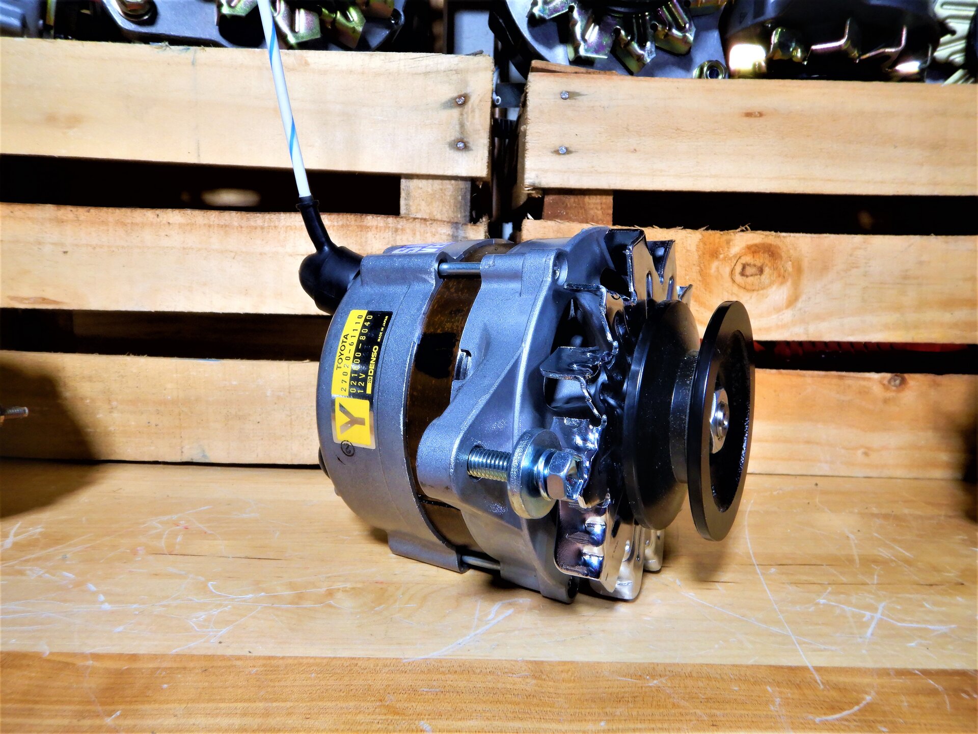

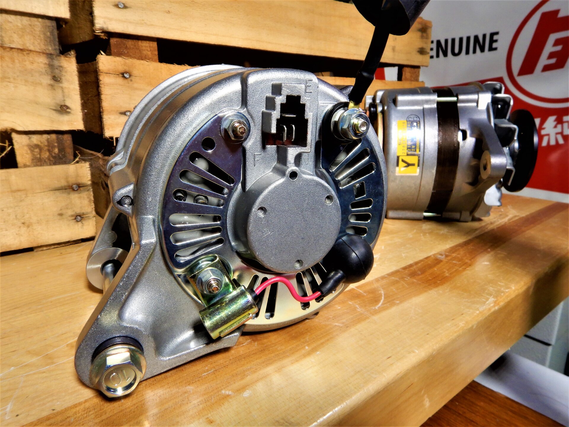

if you have a : Saudi spec 1982 FJ40 with a 2F , ?
this is the correct Toyota genuine part #
now back to the voltage regulator .
the new era one in the first post , ?
show me the plug connectors please >?
both sides
this is very important
thanks
this here below please ....
Lastly ,

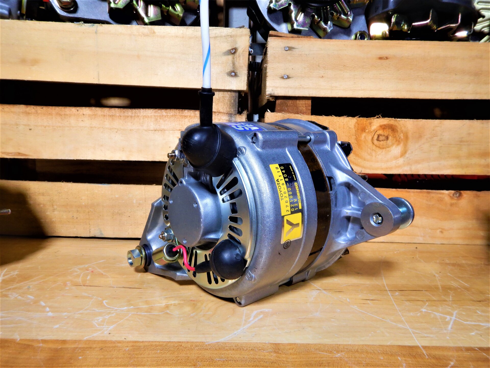

the general countries 2F in saudi Spec region will look like this below
i need a good up closes and personal photos of , the rear where the ring terminal and input plastic connector go
the side and the front
put camera plumb level and square
i need several pics of rear one of side and front is good
your alternator is Drivers side lower on LHD mounting location .....right ?
