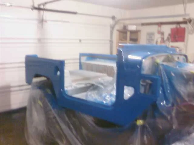

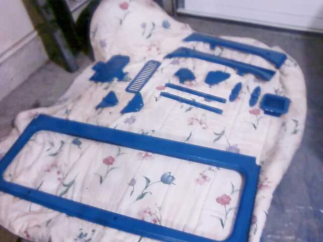

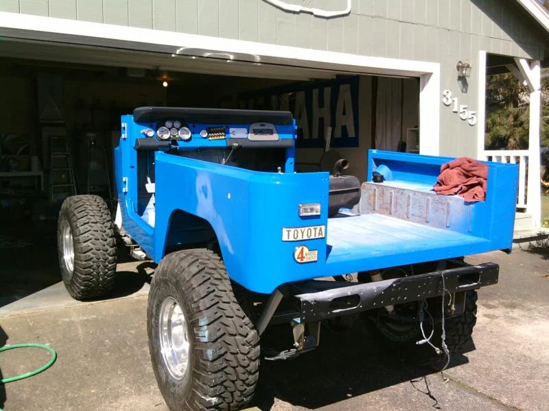

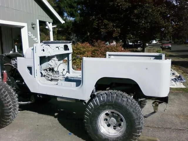

I painted my 40 in my garage for under $500. Thought you guys would like to see my results. It took me about a year... I would get real hot to work on it then life would take priority... I am sure you all have experienced some of the same issues! So here is what I used:
-harbor freight HVLP gun #94572: $49.99
-1 gallon single stage Valspar 860 series paint: $148.15
-1 quart standard activator: $53.50
-3 liters UPOL flyweight gold filler: $23.95
-1 pk UPOL Dolphin glaze: $11.00
-1 gallon European coatings primer: $50.00
-1 quart medium primer activator: $25.00
-1 gallon r859 wax and grease remover: $23.50
-1 box of premium tack cloth: $10.00
-1 half face respirator: $18.11
-1 Rigid random orbit sander #r26001 $69.99
My air compressor is a Devilbiss 5.5 HP 20 gallon tank. Definitely not enough air to run a D/A sander:censor:, that is why I bought the Rigid Random orbit sander:confused:... I did this on a budget so don't flame me!
X2
That looks fantastic. How many coats are on there?

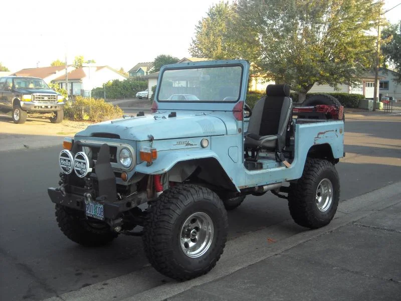

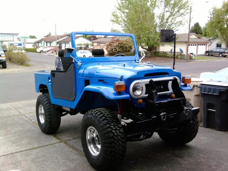

I sprayed the hood with four coats of color... I promptly sanded right through to the primer when I feebly tried to wet sand out a run... So i think all in all I have seven coats on the hood and four every where else. This has been both satisfying and horribly frustrating at times! All in all I am stoked. Here is a before and after... Notice I corrected the bezel!:flipoff2:

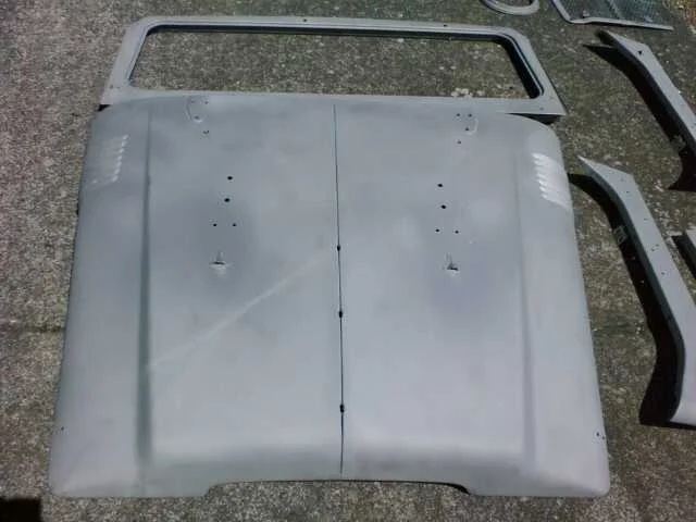

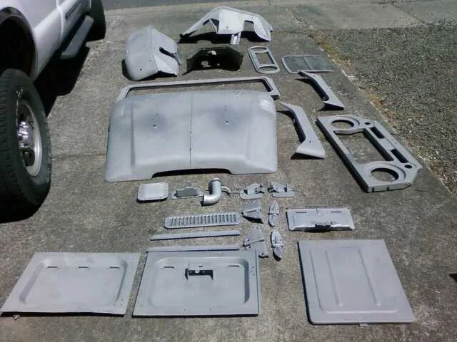

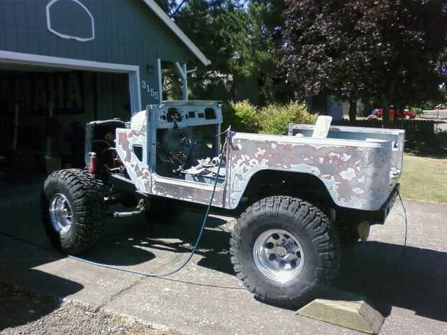

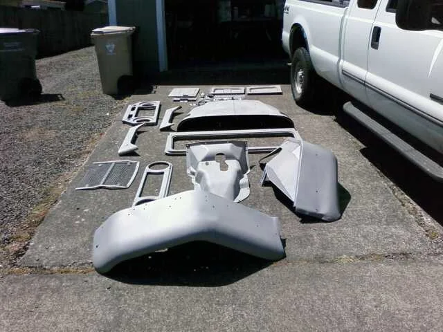

Thanks guys! I got real lucky on this tub it had some dings and scratches but was virtually rust free. I took all the small parts down to sandblast, then sanded the hell out of my tub as you can see by the pictures above... I am stoked to know that I have a rust free solid 1969 Cruiser!:beer: Here are some of the sandblast pics. I had Oregon powder-coating inc do the sandblasting. They charged around a hundred bucks for it all... They charge by the hour so you can get a good deal. I shopped around and another local guy wanted like $400:eek:... Pretty easy decision!:cheers:
VERY nice paintwork man. I take my stuff to AKIES here in Salem, but I may take a look at your guy next time around. Looks like a clean blast. AKIES is a way fair price too tho.
That HLVP gun from harbor is actualy real nice. I have used it in the past.
How did you like the UPOL filler. I used the same on my current build and thought it was great.

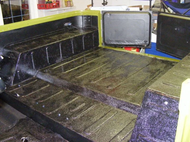

What bedliner did you use?

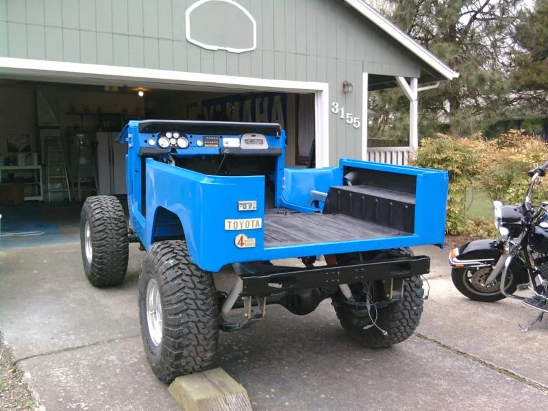

This was my first time painting a rig... I did a ton of research, however price was my main factor in choosing products. A friend pointed me in the direction of Painters supply in Salem. Tracy up there was a HUGE help. I really liked all the stuff I used, however I don't know any different!:meh: My interior appears to be bed-lined, it is not... I was too chicken for a Do it yourself bed-liner. I heard they are terrible to get off if you screw them up. I used a rust-control spray enamel in flat black. It is a cheap rattle can that will buy me time until the budget allows for a professional bed-liner!! Here is a before and after.:cheers:
The rustoleum bed liner is more like a paint. We used the rustoleum and thought it just looked like thick paint and then went over it with Herculiner and it looks great. Its really pretty easy...don't be afraid to try it. My only suggestion would be to buy the tape with the wire in it for a cleaner edge.
Do you have any pics?
Here's two.....the one of the bedliner......that's Rustoleum on the rear doors...and the bed is Herculiner over Rustoleum.
