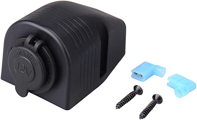

The USB ports have to be a flush design like this correct? There isn't any room under the grill to do a cig lighter or a higher powered USB port.
Something like these would work. Also, you could probably drill through the plastic if you just needed an inch or 2.
Something like this might be a good option. Looks like you could even remove the 12v port form this and install your device linked above.
Amazon product ASIN B07JL3DLNL
Also comes in multiple ports.
Amazon product ASIN B01DXD0SCA
That's an interesting idea for sure. I was googling the heck out of "flat" or "flush mount" options. I was getting frustrated that Blue Sea or any good name brand didn't make anything besides the deep socket versions. This would let you use a deep socket but in a horizontal orientation. Hmmm, not sure if I'd still prefer them to be flat when they had nothing plugged in for the daily. I'll have to think on that but thanks for the ideas. I may just order a few variations, see how they look in person and then just return what I don't use. Today's project was just painting the panel
