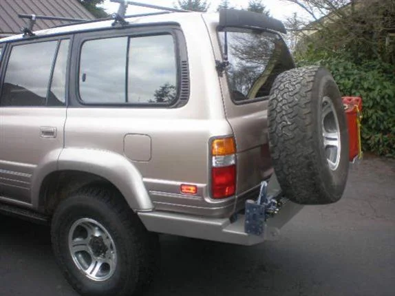

I stole this from another thread. It shows the quarter on an lx with the trim still intact
Boy....I think I am below that trim that runs horizontal and butts into the fender flare. You can see they removed the mud flap, just like my design.
Then count me in as interested with a tire carrier

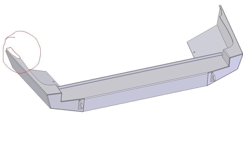

The area you have circled, you would want that filled in?
The shackle mounts will be bolted to the frame rail. They are considerably bigger than the shackle mounts I have on the FJ60/FJ62 kit.
... Would use 1/2" thick recovery points that would be bolted straight to the frame rails (requires removal of the factory bumper mount).
