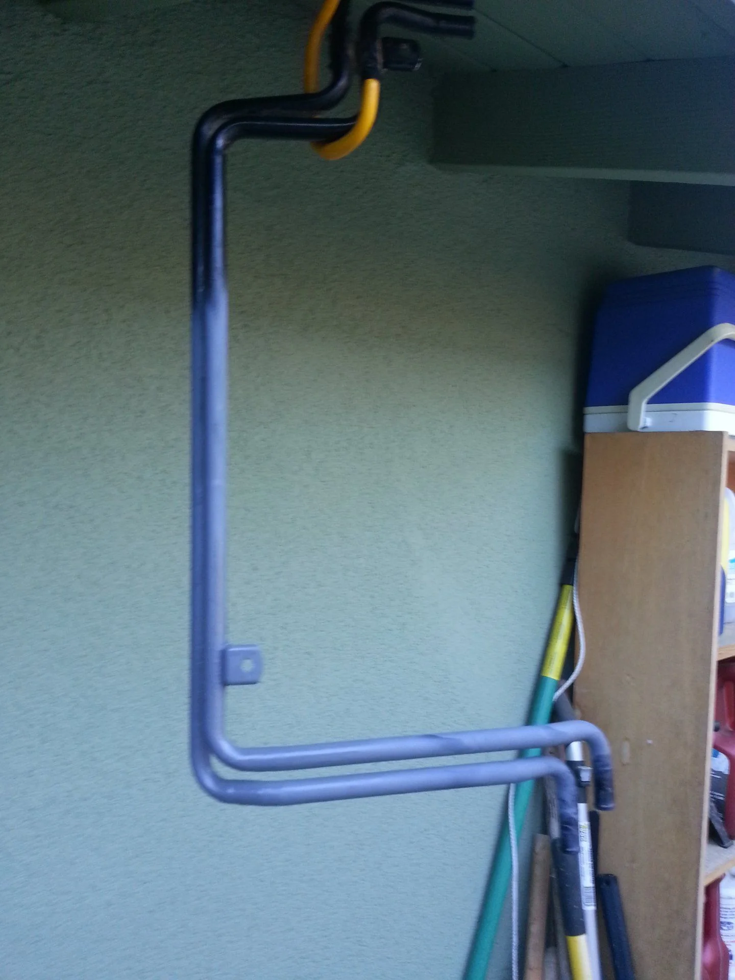

So I made some progress on this last night. When I got home I got back under the truck and realized that if I just rolled the hard pipe over the cats and under the body toward the exterior of the truck, they would come out. Once I got them out I realized they looked like crap and needed derusting and painting. I live in SoCal and these things were in medium bad shape, IMO. For those of you in rust states I can't imagine you could do this job without replacing the hard lines and feel good about putting the hard lines back in.
So, I hit the hard lines with the abrasive wheel on my drill, and with the stainless brush wheel on my bench grinder and got down to some cleanish looking, though pocked, metal. To the touch it still felt sufficiently strong, so I hit it with 2 coats of UHT rust inhibiting gray primer and two coats of UHT flat black rust inhibiting paint. My 7 year old helped me paint, so I nearly wore a coat of primer myself and there were plenty of drips. Who cares, right? He had fun, which means we had fun.
Tonight I get the clamps and tomorrow the pipes go back on, then I drain the radiator and flush the system twice (don't forget the block drain plug!) with distilled water before I refill with half Prestone green and half distilled water. Most pics to come.

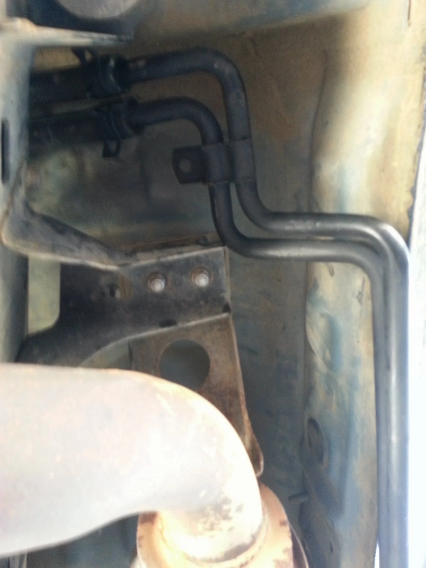

Okay, I got this job done and it wasn't so bad. A few observations and a few pics here. First, the only way I figured to get the hard lines threaded out of the truck and out where you can assess them, paint them, etc., is to slide the lines rearward about 4-6 inches after severing the four hose lines, then roll the entire hard line assembly outward over the frame rail and between the frame rail and the lower pinch weld of the body. It's tight and you'll need to manipulate the attached soft lines a bit but it will come out with no damage to the hard lines. Here is a pic, the bottom of the pic as it sits is the front end of the truck, top is rear end.
Also, because I was using Gates Green Stripe 1/2" ID hose (not the OEM 13mm) the OD of the hose I used caused a couple of problems. First, when I had the hard lines on the bench I could not get both new soft lines on the rear end of the hard lines because they sit just a little too close together. So, I used a pry bar to very gently spread them about 2 mm further apart. That's all it took to be able to get both hoses and clamps on, though it was tight.
Also, the lines which come out of the bottom of the truck and mate up with your soft lines to connect with the rear of the hard lines also sit very close together and I had some clearance problems there, too. I wasn't able to get my clamps to sit right next to each other because of the tightness, and I didn't want to try and bend the brass tubes coming down from the truck for fear of breaking or bending them out of round. You can see I got a good seal with each clamp sitting full on hose and above the flare in the brass lines, but my preference would have been for the clamps to sit right next to each to each other.
