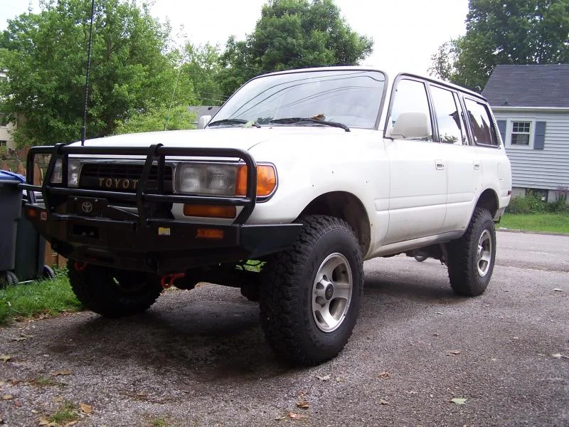

Below is a link to the thread on when I had just installed 255 85 16 Cooper ST's. I am running OME heavies and I prefer the tall skinnies. I am a fan of Cooper tires. These did real well all around. They did get pretty noisy on the road towards the end of their life. I did get a lot of miles out of them though. Seems like it was around 40,000 miles.
A deal popped up locally I could not pass up for some Nitto Terra Grapplers in 285 75 16 so I am currently running those. They were almost new, maybe 3,000 miles on them at a local tire shop. Got them for $400 mounted and balanced. Like them a lot.

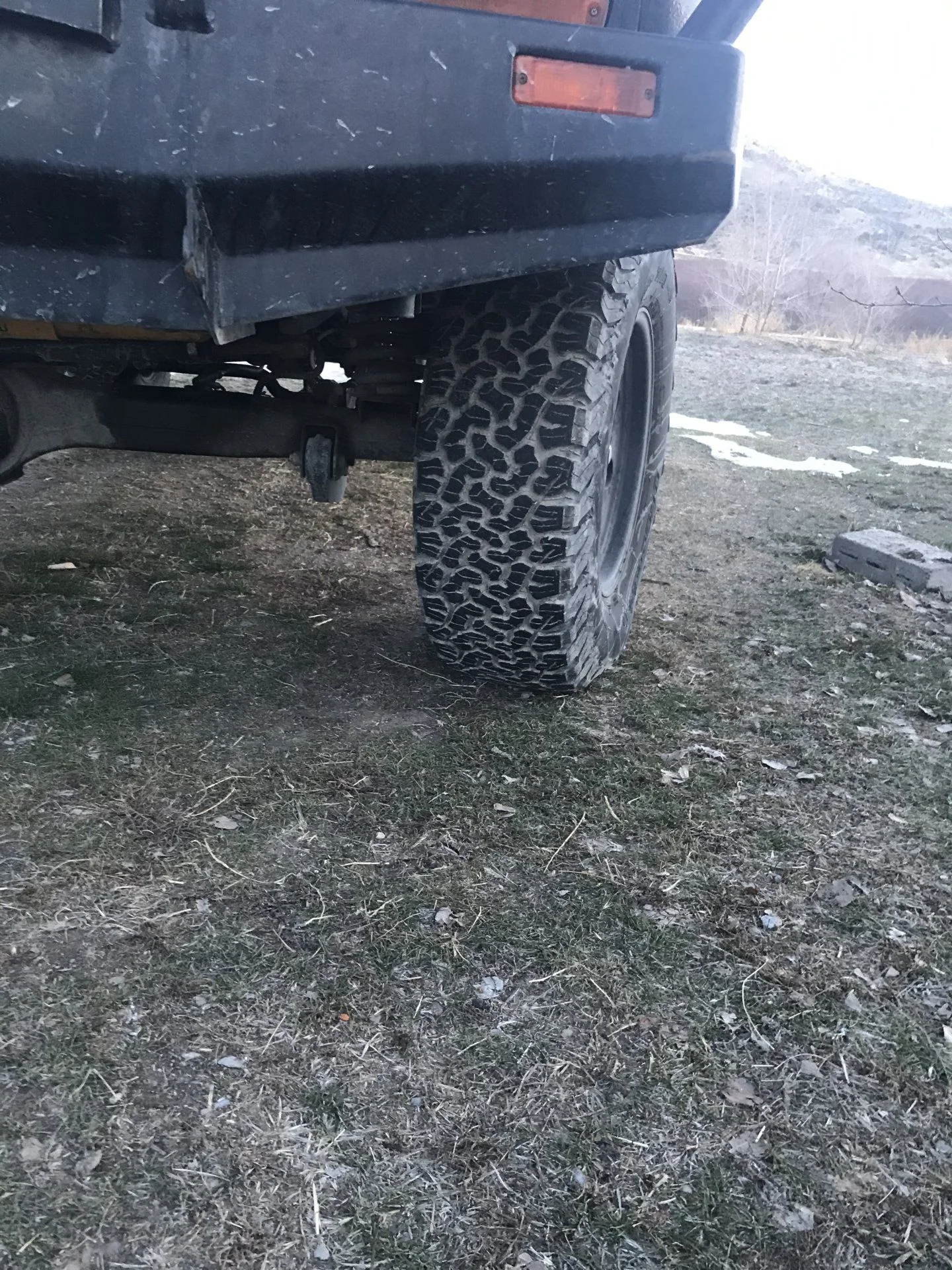

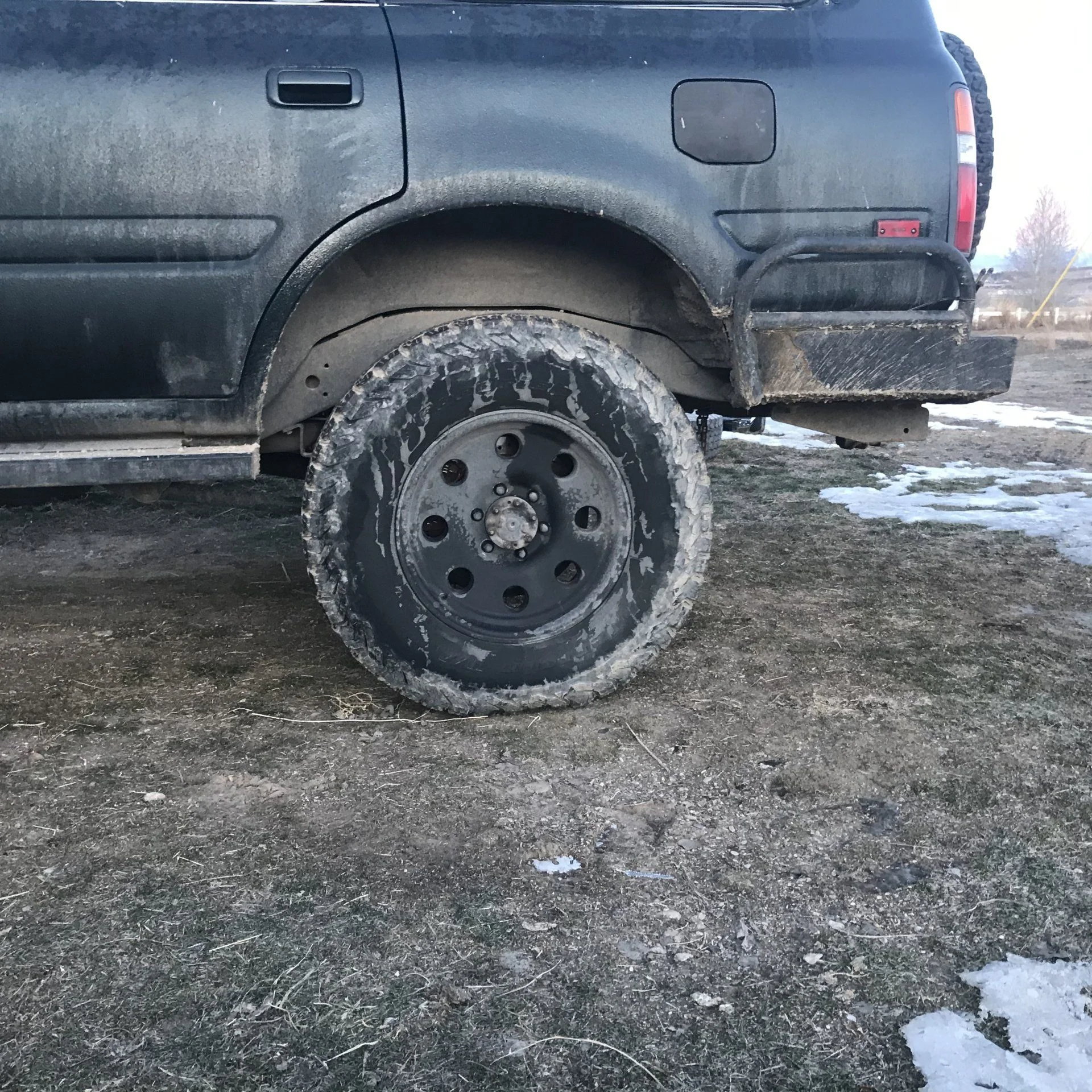

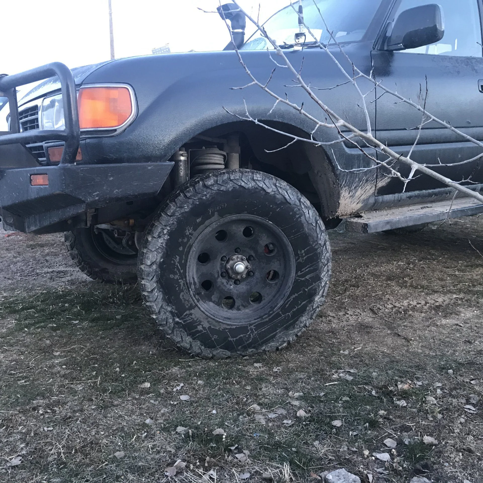

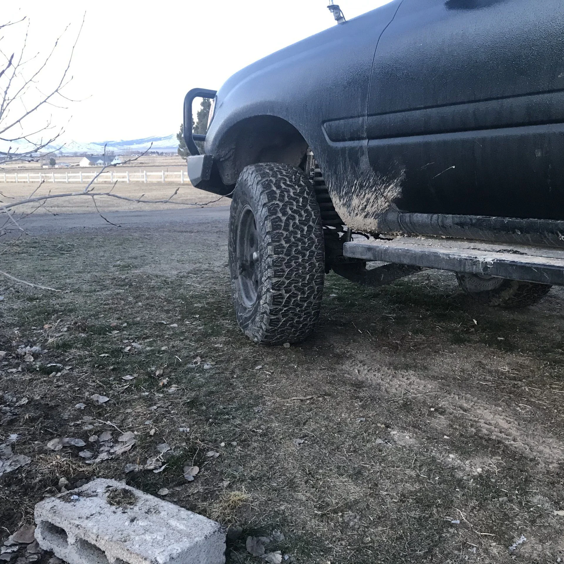

BFG AT KO2s come in 34x10.5r17. I have them on my 97. Will post photo when I get more daylight.

KO2s drive fine, say 34” on sidewall but are really 33”.
They look good on a stock or OME medium suspension. The look tiny under Slinky.
