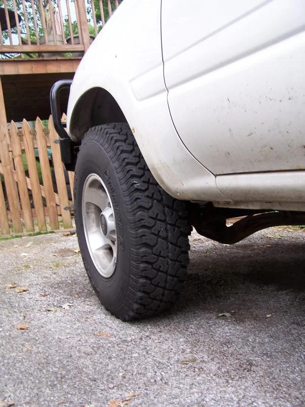

I have the 2.5 OME heavies on with the wonderful help of forum member lukefj. Thanks, you were great to work with and I appreciate all you hard work.
I then went with 255/85 16 Cooper Discoverer ST's, made in the USA.
The spring and shock combo with the Doetsch shocks ride very nice, not harsh at all in my opinion. When I went from the P275/75 16 Michelin LTX tires to the D load rated Coopers, it did hit the chug holes a bit harder. But, they are aired up a lot more than the Michelins. Running 50 lbs in them right now, just have not aired them down any since I got it home from the shop.
I have not done anything for caster correction yet but it drives great. Very little wandering at all. I do notice it from time to time and I plan to do this not too far down the road.
Brakes feel fine too, did not change the LSVP or LSPV (can't recall) location yet.

I am also running the 2.5" OME heavies without castor correction and with stock shocks. The ride is fine for me as well with a tad bit of wandering here and there. Glad I'm not the only one riding without castor correction. I plan on waiting til my shocks blow to get new ones. May I ask why you went down in tire size? Your rig looks good!
The Cooper 255's are a bit over 33" in diameter, 33.2 I think. They are over an inch taller than the 275's I had on here but not as wide. They are a tad taller than the 285/75 Coopers, just barely but taller. I think the 285's are 32.9" in diameter.
I like the old school looks of the tall narrow tires and I think there are some benefits. There are a few folks that run them on this board and really like them so I thought I would give them a shot. The cons are few with the narrow tire, I like them so far. I also read this which just pushed me over the narrow tire edge I was already leaning so closely to; Expeditions West: Tire Selection for Expedition Travel

Hard to tell from the picture angle, is the tire entirely within the wheel well or does it poke out the side a bit? My 285's are very slightly outside the wheel well with no flares.

About flush.
The wheel itself I think comes slightly out past the body but the tread on the tire is very close to flush/even with the outer wheel well. I can get some pictures from down the side.
