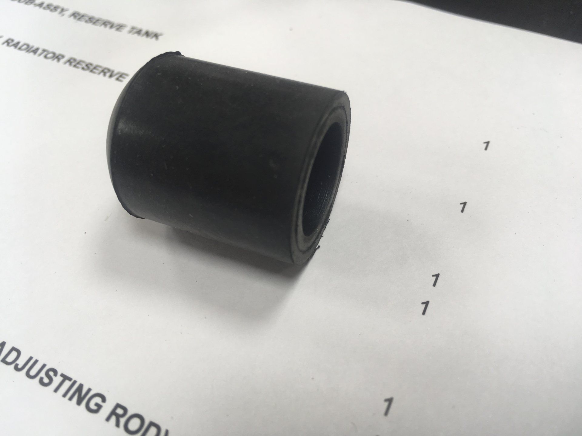

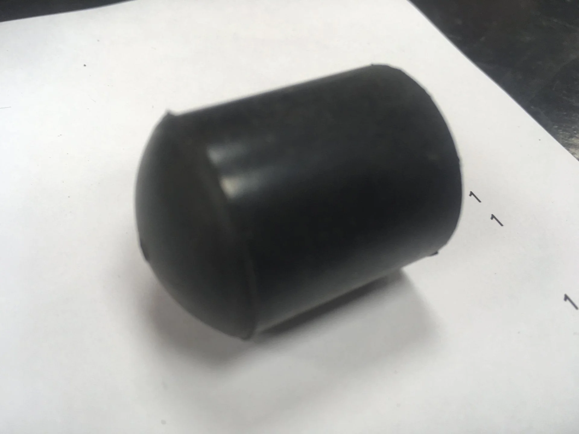

These are the delete plugs I want to use.
No need for plugs

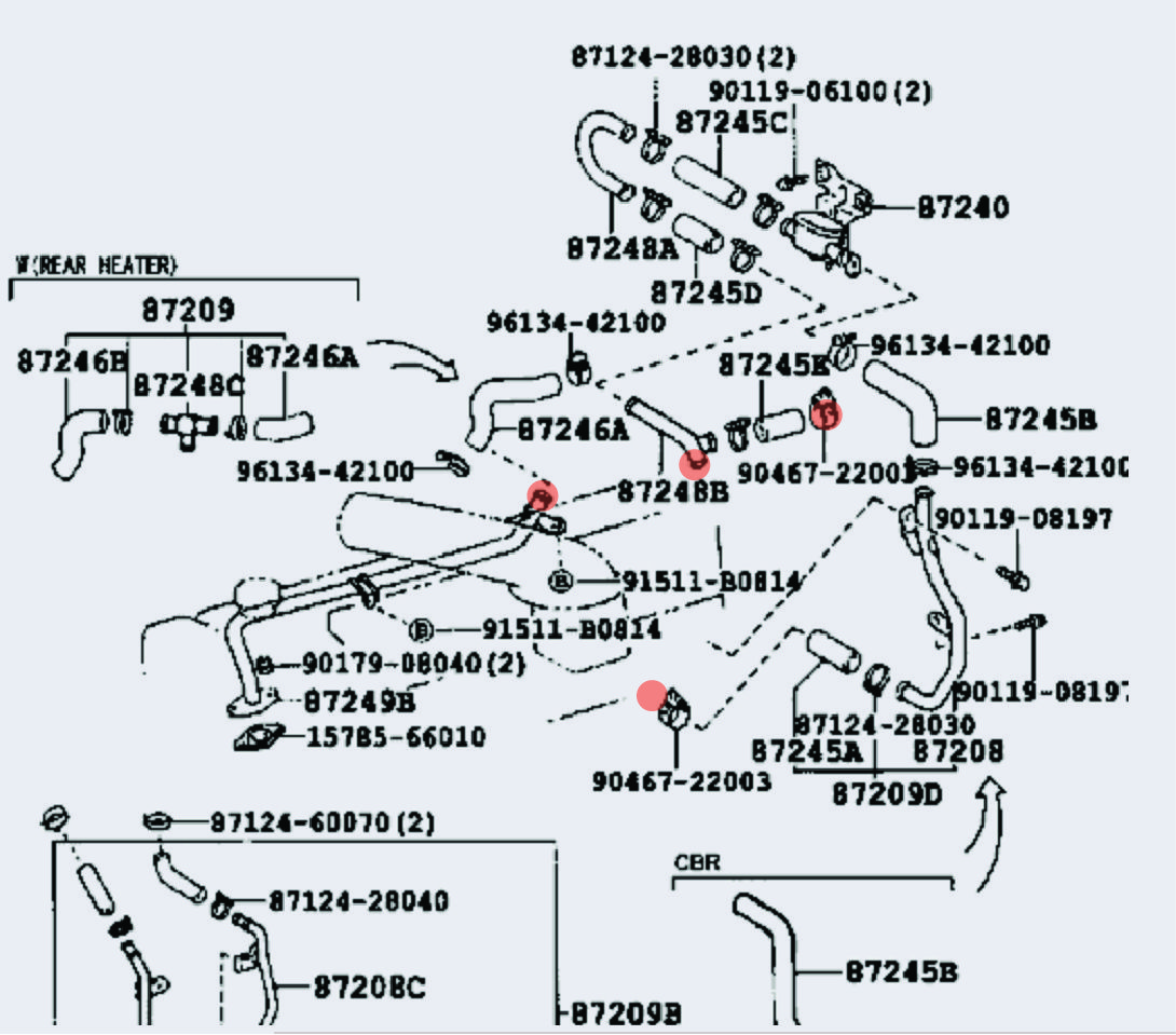

plan on capping the red spots in the image
If you just want to delete the heater altogether, run a piece of 5/8” line from the top of the PHH pipe over to the coolant pipe above the exhaust manifold. Takes a piece about 18” long.
Got you. that way circulation will continue and shouldn't change increase in heat. so a complete bypass of the heater system. Cool

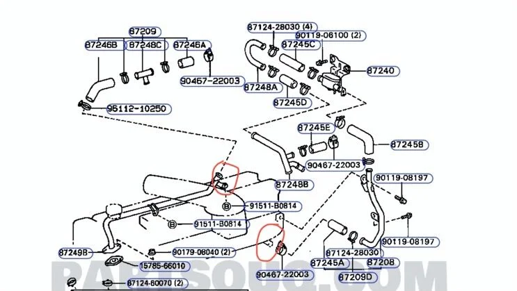

It's just a cap on these two circled parts, right?
The engine block heater water inlet, where the PHH lives, and the heater water outlet pipe?
