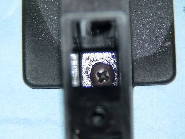

To remove it there are two screws on either end of the deflector/wing,
remove them first. Then you'll see two exposed screws on each mounting
bracket. There is a thrid screw inside the bracket, might need a bright flashlight to see it. You may find water inside that bracket hiding the screws.
So five screws on each side to remove the deflector/wing and brackets.
There will be three nutserts on each side, you can leave those in place
and reinstall the three screws that held the bracket in place. If you remove
the nutserts you'll then have to fill in the holes, sand, prime, paint.
WARNING: IME the mounting bracket screws (if you reinstall them to plug the nutsets) MUST be sealed (I used Permatex thread sealer when I had the wing off to repair rust) otherwise water can get into the rear hatch by working it's way past the threads of the screws.
