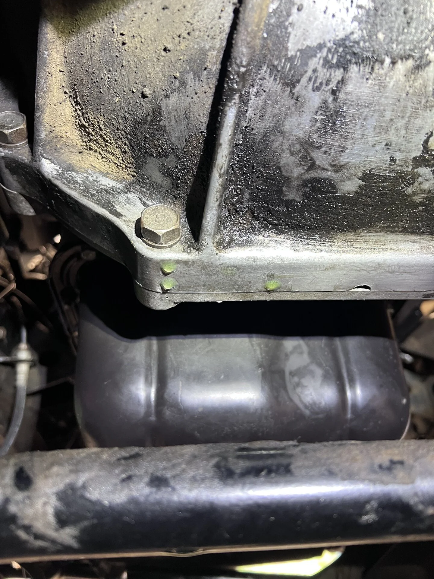

Was it coming out of the weep hole? Just got a rebuild back in, fired it up and checking for leaps and noticed couple of coolant drops on bottom of bell housing and inside bell house it feels damp.
Side of the block is dry save for a small weep were I replaced the brass coolant drain plug with the 100 series one. Firewall is dry.
I’m really hoping this it isn’t what I think it is but anything else to rule out?

If it’s coming out of the bell housing it’s most likely the freeze plug, that’s the only place coolant can leak from there. I would try to clean it up and perform a coolant pressure test.
