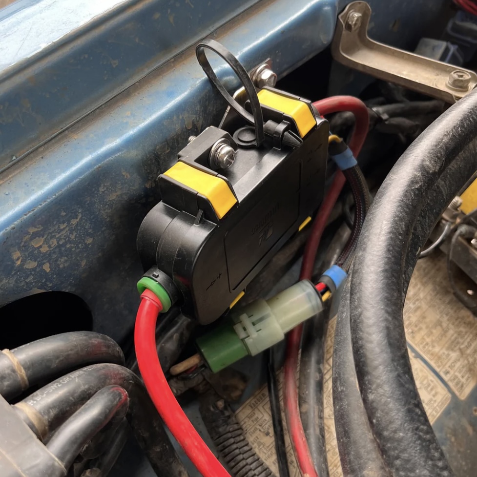

Thread revival and plug… I now offer a plug & play solution for moving beyond the OEM fusible link in an FJ60. Probably works for a lot of engine swaps too with little to no modification. Currently still working on the FJ62 variant.
With this kit I’m typically seeing folks have 0.5-1.0 higher voltage at idle - less (or no) headlight dimming & wiper slowing sitting at a stop light in other words. Upgraded & cleaned grounds help too of course, and a lot is dependent upon the state of any given trucks wiring with respect to how corroded it might be. Electrical can be complicated but this kit I have is easy.
What it is:
Littelfuse 3-pole IPX7/IPX9K sealed/waterproof fuse panel (rated for direct high pressure spray)
Littelfuse MIDI fuses (supported by Littelfuse’s lab testing, unlike untested Amazon junk)
Ancor marine grade 6awg main power cable (and optional alternator charging cable)
Connector snaps right into the factory wiring harness
Brand new Yazaki wiring (just like Toyota originally used on the FJ60)
Custom stainless steel bracket to attach the fuse panel into threaded holes in the body
Overland Metric plated JIS hardware
Everything is assembled. Install is bolting the bracket to the body, screwing the panel to the bracket, adding a ring terminal to your battery lead, and snapping a pair of connectors together. It takes maybe 15 minutes.

Will do! Should be getting a prototype of the bracket this week.
