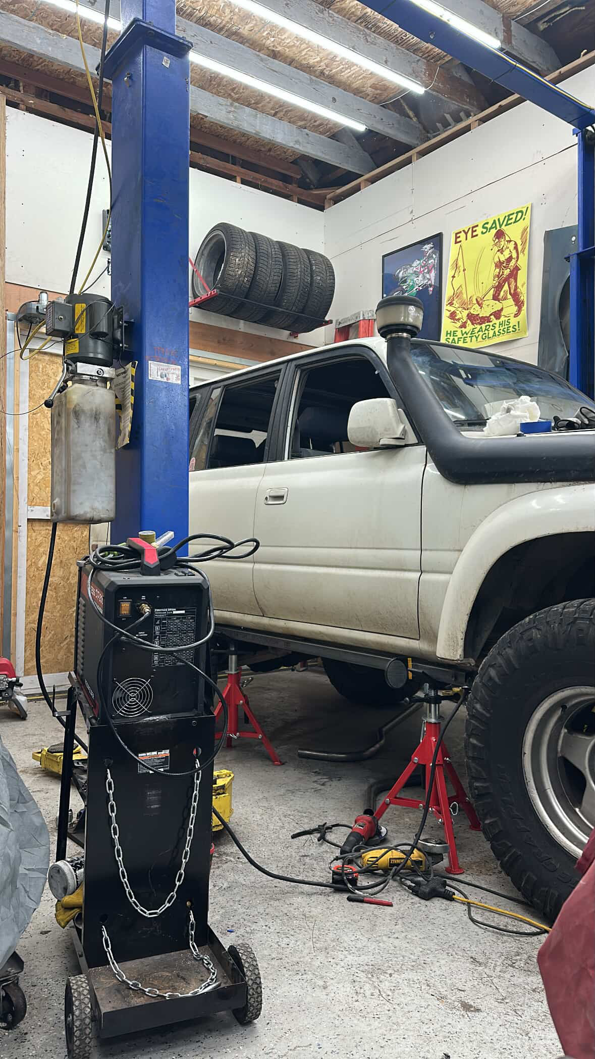

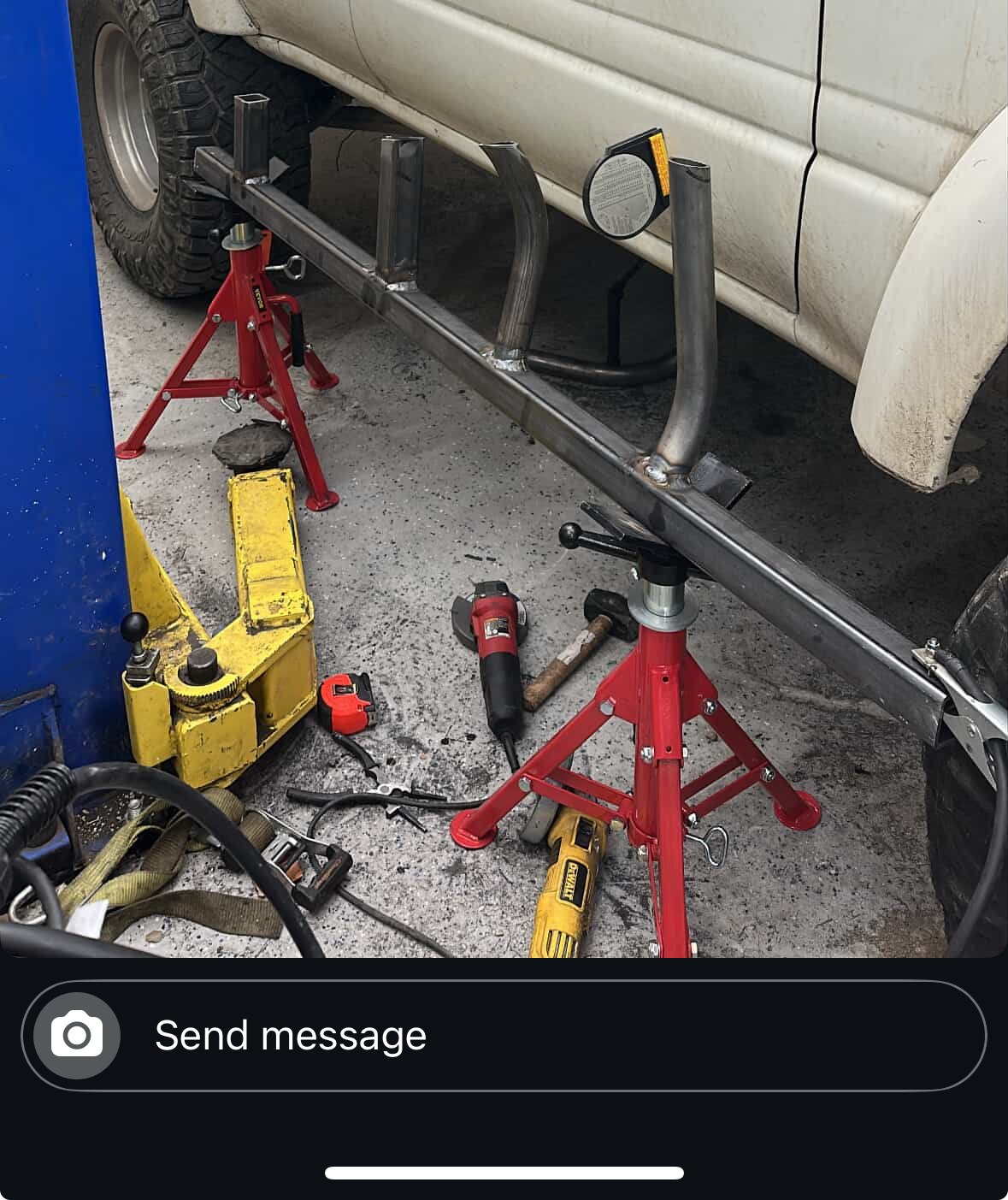

The hard sides coming together! I have to narrow the outside tubes by about an inch to fit the step plates. I’m a little bummed because I’ll probably get into the doors more but I’m stoked because maybe ill finally fit through middle monkey
The dimple die’d step plates are a nice bit of detail.
