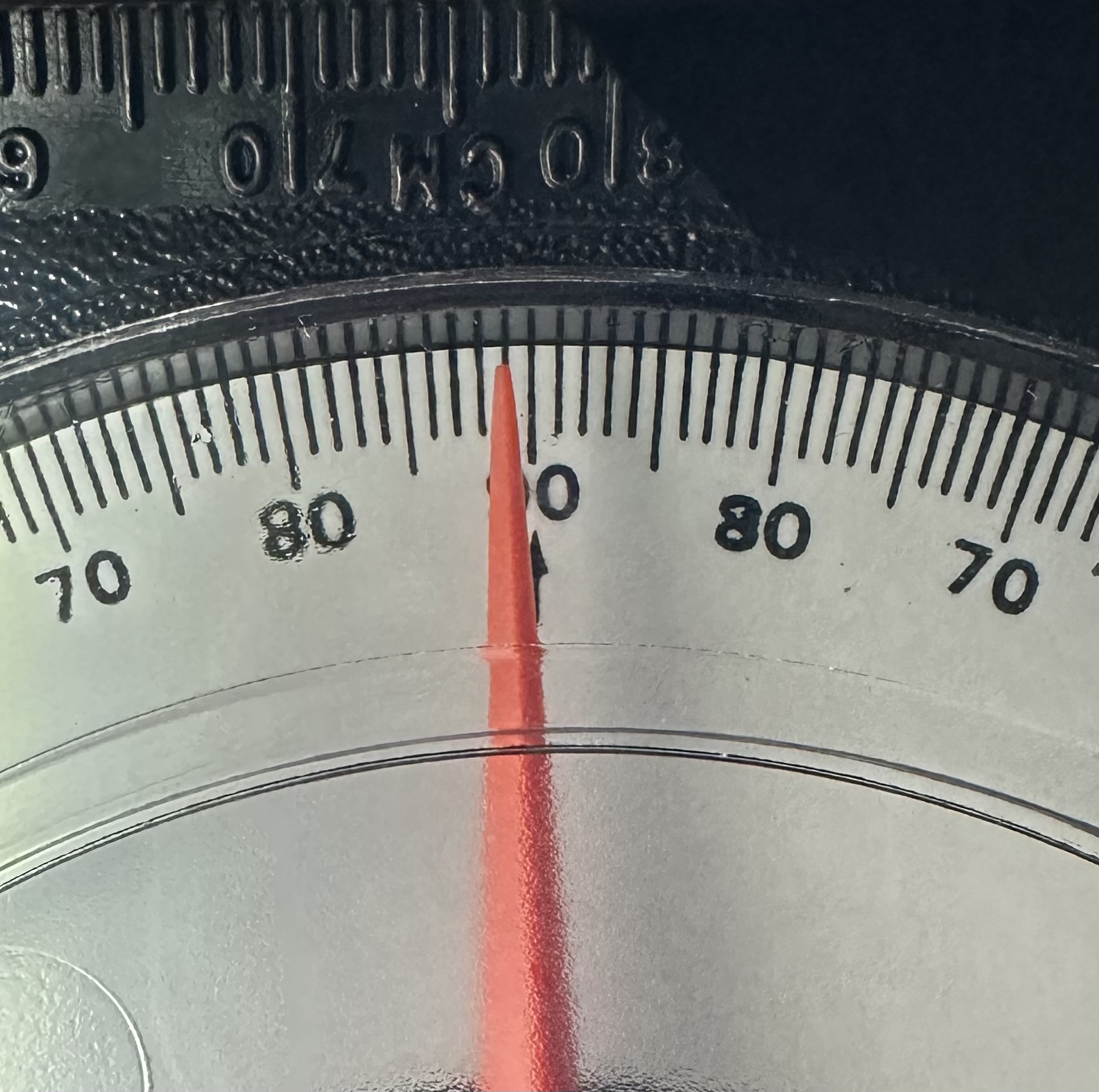

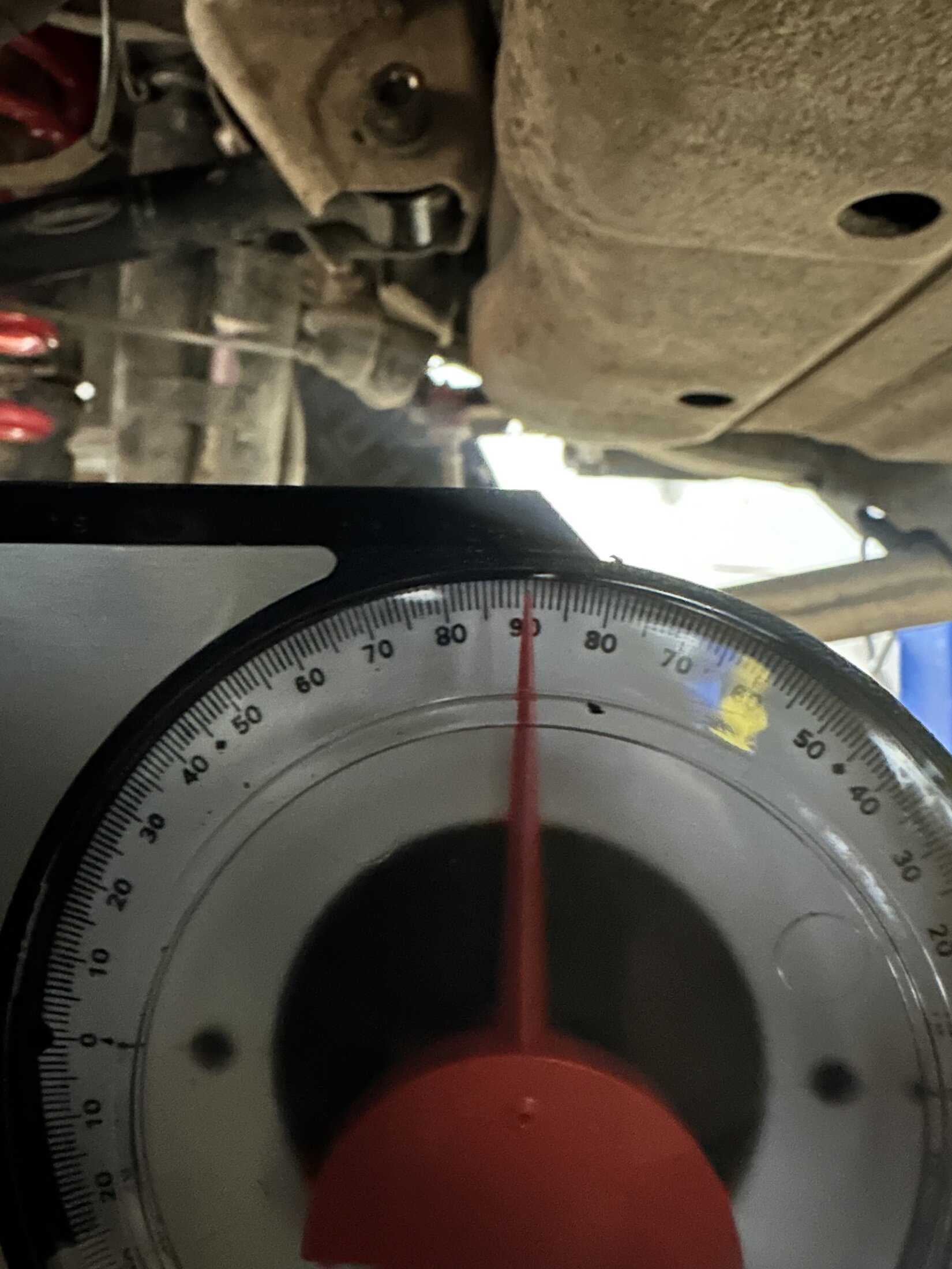

I finally got everything back together and measured the output of the transfercase
And the input of the diff and they’re almost 4 degrees apart. I’m kinda going out on a limb and thinking that’s my issue

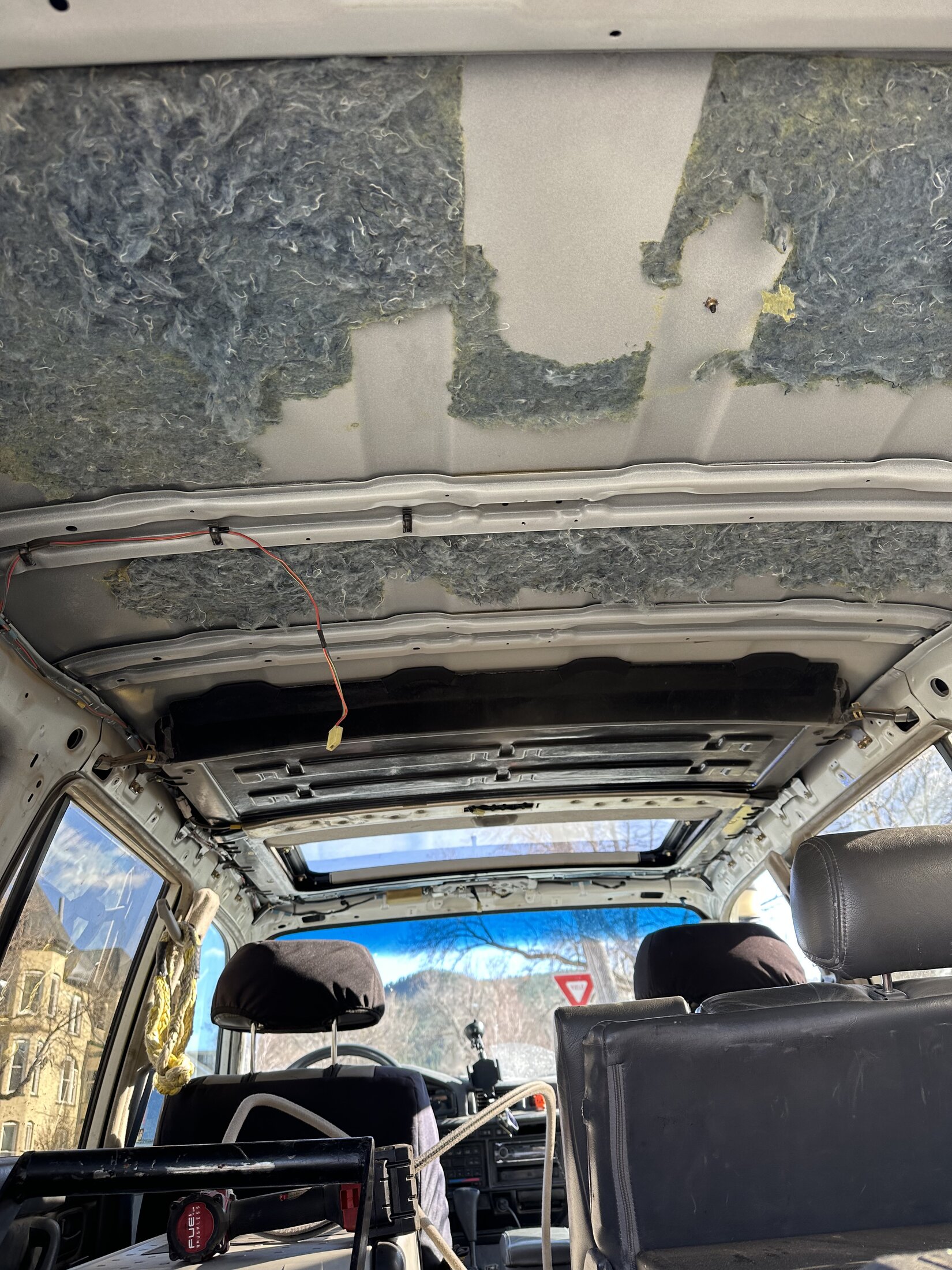

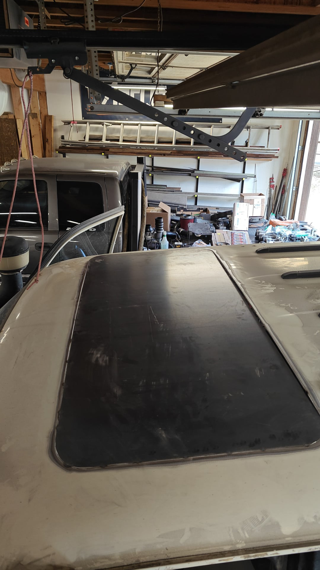

The headliners off and the cars getting sent to a friend is welding in a patch panel for the sunroof. I couldn’t get it to stop rattling and it’s in the way if I ever want to do a cage so it’s going away.
Since the headliners off I added some sound deadener. I accidentally inhaled a wad of the jute when I was scraping it off and I almost puked
I need to do this.
If I can find a shop that will weld in a panel and weld up the roof rack holes.
Looking forward to the finished product. It's gonna be awesome.
I need to do this.
Hopefully it goes well! I have no idea how I’m going to paint this thing and have it blend
