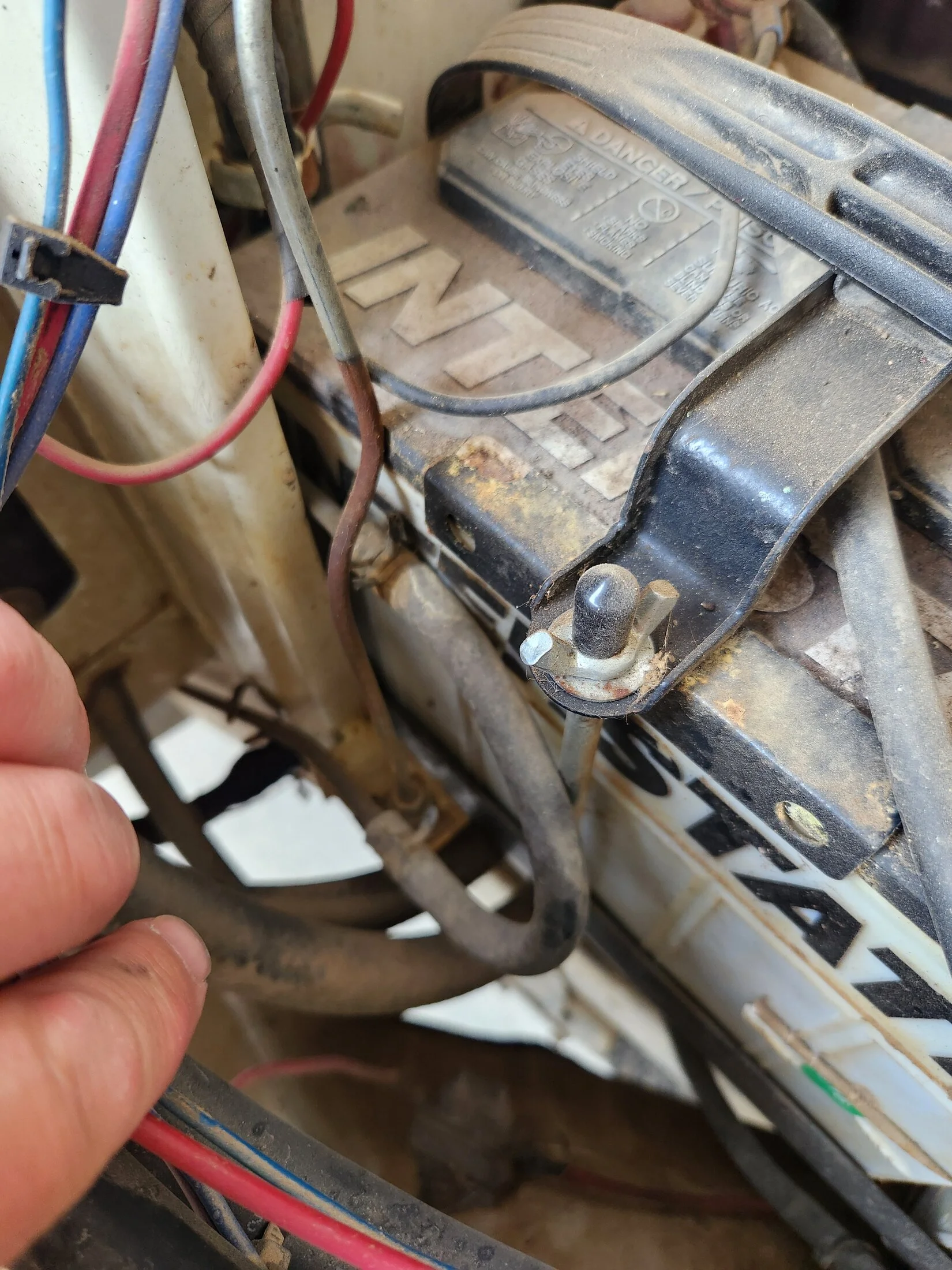

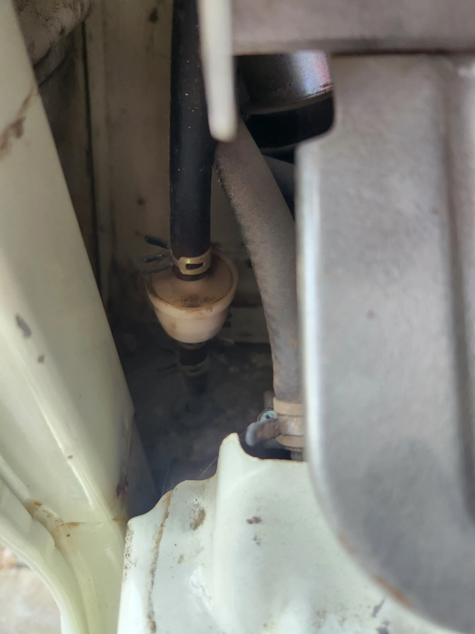

I finally got a few minutes to do a little more digging for this whistle. I do not have a charcoal canister. (Didn't think I did.) It was likely removed when the desmog happened by a PO. There is a small white check valve on the line between the separator and where the line exits the cab headed to the engine bay where the charcoal canister would be. In the engine bay, it looks like whoever did the desmog just put a fuel line in place of the charcoal canister.
I'm thinking I'll just remove that check valve and see if the whistle stops. If so, I'll buy a new check valve.
I removed the check valve and blew through it. Sure enough, it whistles. I guess I will replace the valve. Now, to see if I can buy a new one.
Don't bother. They almost all whistle. You problem is that you've got vacuum from the engine sucking your tank vapors straight through because you don't have the canister and the OVCV (outer vent control valve). That *could* be dangerous in a rollover if the engine is running and gas is getting sucked straight into the cylinders below the throttle valve.
If you're sticking with the CC delete then you'll need to do something. Your tank needs to vent outward. Some have run a loop of hose from the tank vent line up the firewall (engine side) and back down under the car to the rear. Cap it with a fuel filter just to keep dust out. Some people drill straight thru the gas cap to let the tank vent in and out. Best would be getting a CC. Anything else is :hillbilly: and possibly unsafe.
