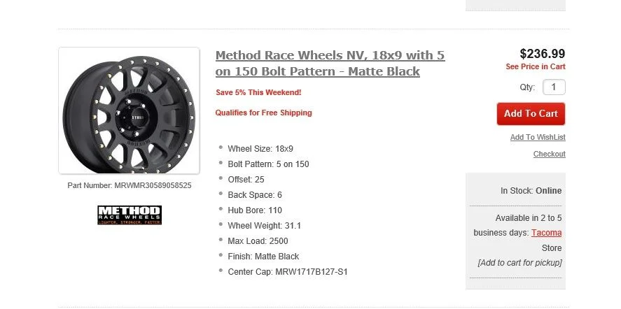

If I ever get new wheels I will get these, 18x9 with a 25mm offset, would proly put them flush with your fenders and allow proper tuck while flexing. And they look great!
wheel-jpg.1385919
Not to be a wet rag, but see where it says "Max Load: 2500?"
FYI, stock wheels with P285/60-18 stock tires, at stock inflation of 33psi, have a Load Limit of 2515 pounds.
Those wheels are not rated for enough load to work on the LC200.
HTH

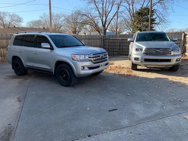

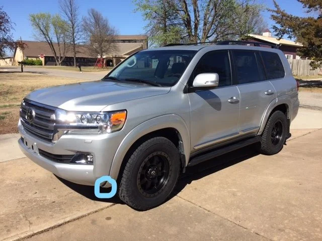

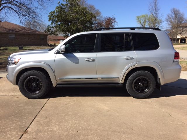

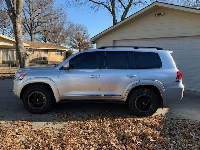

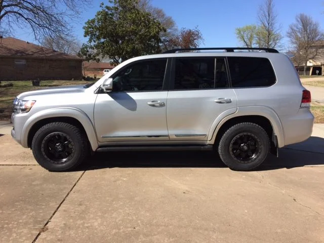

New rims and tires came in today.
Fuel Trophy Rims mat black, with anthasite rings, Toyo open country AT2 tires P285/60/18.
So far the rub that I was concerned with appears to be really pretty minor, there is just a little bit right where I was expecting it, left front mud flap when wheels are turned hard left.
Here a few pics, it's late just finished putting them on a taking a quick spin. I will take some better pic's out in the sunlight tomorrow.

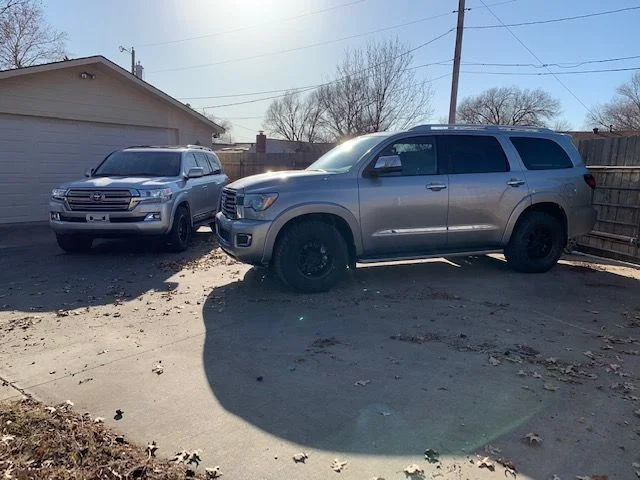

looks great! I run 285 65r18 on method +25mm offset. You will be fine.
Thanks. I sold my 2011 to some close friends last year.
I have my 2018 setup just like it only in Silver.
They fit and look good on there imo.

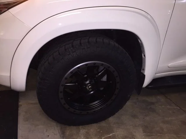

However there is a slight difference in shape of the front and rear facias between 07-11 and 2016-2021, the rear worked out fine, the font ended up needing a little extra rubber backing/gasket material added to seal them up at the very bottom right at the base of the front facia.
The only place that poses really any issue is way down low on that front facia. The 07-11 was a little more rounded then the 16-21 MYs.
You can't see in nor would you know about, if I didn't point it out, you can see just a tiny spot where there is rubber gasket material barley visible and you have to bend down and look for it to see that .
