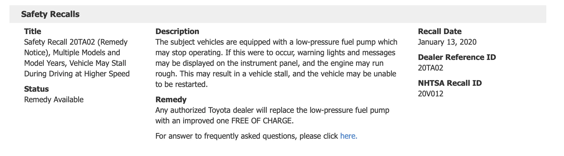

Fuel pump recall
I was contacted by Lexus dealer today, have appointment on Friday to get it done.
Apparently 2018-2019 LC are also affected.

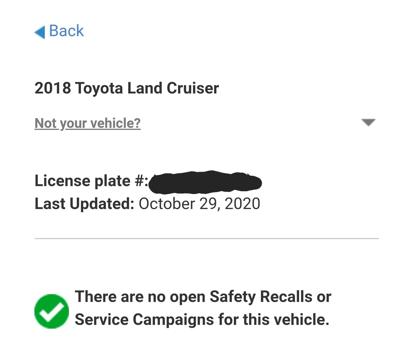

... Although my 2018 LC doesn't show up as having a recall on the Toyota site (yet)

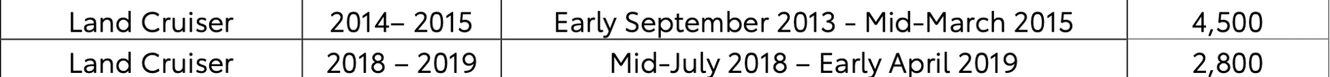

@elkeye Thanks for looking up the Toyota official info.
Interesting, the "Mid-July 2018" start date for affected LCs coincides with the same time the LC received the updated radiator and capacitive touch screen. Apparently the fuel pump was also updated at the same time. I wonder what else changed at the same time.
My LC is from Feb 2018, so this recall doesn't apply to me after all. But I'll still have to swap out my radiator to the new design at some point.

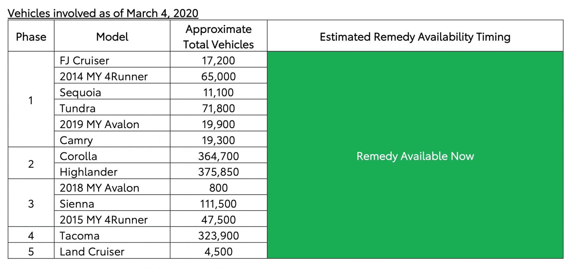

My 2019 is included in the recall. Dealer can’t even order the parts as they’re not available from Toyota.
Same here with my ‘19. I’m worried the dealer will screw something up. It’s not like they work on a lot of LCs
