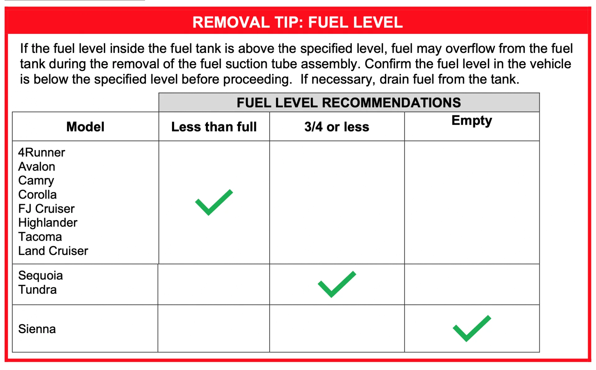

I just had my fuel pump replaced under the recall on my 2014 and everything went very smooth. I called a week in advanced and they advised that the had to order the part and scheduled an appointment. I dropped off my Cruiser at 8am and they called me at 3pm to tell me it was all finished. FYI, I ran my truck down to 30 miles below the "low fuel" warning before I dropped it off. They told me it had to be less than a quarter tank or they wouldn't perform the work. It's always nice to have service completed by the Toyota dealership and not have to pay for anything.

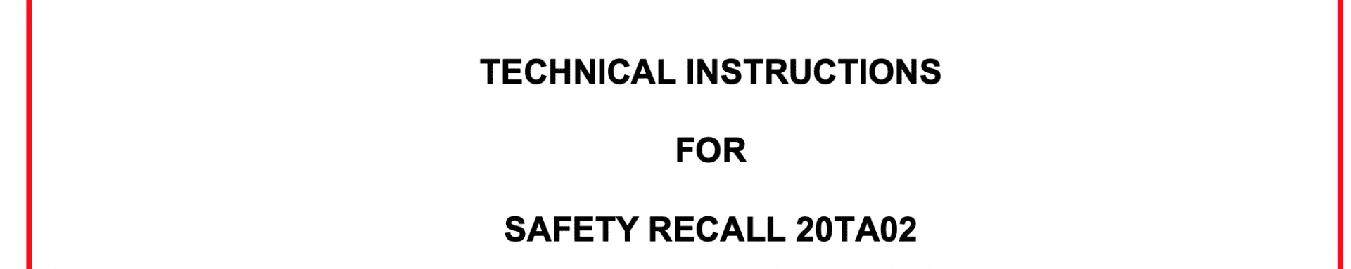

Interesting since the 'Technical Instructions' for Safety Recall (20TA02) indicates that the Land Cruiser fuel tank just has to be 'less than full'.
If not 'less than full', the dealership could drain fuel from the tank to avoid overflow from the fuel tank during the removal of the fuel suction assembly.
https://static.nhtsa.gov/odi/rcl/2020/RCRIT-20V012-5271.pdf
The gas tank on my 2015 was 7/8 full when I took it in because of reading this I knew it didn’t have to be anything but less than full they agreed did the work no problem.
