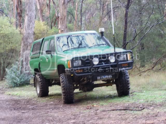

Yesterday afternoon I got to see and hear matt.mcinnes' new Boat Anchor, and this morning he took Photographs of my Car. :)
Which vehicle is this on? Any pics?
Dan
1985 Hilux LN65
