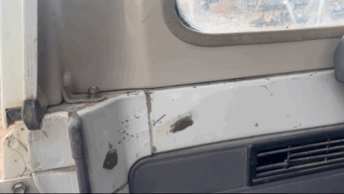

I’ve got both of those off. The bolt in my last post is further back and under the FRP. Thanks for the picture to confirm on my side.
Here’s underneath the back on mine.
That splatter is actually cavity wax, not a murder scene inside the body.
will look for splatter evidence on my truck as well … thx for the pic will compare cavities when I’m back inside the vehicle

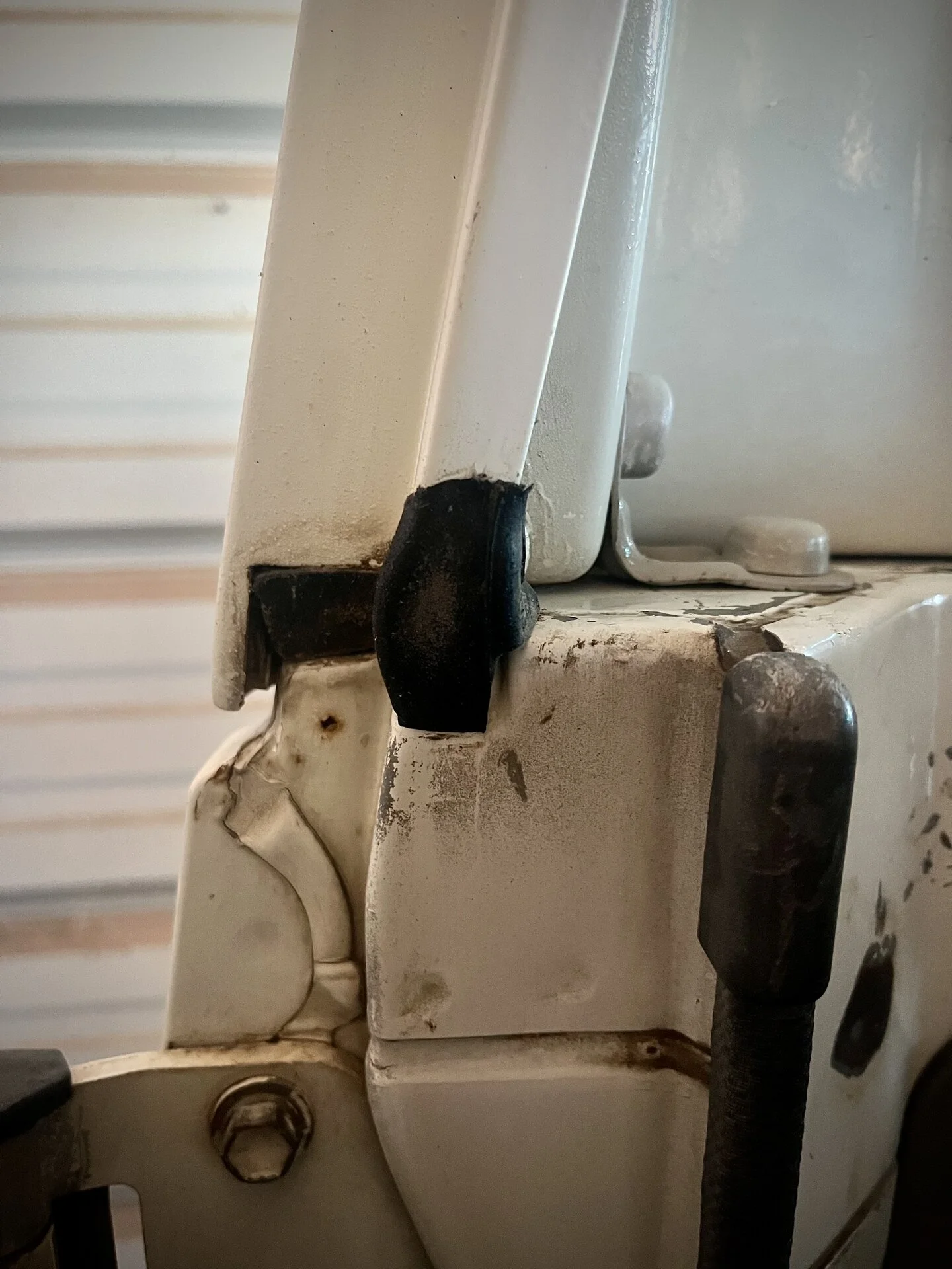

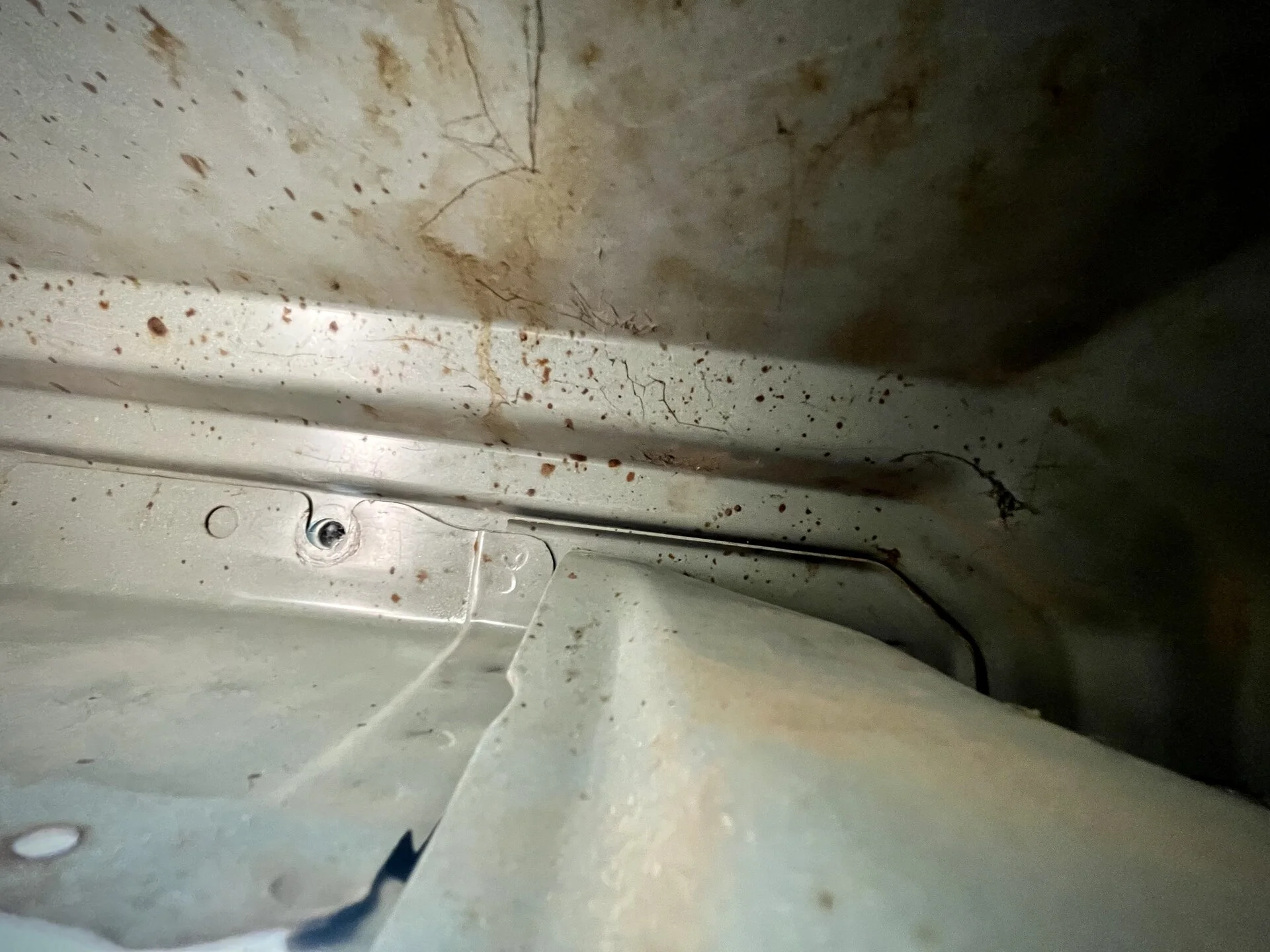

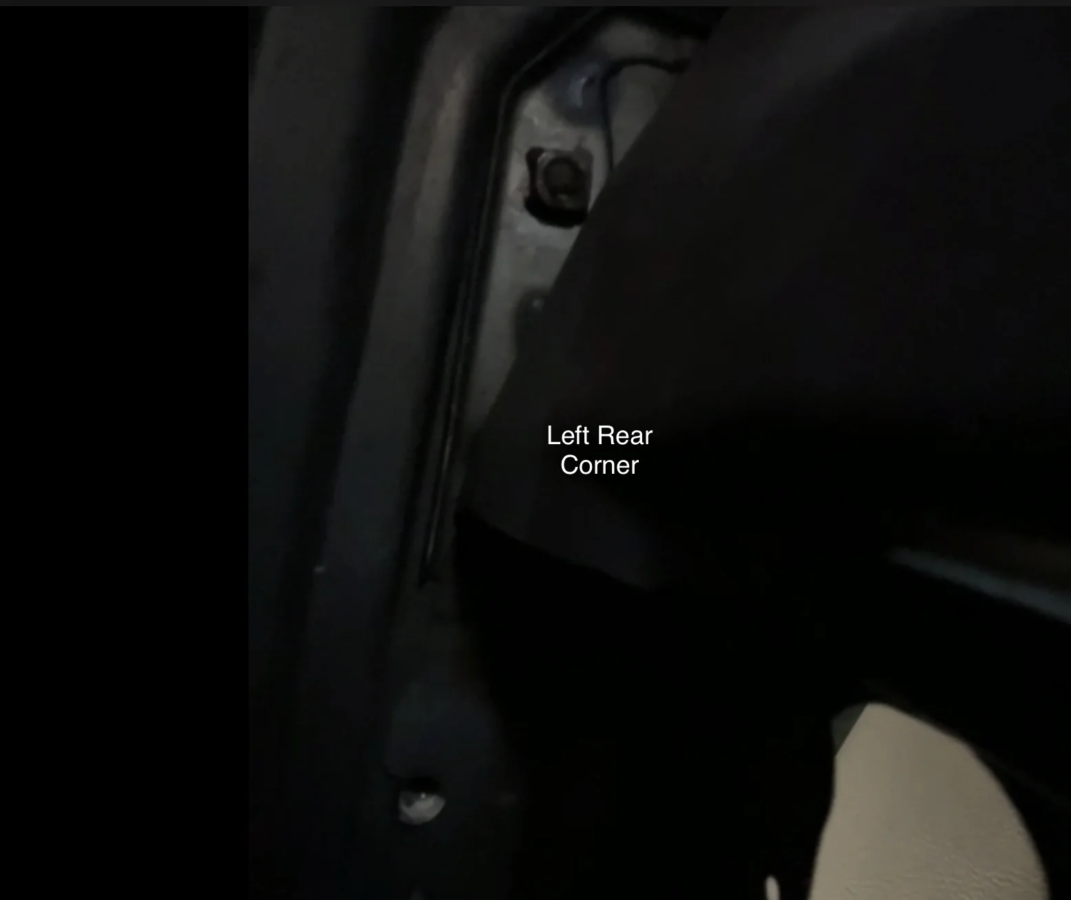

@JuanJ I think that I’ve located one bolt on each “rear square” … is this the location you call the “rear square” it is located so close to an interior structural part/panel, that I can not get a socket w/an extension on to it.
Also per my earlier post (from today’s effort) … after removing 3 bolts from the frame (to reach the fasteners and bolts you noted) that are located above the front door … this part may have a bolt attachment located under the FRP Top, since it’s not coming off either.

By "square" I meant the square on the inside. I should have said inner corner. My mistake.
There are two bolts on each corner, which I understand you have removed already.

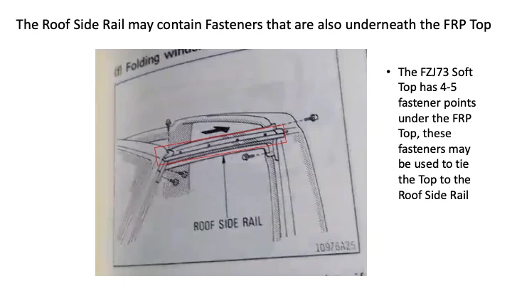

I just discovered that Colombia spec FZJ73s have a distinctive feature, namely a rail with five bolts that holds the soft top in place, in order to prevent theft. These bolts are in almost the same place as the Japanese FRP top ones. On each side, there is one bolt close to the roll bar, unlike the Japanese top.
Then there is the bolt you cannot reach in the rear corners. And one bolt on the interior of the upper front door arches. I understand you have removed these bolts and the ones over the windshield frame.
I would try to loosen the hard-to-reach bolts in the rear corners. If these come out, I would try to remove the roll bar bolts to see if the top comes out. If this does not work, I would leave the top alone.
Juan
@JuanJ I got a few minutes to explore some of the details from your reply. Assuming that I have a Soft Top assembled from the CKD kit … “There are five fasteners in the frames above the front doors, as well as two or four bolts”. To access these, I need to remove this frame cover piece (which looks to be connected with 3 bolts) … does that make sense?
View attachment 3500753View attachment 3500755
Hello,
The fasteners should be on the other side of the frame in the last picture, together with one bolt. I am not sure it is possible to access these from the inside.
It might be posible to remove the roll bar bolts and then the top, provided you can loosen the bolts on the rear corners. Otherwise, it is better to leave the top where it is.
These tops are fragile and trying to get them out is not worth the risk of cracking/breaking them.

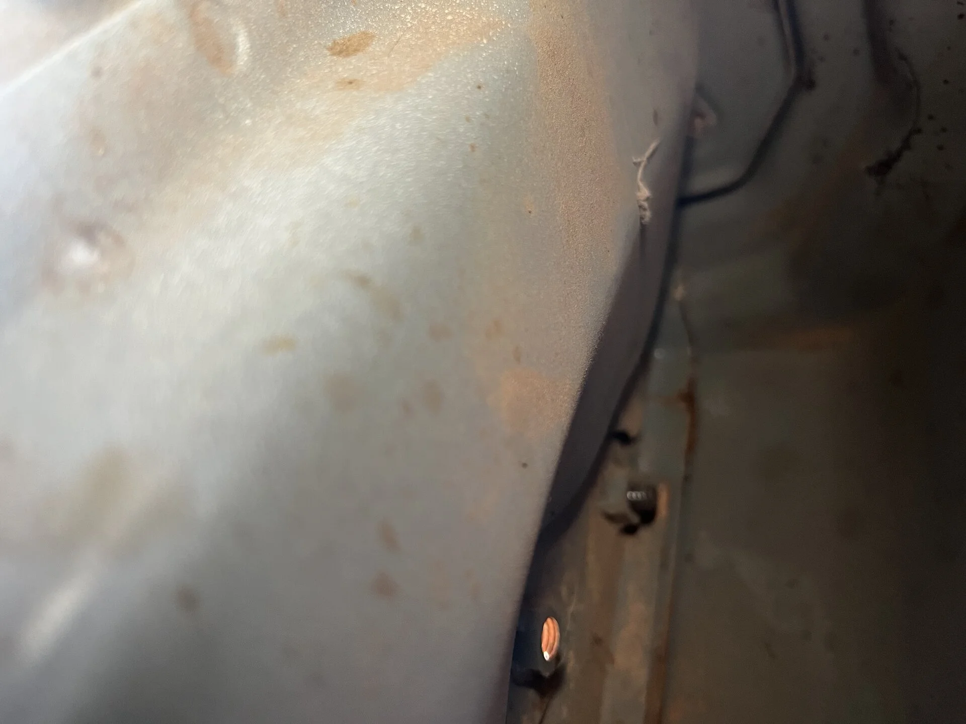

Inspecting the areas in the Left and Right Rear corners and the Channel above the Roll Bar … no FRP Top bolting points … or splatter evidence ;-) ... Must be still tightly secured at the window frame using “hiden under the FRP top” bolts or fasteners as noted.

2-There may be hidden connection points to Roll Bar and Window Frame which are underneath the FRP Top and not easily accessable for removal (with the Top on).

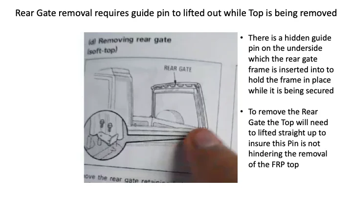

3-To remove the Rear Gate the FRP Top will need to lifted straight up to insure this Pin is not deterring the removal of the FRP top.

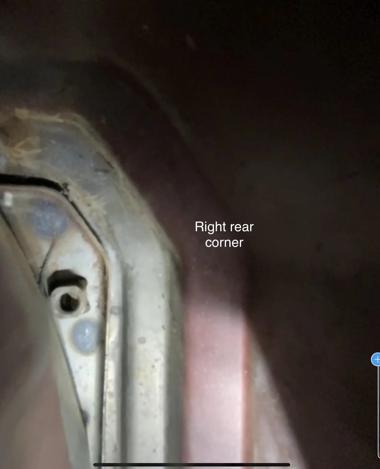

4-There is a hard to reach bolt in the Rear Corner. This bolt may be holding a side structural member or the RFP Top on.

I have my regular FRP top and a Europe model high top and neither of them have a provision in the rear corner for a bolt It’s possible the South American top does, but I’d be very surprised if it did given how hard it is to get to.
