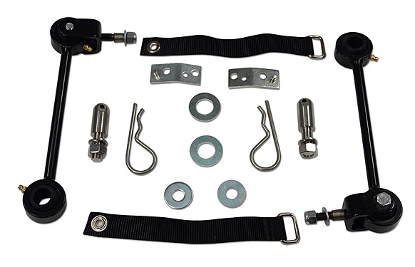

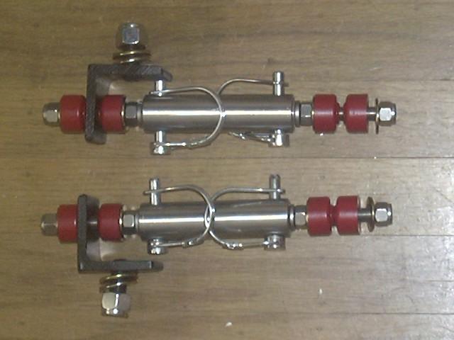

I am still trying to figure out how this is possible. I know from experience that the retaining hoop on the pin shown in Phil's middle "installed" photo above takes quite a bit of force to flip it open. The bar would have to be loose on the other side (which would require the cotter pin to fall out or be pulled out of the clevis pin) AND the bar would have to make significant contact with something that forces the bar sideways in order to unlatch the hoop.
I am not saying that scenario is impossible but I would have to believe there would be marks on the offending suspension parts. You stated "weak cotter pin" in an earlier comment. Are you saying the pin didn't feel like it engaged the clevis pin strongly enough? Or are you suggesting the part shipped was defective?
Steve, sorry I was not clear- it looked like both pins had popped and the bar had swung down. There was rattling that I misspoke for my already rattling exhaust pipe. I would not call it a defect but rather caution to use a pin that can be secured better.
Regardless, my point was to help the uninitiated and be up front in the cautionary statements. For example, saying “cycle your suspension” means something to those who have experience with the suspension. But to others, they may not understand that phrase. The tab issue mentioned above is an issue, and I did have them replaced- but after I experienced the mishap.
To be clear, the option of a sway bar disconnect is cool. It is the reason I bought the kit. It is the caveats that require explaining to minimize the issues highlighted in this thread.
Now, if dealing with newbies is too burdensome, then don’t explain anything and cross your fingers hoping no one has a serious mishap. I acknowledge it is difficult sometimes to explain something that is obvious to someone experienced. But this community is full of people with a wide range of experience.
Can you include a photo of how the pins were installed? How do you think they “popped?”

The pins were placed exactly as shown in Phil’s pictures. If you install this product, consider using something different for an extra layer of insurance.

If you were a rally driver then Im surprised you questions the type of fasteners use. I was also involved in off racing for several years and these type of fasteners are used frequently where a LOT is at stake without issue. I will tell I have seen these fastener hold up to 1000's of BAJA much more than any washboard road you have driven in your 80 or rally car.

A couple examples on what other manufacture use as fasteners to secure swaybar disconnects.
