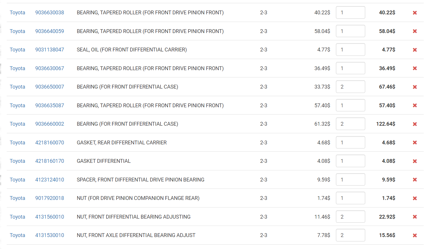

I've looked around quite a bit and see a lot of threads with bits and pieces for the suggested parts list for a front and rear rebuild. I have amassed the selection of parts outlined below in my Partsouq cart. Does this look like everything I need?
Am I missing something or should I just call Kurt
@cruiseroutfit to the rescue and just buy a kit from them? The purist in me wants to use all Toyota OEM parts! I am planning out a 4.88 upgrade and want to knock out all the "while you're in there" stuff.

Thoughts?

I think this is a more organized list. Is there anything I am missing?
1997 E-LOCKER REAR AXLE Part # QTY Description 42181-60070 1 GASKET, REAR DIFFERENTIAL CARRIER 41231-60030 1 SPACER, REAR DIFFERENTIAL DRIVE PINION BEARING 90366-40059 1 BEARING (FOR REAR DRIVE PINION REAR) 90366-30038 1 BEARING (FOR REAR DRIVE PINION FRONT) 41204-60050 1 FLANGE SUB-ASSY, REAR DRIVE PINION COMPANION, REAR 90311-38047 1 SEAL, OIL (FOR REAR DIFFERENTIAL CARRIER) 41214-26010 1 SLINGER, REAR DIFFERENTIAL DRIVE PINION OIL 90179-22011 1 NUT (FOR REAR DRIVE PINION) 90201-22007 1 WASHER, PLATE (FOR REAR DRIVE PINION) 90366-60002 2 BEARING(FOR REAR DIFFERENTIAL CASE) 1997 E-LOCKER FRONT AXLE Part # QTY Description 42181-60080 1 GASKET, FRONT AXLE DIFFERENTIAL CARRIER 90179-20018 1 NUT (FOR FRONT DRIVE PINION COMPANION FLANGE FRONT) 41204-35080 1 FLANGE SUB-ASSY, FRONT DRIVE PINION COMPANION, FRONT 90311-38047 1 SEAL, OIL (FOR FRONT DIFFERENTIAL CARRIER) 90366-30067 1 BEARING, TAPERED ROLLER (FOR FRONT DRIVE PINION REAR) 90366-35087 1 BEARING, TAPERED ROLLER (FOR FRONT DRIVE PINION FRONT) 41231-24010 1 SPACER, FRONT DIFFERENTIAL DRIVE PINION BEARING 41115-35010 1 RING, FRONT DIFFERENTIAL OIL STORAGE 90366-50007 2 BEARING(FOR FRONT DIFFERENTIAL CASE) 41315-35020 2 NUT, FRONT DIFFERENTIAL BEARING ADJUSTING
