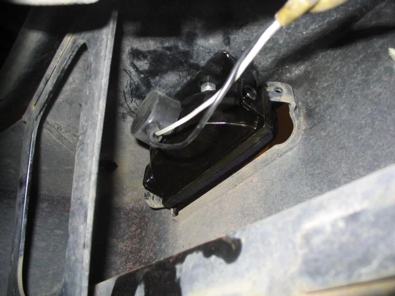

In the pics below:
1. US driver's side, behind bumper. You can see fog light bracket and ARB mounting tabs bent out of the way so they don't interfere with fog light mounting and adjustment.
2. You can see fog light recessed for protection.
3. Fog light centered in hole. Slightly smaller, so good ventilation is allowed - lights get HOT. Lamp fixture dimensions: 4-5/8"W, 1-3/4"H & 3-1/4" D.

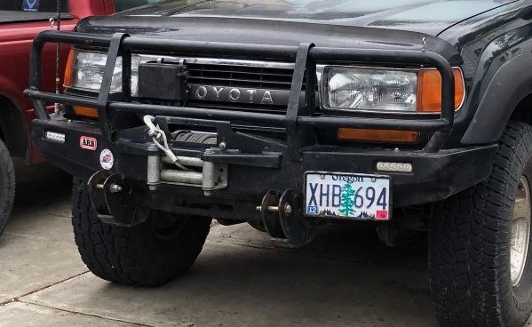

In the mod that this thread attempts to accomplish, there are 2 different circuits involved. 1. turn signals (blinkers) and 2. parking lights (clearance lights). Originally, the corner parking light had a single circuit socket in it, so it was not used for turn signals, just parking. But being on the corner, it is visible from the side as well as the front, so my intent with this mod was to change the socket to 2 circuit capability and make it dual duty - parking and turn signals. I think the ARB indicators are intended to be wired into the turn signal circuit. I eliminated my ARB indicators after doing this mod because the corner lights do a better job for both turn signals and parking, IMHO. I've got mini LED light bars mounted in the bumper (that were for the ARB indicators) for aux front lights. They're well protected in the bumper and work well for added illumination on the sides of the trail or road due to the bumper angle.

LED’s look great. I’ve just got led replacements for the ARB ones, which I’ll be upgrading to Parker / blinkers after the corner mod. In Aus we aren’t allowed amber park lights except for on heavy rigid vehicles or trucks. Hence relocation of marker / signals as LED’s to the bumper, and turn signals to the corners. Here’s what the AU GXL came with.
Excuse how filthy she is lol
