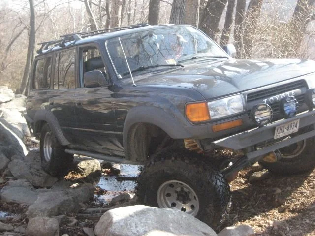

I can get my front to flex pretty well with just the swaybar removed
I tried the removing the control arm bolt thing it flexed a little better but not enough for me to want to do it all the time
I run 10 inch shocks front and 12 inch in the rear
Not bad... could be better.
