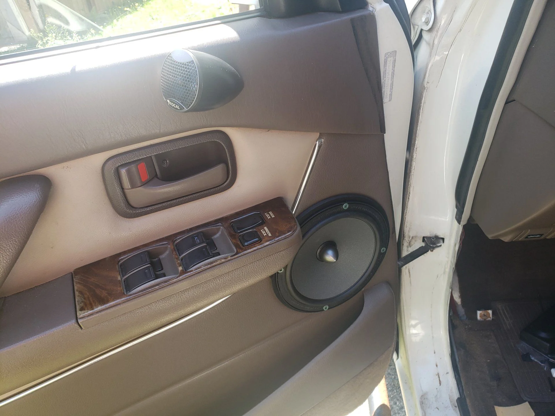

Any ideas on replacement speakers for the front doors? I understand the depth issue and don't want to build out the spacer if I can help it. Thanks
Great question!

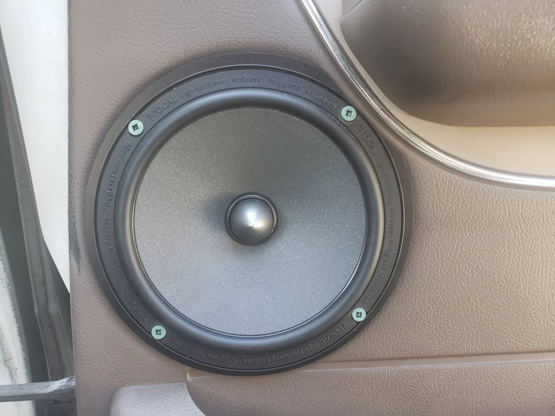

I used Focal Integration 6-3/4" components. I mounted the tweeters high on the door but close enough to the drivers to not cause any issues IMO.
I'm running them in a 3-way active system (no rear door speakers) and they sound amazing. They do like power, at least 50W, so I wouldn't run them on deck power.
I made 6mm PVC spacers for clearance.
