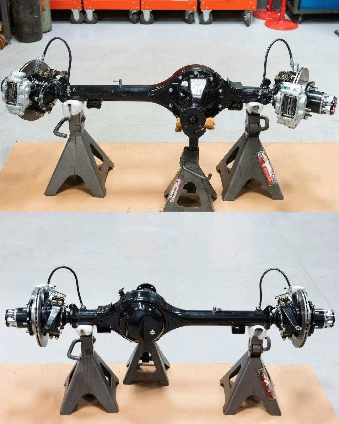

agreed with @pb4ugo contact Cruiser Outfitters or Valley Hybrids or Classic Cruisers and they can get you a disc brake setup that is all Toyota. All three of these shops have a longstanding reputation for helping customers source these upgrades. They will also be able to answer your clearance questions.
We can absolutely help @ Cruiser Outfitters. We have complete conversion kits avail with new parts. Or, we can help you piece together the parts.
Lots of info on the swap here:
