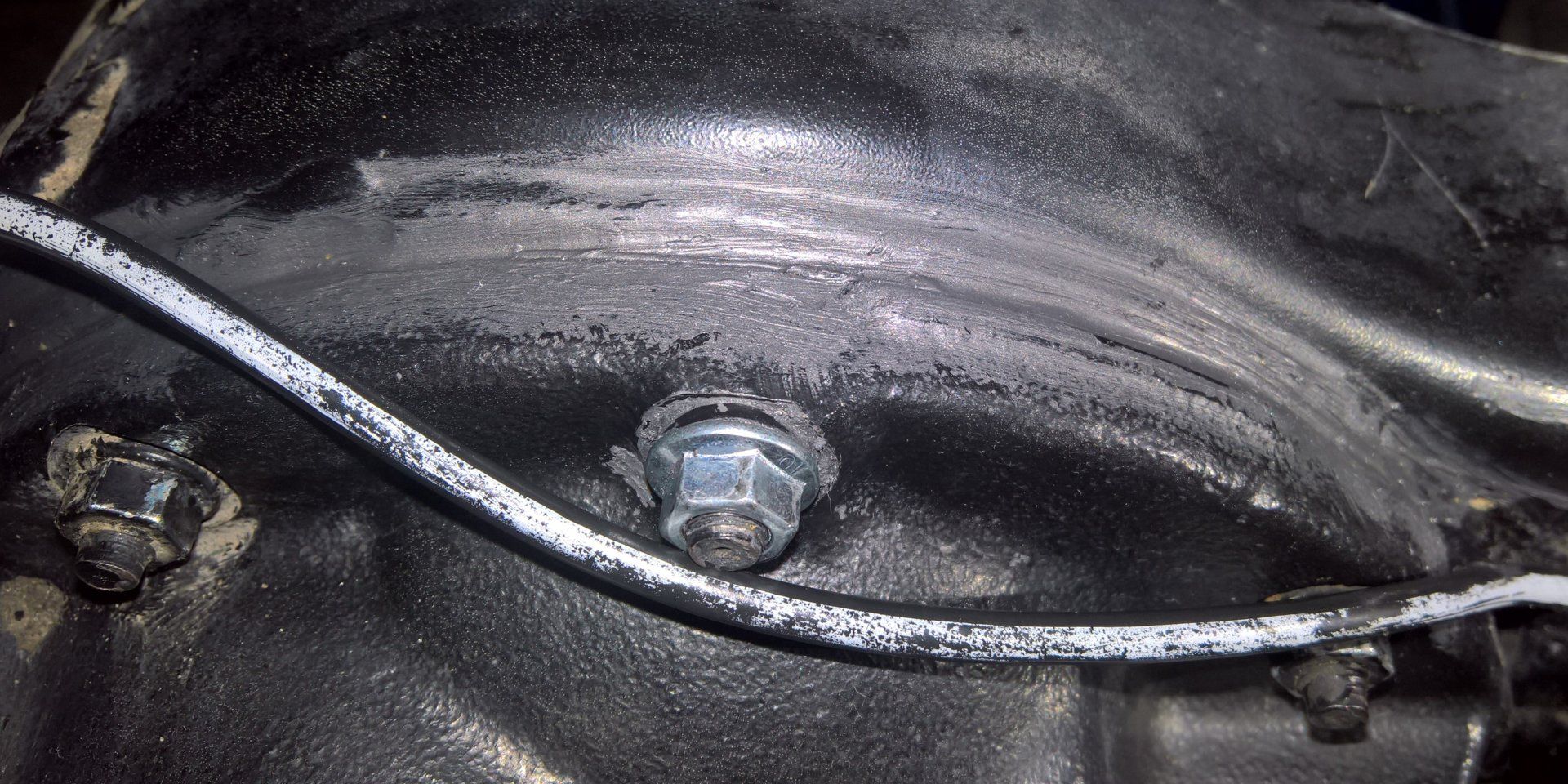

I've been running the stud kit with just a gasket without issues so far. When in MOAB that year and developing the leak I just tightenend down the nuts and it seemed OK but the gasket had shifted and torn so I pulled the diff when I got home.
But if the gasket is still in tact which means it hasn't moved out of place and possibly torn, I'd get a stud kit and follow the instructions for replacing them with the diff in place. I'm optomistic it will stop the nuts from loosening and eliminate the leak without the need to remove the diff.
I did not see it the first time I looked. But in post 1 & 20 you can see that the Gasket is spitting out. No amount on Tightening will fix that. JMHO
Time to pull the third and fix it right. :(
yup, need to tear down the axle. The fasteners have failed and the diff has been shifting around and pushed the gasket out of place. I chose not to use FIPG on the last repair because it didn't really help the previous time I did it. I believe it's solely a fastener problem and the M8 class 8 hardware isn't up to the task.

Update: I couldn't see the top of the diff from under the vehicle
on my back in the driveway when I first just tried to tighten the nuts, so jacked up the vehicle yesterday, placed a jack stand under the right frame rail, then pulled the right front wheel and approached the front diff from there..
Once I got a closer look (and rechecked my own photos) it was apparent
that the gasket had pushed out along the top edge of the carrier flange.
I snapped off the gasket that had poked up, then cleaned up the area around the flange using some CRC electrical cleaner spray (doesn't seem to damage paint as much as Carb cleaner, no acetone?). Also removed the nut of the top right stud and cleaned the stud threads and around the base of stud well.
Then stuffed some Ultra Black FIPG (what I had on hand) into the seam where the gasket was missing (flange-axle housing) and then around the base of the stud, then replaced the lock washer and a flanged nut, torqued it down to 20 ft lbs and let it sit overnight for the FIPG cure.
Also tightened all the nuts again, this time with a torque wrench, to 20 ft lbs and maybe half of them moved a tiny bit (in hindsight maybe could have removed the nuts and applied Insensitive Blue thread locker to the studs, then retorqued, maybe bought me more time??).
Figuring this is a stop gap, might be able to delay the repair awhile before I have to do the whole front axle service (FAS) to pull the diff. Last time the FAS was done is unknown (one side may have been done about 5 years ago? by the PO) so had to do that anyways.

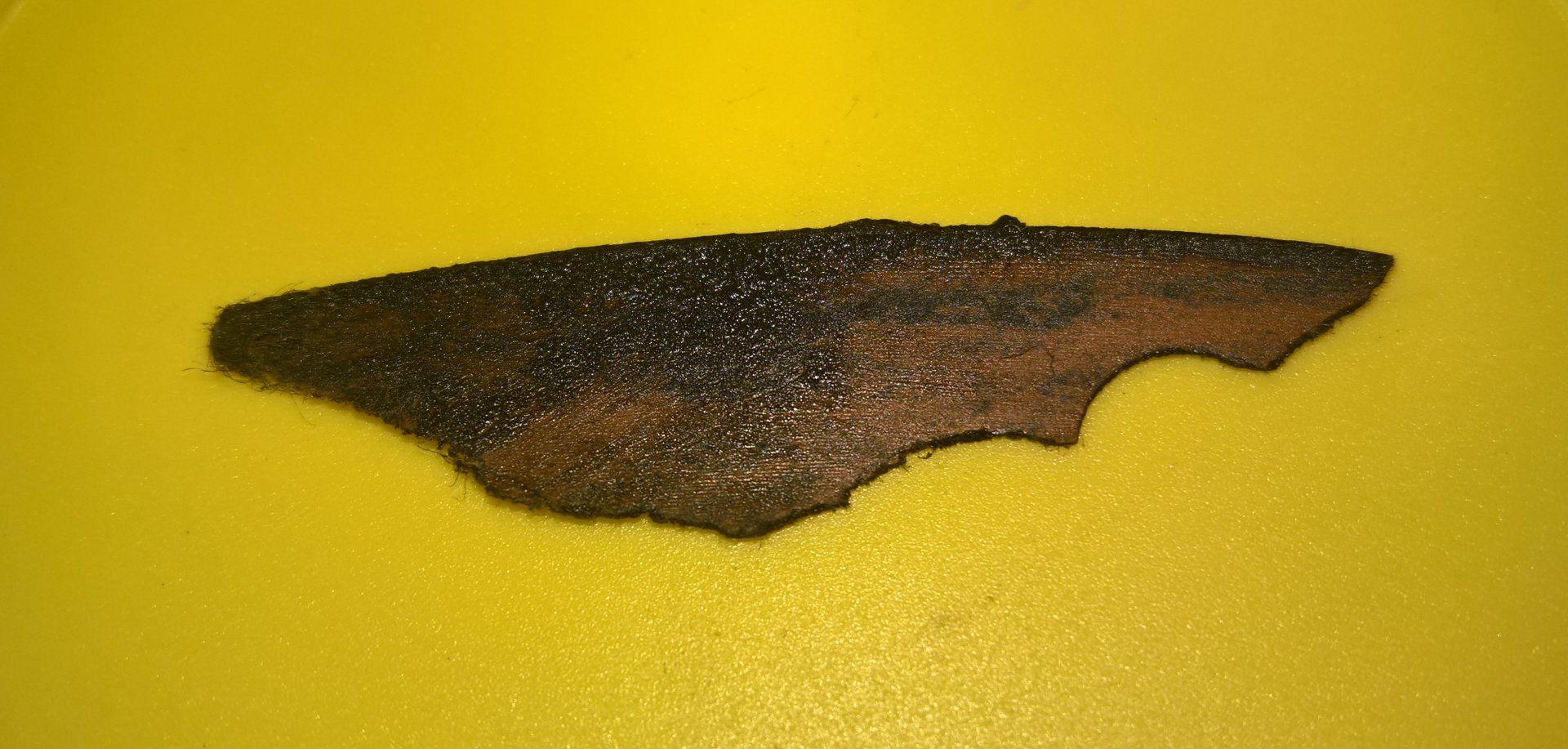

Here's some photos: Top photo is the piece of gasket that got pushed
out, note the partial hole far right for a top stud. Bottom photo shows the FIPG stuffed in the seam between the flange and housing and around the stud before tightening down the nut (moved the ABS line out of the way just for the photo).

1. I've never seen a post of a leaking factory gasket that didn't have loose nuts holding the diff in place.
2. Using FIPG or similar when properly prepped will adhere to both surfaces.
Using FIPG is actually helping to hold the diff in place and acting like glue and in my opinion making up for the hardware.
